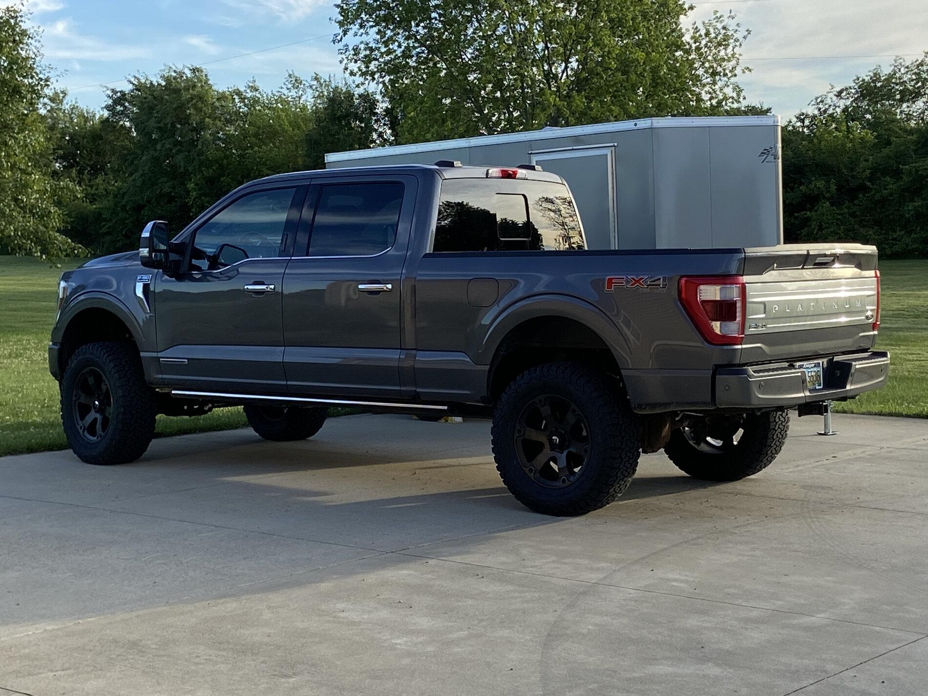

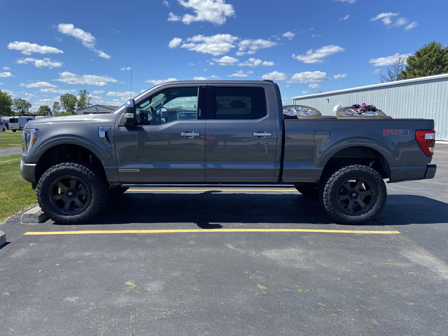

how does that size tire look? Where did your mileage go ? I think my tires look too small so I am considering the same. What tire did you get, can you post a picture? Thanks
Here are a couple pics. Mileage took a bit of a hit, but my lead foot doesn’t help. I lost about 3mpg, still get some hybrid miles on electric maybe not quite as much but still gets some benefit from that.
WOW that looks nice, did you put a lift on it too? Will that front tire rub when its flexed? It looks pretty close but could be just the pic angle. Thanks
It is a 6” BDS lift as well. Yeah when loaded down and flexed I do get a small rub on plastic, not enough that I plan to bother with. I’ve only had it happen one time with a heavy load when off road. I think if I would have went with the coil overs up front it would likely not, but I went with the lift that used the stock shocks (for now)
