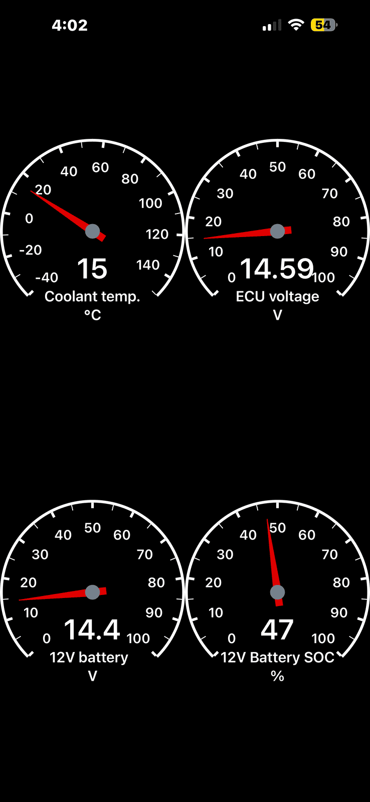

So, I fired up FORScan in Easy Mode to see if the BCM module for my truck had a 12V battery target state of charge %. It does!
Ford F-150 Lightning Starting to get LVB 12v warnings... 20240723 FORScan Battery Target Charge_Edt
To use FORScan in Easy Mode, besides the program and the right connectivity tool, you need an EXTENDED license ($12 for one year).
How to use Easy Mode is described in the following popular YouTube video: The guy who did this video is certainly at least a Libertarian! At the end, he shares a beer with an under-age-18 (non-human)! 😀
So, the paradox is that if certain updates require an LVB % SOC > 80% to go into Inhibit Mode, how can the truck reach that in everyday driving if there is an LVB target % SOC of only 80%?! Makes me think that that setting in the BCM module must be vestigial.
I have also previously reported the paradox that using either one of two trickle chargers (1.5A Deltran Battery Tender Plus or 2A Noco Genius2) on either the jump points or the battery terminals (the negative distal to the BMS sensor), I couldn't charge above 80% although I could easily charge above 90% running my truck in full-accessory mode when plugged into my FCSP. Perhaps this was due to some parasitic drain I'd overlooked and has nothing to do with the putative 80% LVB SOC target limit. https://www.f150lightningforum.com/...old-while-plugged-in.17980/page-2#post-361728
A cursory search didn't turn up anything about the Battery Target State of Charge % on the Lightning forum. Answers, anyone?

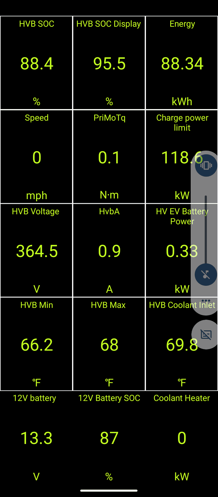

I haven't seen anyone post about the target being 80%, I have seen mine go well into the 90's and as high as 99%
Looked at my account dashboard this morning, the truck has not run since 2 pm yesterday, and I didn't play with Fordpass at all since then, this is the last reported LVB SOC at 90%
Ford F-150 Lightning Starting to get LVB 12v warnings... 1721821242926-y5
Then I woke her up with a lock/unlock command and now it's only dropped to 87%
Ford F-150 Lightning Starting to get LVB 12v warnings... 1721821313407-06
