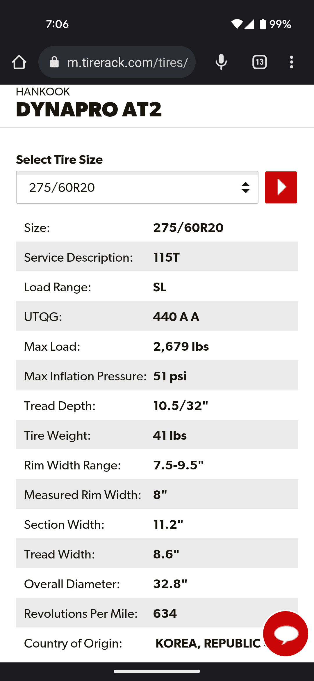

Here's the stock AT tire option (the Hankook Dynapro AT2) and the upgrade I'm looking at. Given these specs are nearly identical, should be a one for one swap in terms of being consistent with OEM specs? Both 115T and SL.
Ford F-150 Lightning Stock tires - AS XL vs AT SL??? Screenshot_20220914-070620
Ford F-150 Lightning Stock tires - AS XL vs AT SL??? Screenshot_20220914-070629
