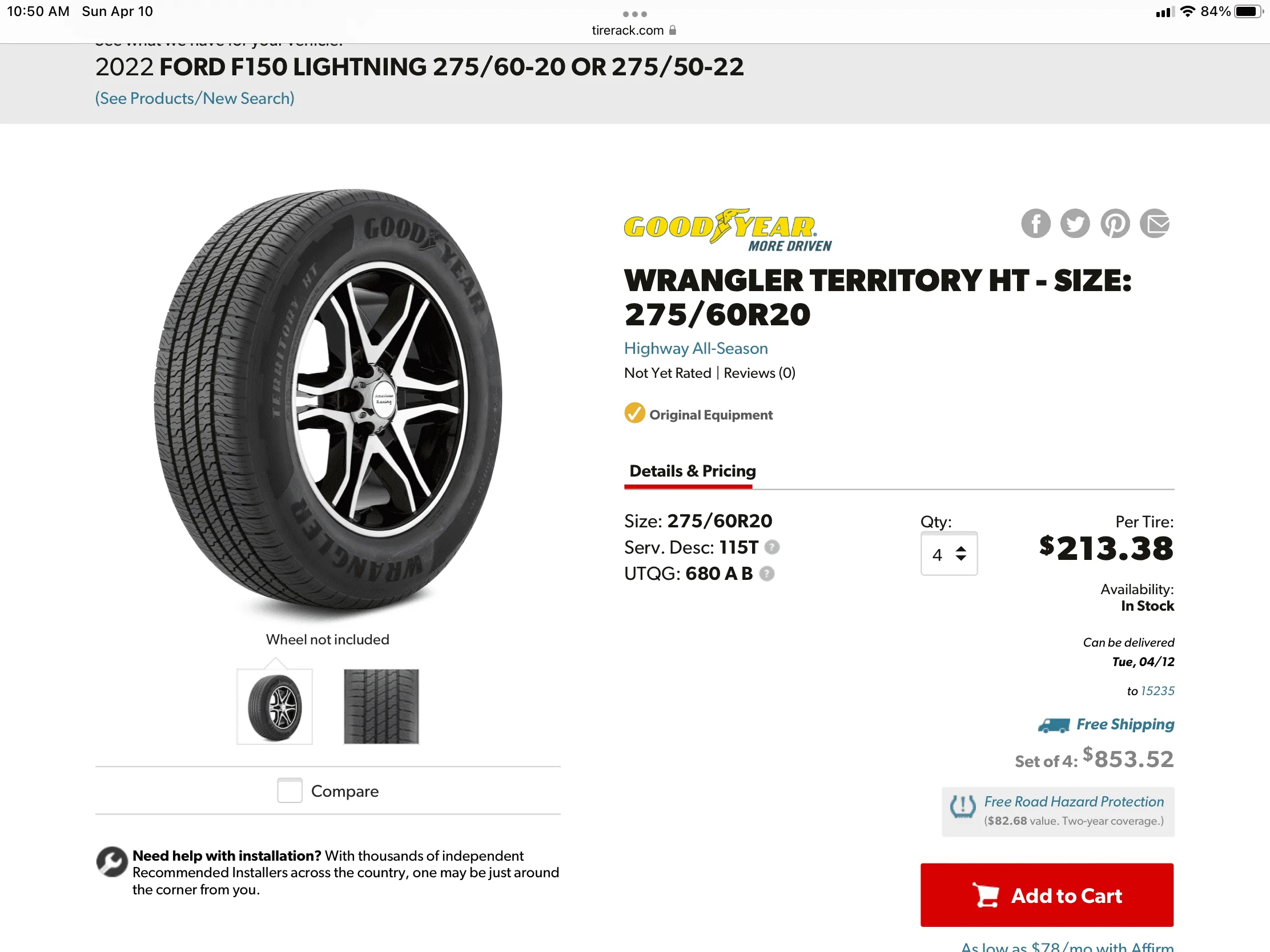

Looking at Tire Rack today, I see that the 2022 F150 lightning is now available as a vehicle selection. Filtering by the 20” option, and OEM, shows an AS tire that is the Good Year Wrangler Territory HT and the AT options as the Hankook Dynapro AT2 or Pirelli Scorpion ATR.
Good catch! Those all seasons seem to have pretty good reviews.

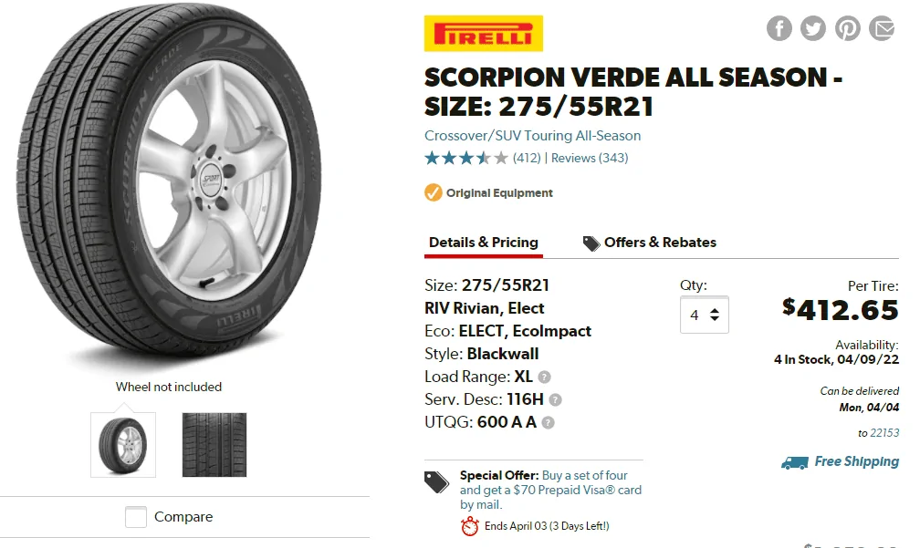

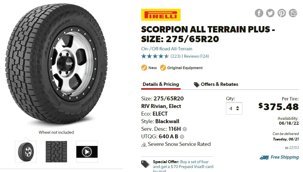

These are for Rivian who worked with Pirelli on the tires:
Ford F-150 Lightning Lightning 20" AT vs AS tire option.  Does anyone have info about these tires? 1648828141077
Ford F-150 Lightning Lightning 20" AT vs AS tire option.  Does anyone have info about these tires? 1648828168729
Neither are Lightning sizes, but perhaps you could run a 275/65 on the stock 20" wheels. Your speedo and likely range prediction would be off a bit though.
