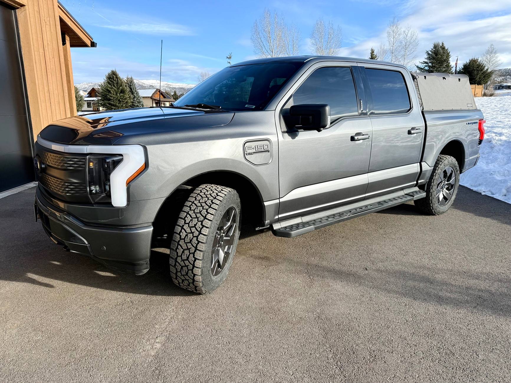

I got the Toyo AT EVs for our truck as well (stock size, 275/60/R20). The stock tires weren't doing it justice in the snow. These tires have been great. Definitely improves the look of the truck in my opinion. Here are some high level thoughts:
  • Noise: noticeable compared to the stock tires but not significant. Overall, less than expected and very pleased. After a day or two I stopped noticing it.
  • Efficiency: Doesn't seem to be any significant effect. It's hard to say as it got progressively colder after I installed them so range was being hit regardless.
  • Ride Quality: this has actually improved in my opinion.
I have owned a number of AT tires on other trucks in the past, and these are by far the quietest. I don't expect them to work quite as well in the snow as the Goodyear Wrangler Duratracs, but in the few small storms we've had I've had no issues.

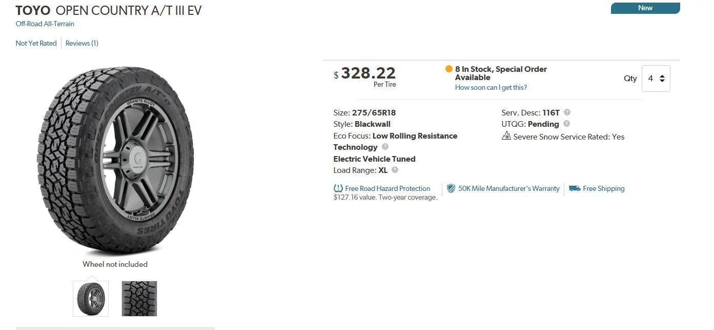

It looks like they do make that now? I'm new to looking into a bunch of tires but I think this would be a same load rating to the OEM tire? with 3 peak. I want some aftermarket 18" wheels to replace my 20" and think this would be a perfect tire to accomplish that?
looks like it, those are also 116T which matches the OEM load rating,
but these won't exactly replace the 20s because this tire/wheel gives you a 32" tire/wheel diameter where OEM 20s give you 33".
this would be a perfect replacement for the PRO/XLT 18" tires though.
