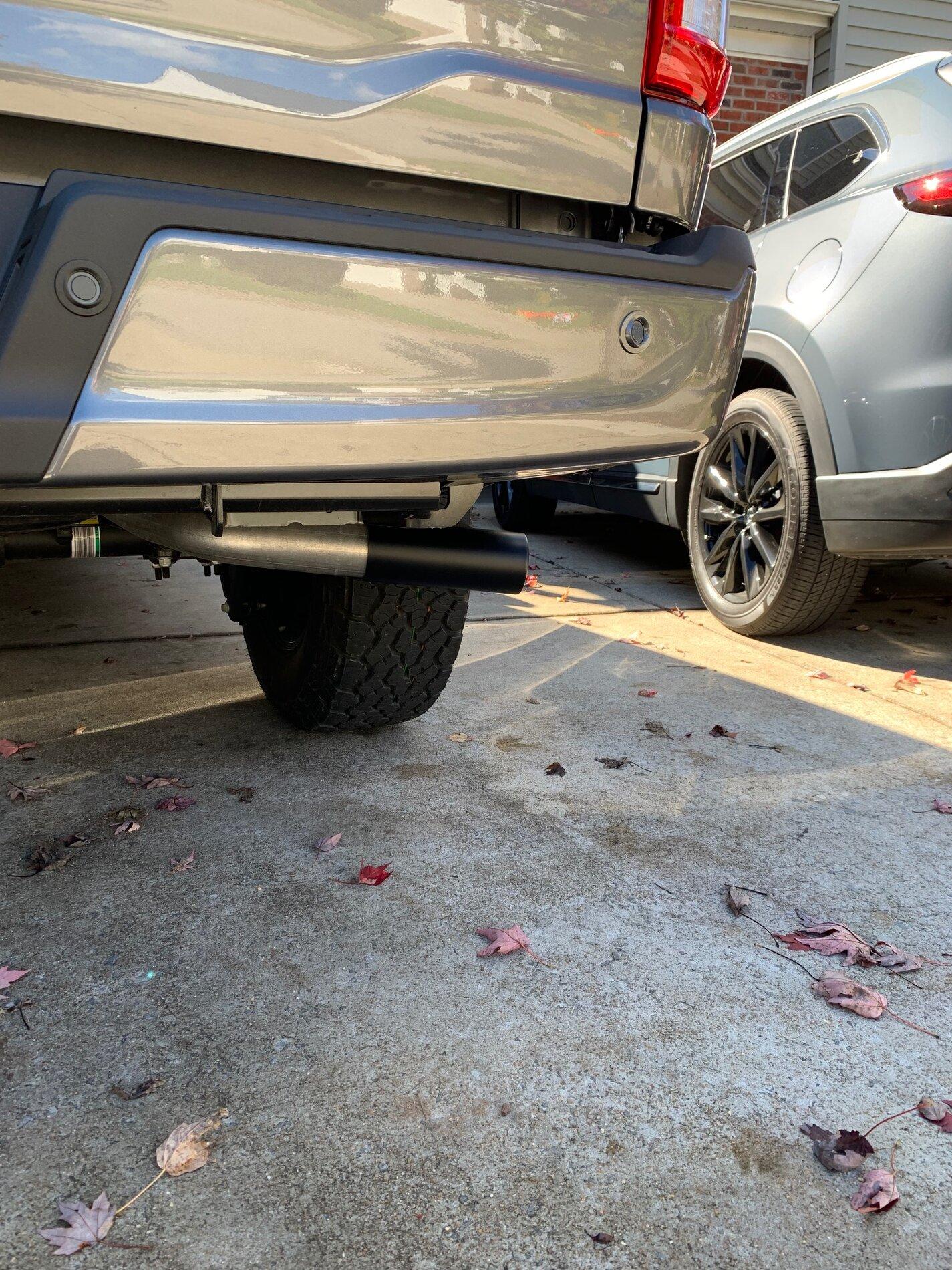

Folks, I'm going to try this later today on my 2021 powerboost lariat's factory chrome tip. It came off with twist and pull, seems to go back on okay.
how to
Picking primer and flat black paint up at Lowe's in a bit:
primer, paint
skipping the tar and wax removal as mine looks brand new still. Will follow the primer and paint instructions to the letter. Can follow up on results if interested?

I did that and used Rustoleum engine flat black. Works great

Anyone else able to pull theirs off? Tried this morning with all my might and it will twist just a bit but not come off.
Scratch that. I was able to use the wooden handle of hammer against the back edge and another hammer to knock it loose. Also had to pull and twist really hard.

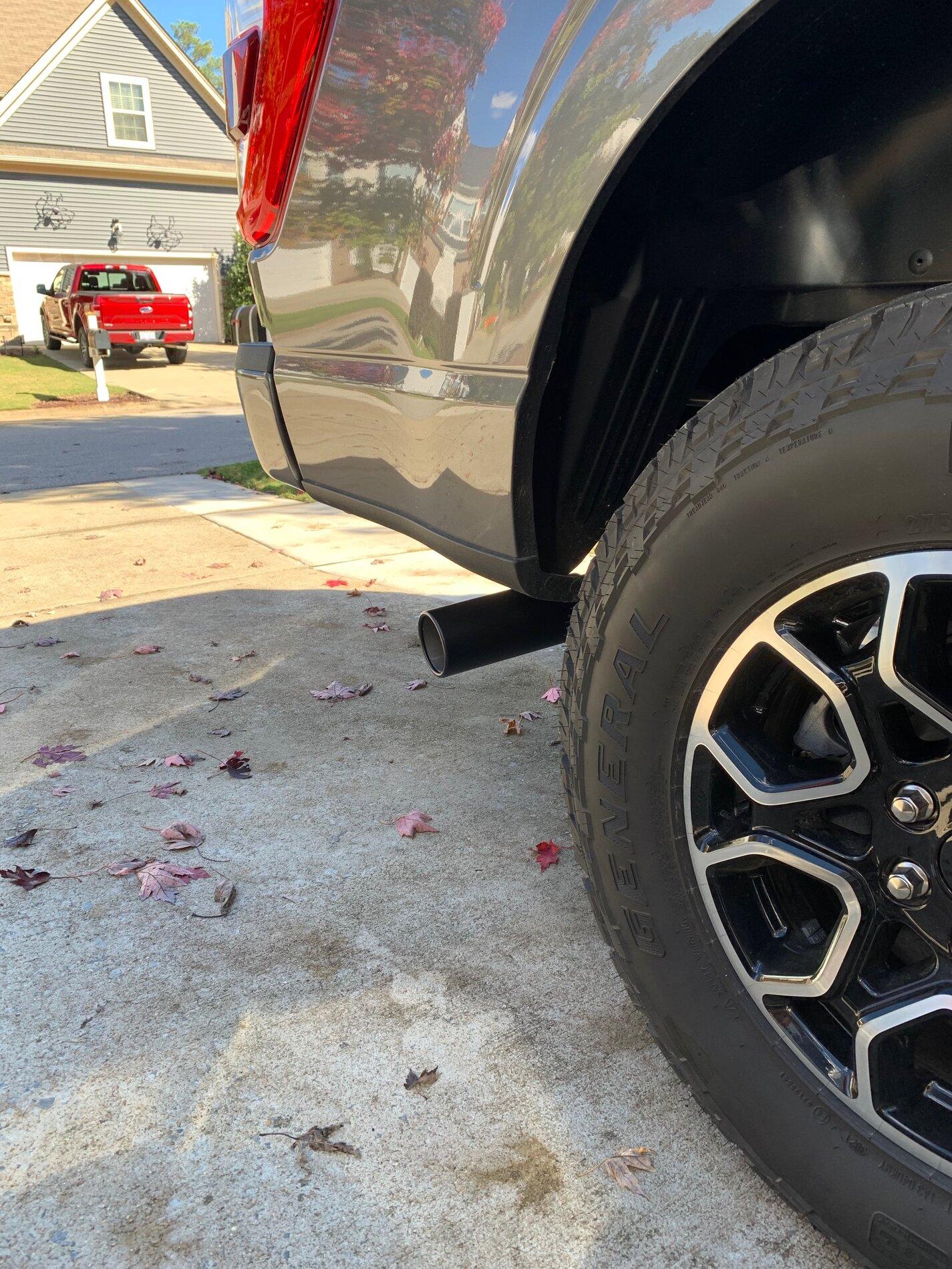

How does it look if you just remove the tip?
I’d like to cut it off where you can’t see it, but don’t want exhaust gases staining stuff under my bed.
I don’t want to put anything that looks aftermarket like the Bully tip.
So how bad does a bald trip look?
