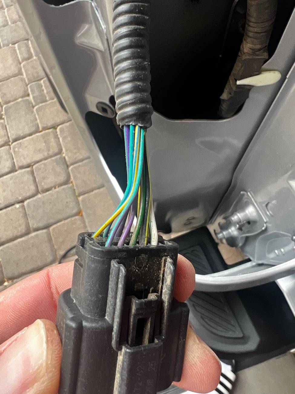

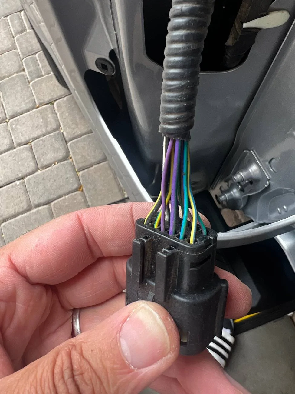

Has anyone found a breakdown of the tail light wiring? Halogen models specifically.
Trying to determine which wire controls the parking lights on the left side tail light harness.
I can find all the other f150 models except the non-led Lightning.
Ford F-150 Lightning Tail Light Wiring Guide IMG_6469
Ford F-150 Lightning Tail Light Wiring Guide IMG_6470

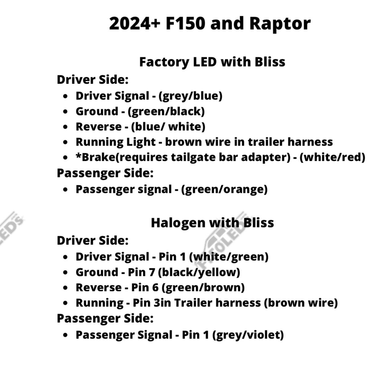

I installed the 2024 F150 SENTINEL CREE LED TAILGATE BAR.
The instructions for wiring connections match the halogen vs the LED which made me question which was which.
I got it all hooked up now and had to tap into the trailer harness for running lights. It didn’t throw any code errors and allowed the light bar to function as advertised.
I just couldn’t find any wiring diagram for our trucks anywhere.

Yeah, those folks need to work on their directions. For one thing, it is BLIS with one "S".
So you found that the wire colors on our tail light match the Halogen colors in their directions?
Correct, for reverse, and turn. I just wanted to know what all the other wires in the harness when to.
It definitely does not match the LED version listed in those instructions.
