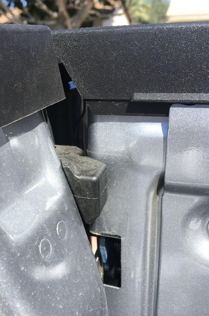

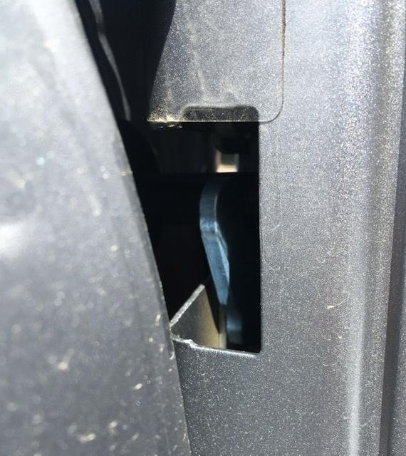

My XLT has a locking tailgate and I imagine that most do nowadays. However, the latch is completely exposed from inside the bed and it is only a matter of time before someone figures out how to jimmy it open and posts it on YouTube.
Ford F-150 Lightning Tailgate lock that fits the 2021s? E55B9D7C-3C25-447D-A58C-ECC036D0A69C
Ford F-150 Lightning Tailgate lock that fits the 2021s? A6874BC8-5E6E-4BBB-BAE3-43DD34FFF275
I looked into getting another tailgate to debadge and fill the embossed F-150 figures and even without the hardware or camera and light, it’s super expensive.
I might look into putting in a lock or hose clamp even though I like to remove the tailgate to sweep up the bed. Or maybe even fabricate an alloy plate to cover the exposed latch.

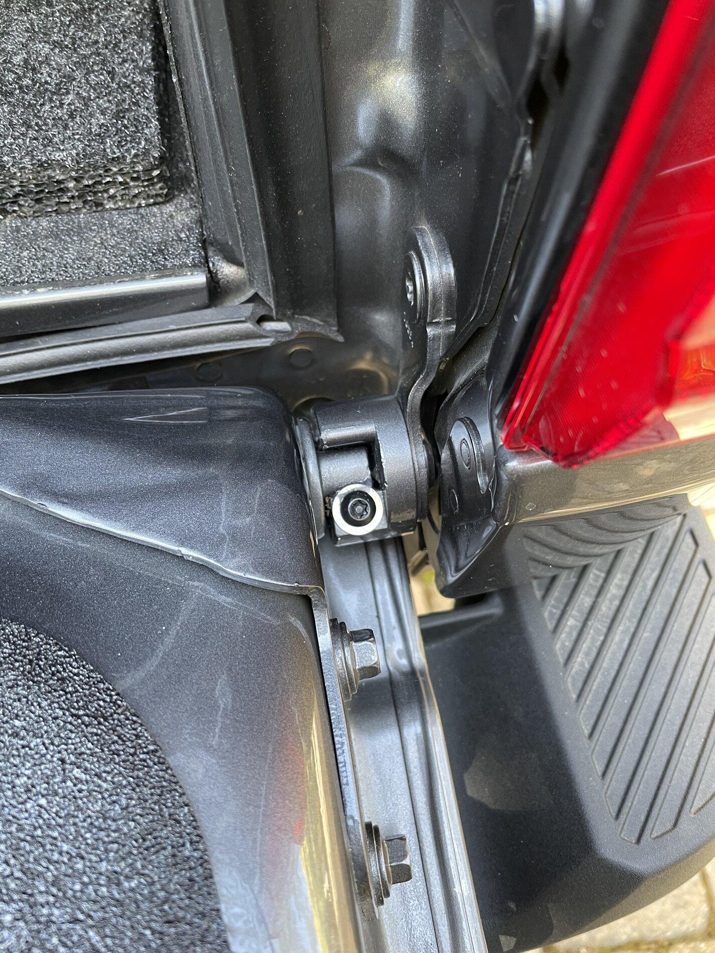

The Ford Accessory website says the right part for 2021s is VFL3Z-18168-B. Has anyone tried it and had a problem with fit?
Update: I took a closer look at the tailgate (see the photo below). It looks like the part above will not fit. But I think the best solution is to replace the holding screw with a tamper proof one, which you can get at McMaster. I'm pretty sure the screw is a 6mm x 1, 12mm.
That’s precisely what I said. Good to see someone else to same conclusion.
How confident are you about the screw size? If so, that’s an easy purchase.

The 6mm x 1mm x 12mm worked perfectly. The Ford bolt has an integrated washer that is attached to the bolt, so I had to find another. I also used a drop of Loctite blue and some SuperLube and I’m good to go. I put an extra tamper proof Torq key in the truck. I think this would be pretty hard to get off without that key, not sure how you could do it without ruining the bolt.

You need a special tool for tamper resistant Torq bolts. You can get the tool at McMaster, only $3 or so. Basically like a hex key with a special end.

There is a link to the tool in the description of the bolts on the page where you order the bolts. Or you can search for Tamper-resistant torq and it'll pop up. The part number for the T27 L-key used on that bolt is 55525A29.
