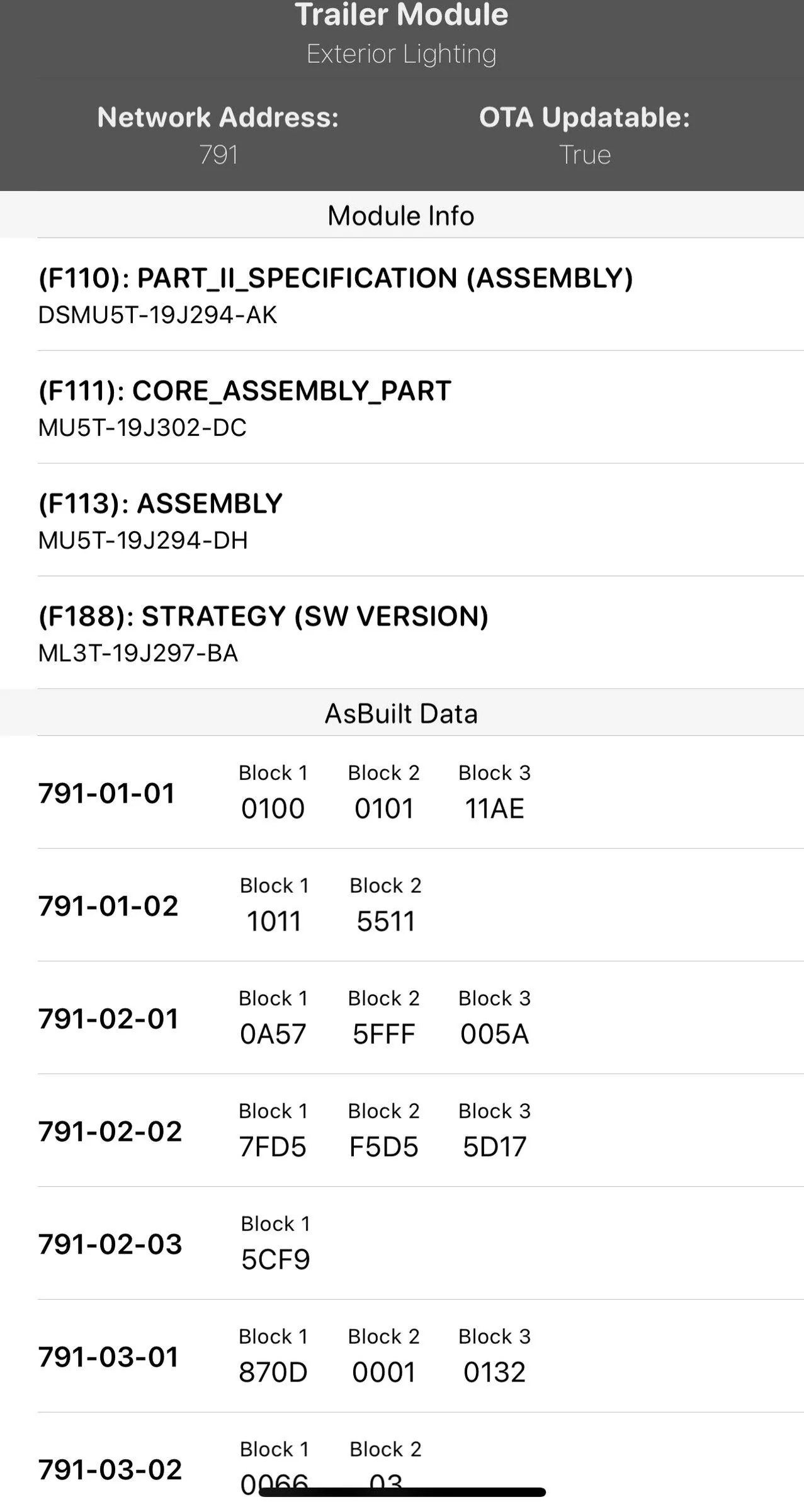

Ford replaced my brake module last November after a case was opened about this issue and Ford engineers inspected my truck. They sent my dealer a new Brake module to install and I have now updated to the latest TRM software. My new module information is below. I have not had a chance to test it as it’s been winter and my trailer is in storage so I don’t know if the problem is fixed yet for me. I’ll know end of April.

I’m wondering if the assembly p/n of mine is different than others. Showing that it’s an updated hardware version.
It is slightly different. Node F113 for you ends in DH. Mine ends in DG. Otherwise, they are the same.
Its slight, but I wonder if they introduced new hardware to address this. When mine was replaced, my dealer didn't just order a new one, but it was sent by Ford to replace my existing one because of my case. Don't know the P/N of the old one though. Mine was built in June 2021. I would be curious to hear what hardware P/N are in what year of truck to see if there are many hardware versions.
It would be interesting to explore. But my gut says no. A part number change could be anything. Sure, it could be a revision to fix a defect. But it could also be an innocuous change, like a change in vendors, a change in the way the controllers are manufactured to reduce costs, etc. If the change resulted in a performance difference to address a defect, I would have expected a change at F188 between yours and mine. That’s where operational changes are usually made. But certainly worth looking into further.
