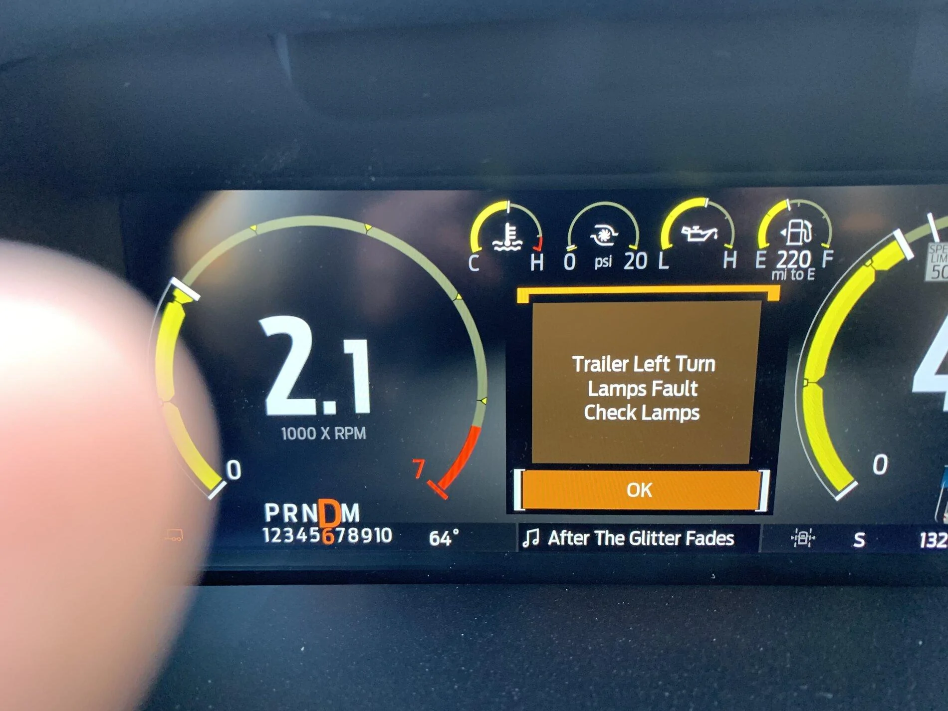

Just picked up my boat today, the adapter that came with the truck for 4-way flat is extremely tight & hard to put on the adapter. Once on &adapter plugged in, I keep getting fault on left blinker. . I also hooked up a utility trailer with 7 pin, also gets the same fault. I clear the fault, comes back every few minutes. looks like a trip to the dealer
Please keep us posted with dealer diagnosis. I’m going try a couple things provided by the fine folks on this thread but if no luck maybe we have similar issue.
