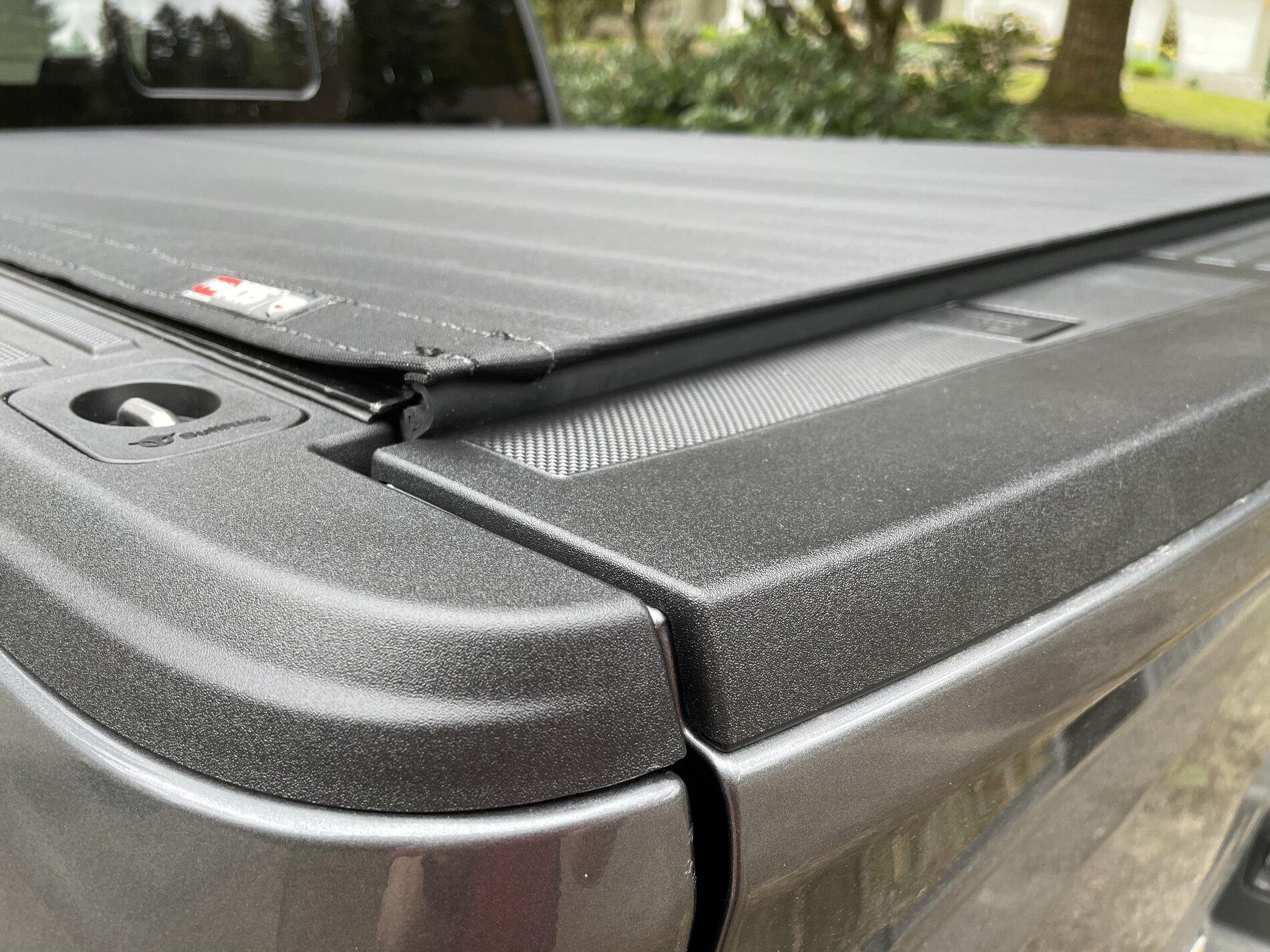

I just added pics for my case. The one where it “sits up” is when the cover is closed first, then the gate. When it’s laying flat, it was closed gate, then cover. I’d really like it to be either way worked fine, then I’d have one less thing to remember!

I can see in your pictures that your tailgate is not closed all the way. The side rails are too far back. I pretty sure if you make that adjustment with the side rails that everything will be fine.(y)
