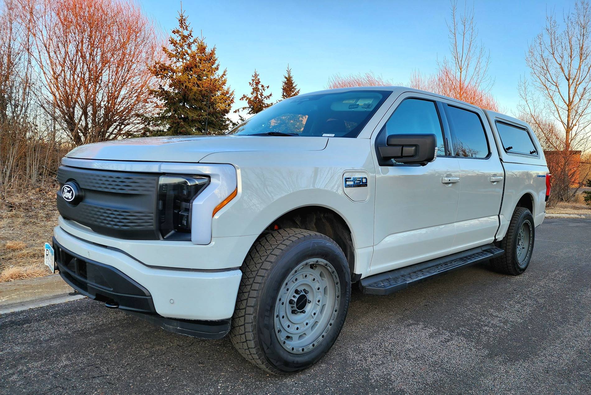

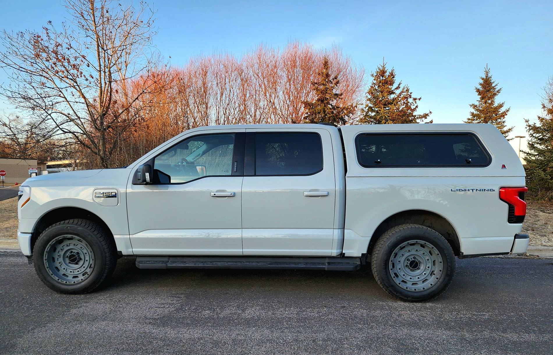

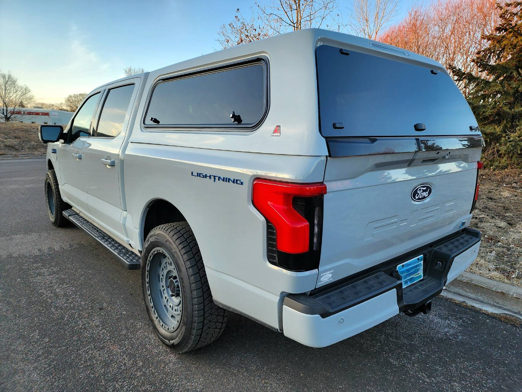

Here's the 3/4" Rough Country kit installed, front and rear. Overall fairly mild, but clearly better than stock. Open tailgate is at least 2" lower, so that's a plus for loading.
It left me with about 6.25" fender gap in front and 7.00" in the rear. I'd rather have zero rake, but the 2" front lift /-1.5" rear drop would have given more negative rake than this is positive.
Looks great! I'm going with bigger tires 275/65/R20 so I'm leaning towards installing the 2 inch front spacer. My rear kit didn't lower as much as yours did. I used shock mounts ment to lower the ice trucks, this was before rough country released their kit. Your truck looks awesome. Thanks for posting the pics.
Thanks. Yes, I like that tire size too. I'm fairly certain 275/65R20s would fit mine with stock-offset wheels, but would not fit with my +6. Maybe there's an offset in-between that could fit. Really only worried about the front air dam lip, which I know some have trimmed.
