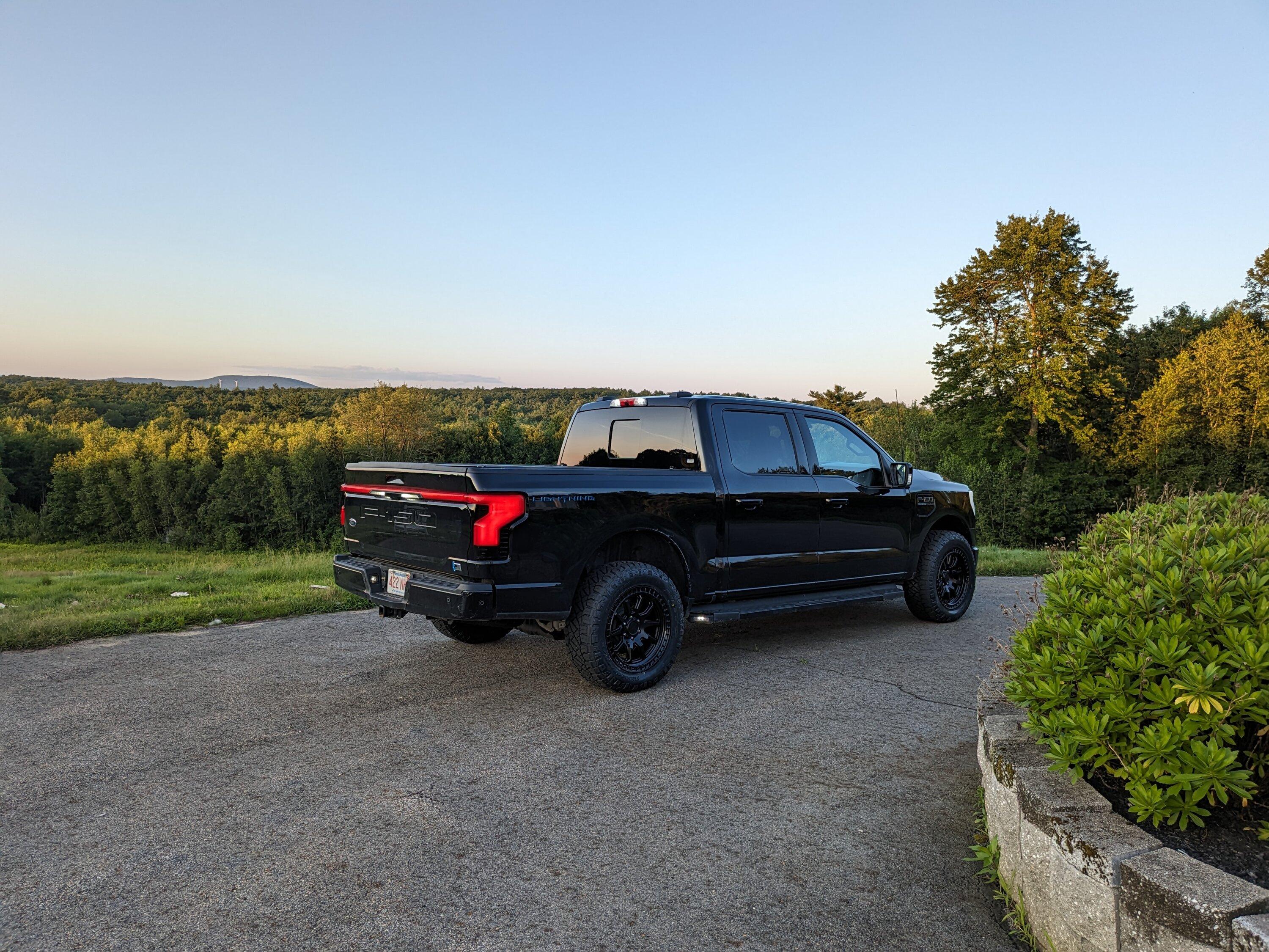

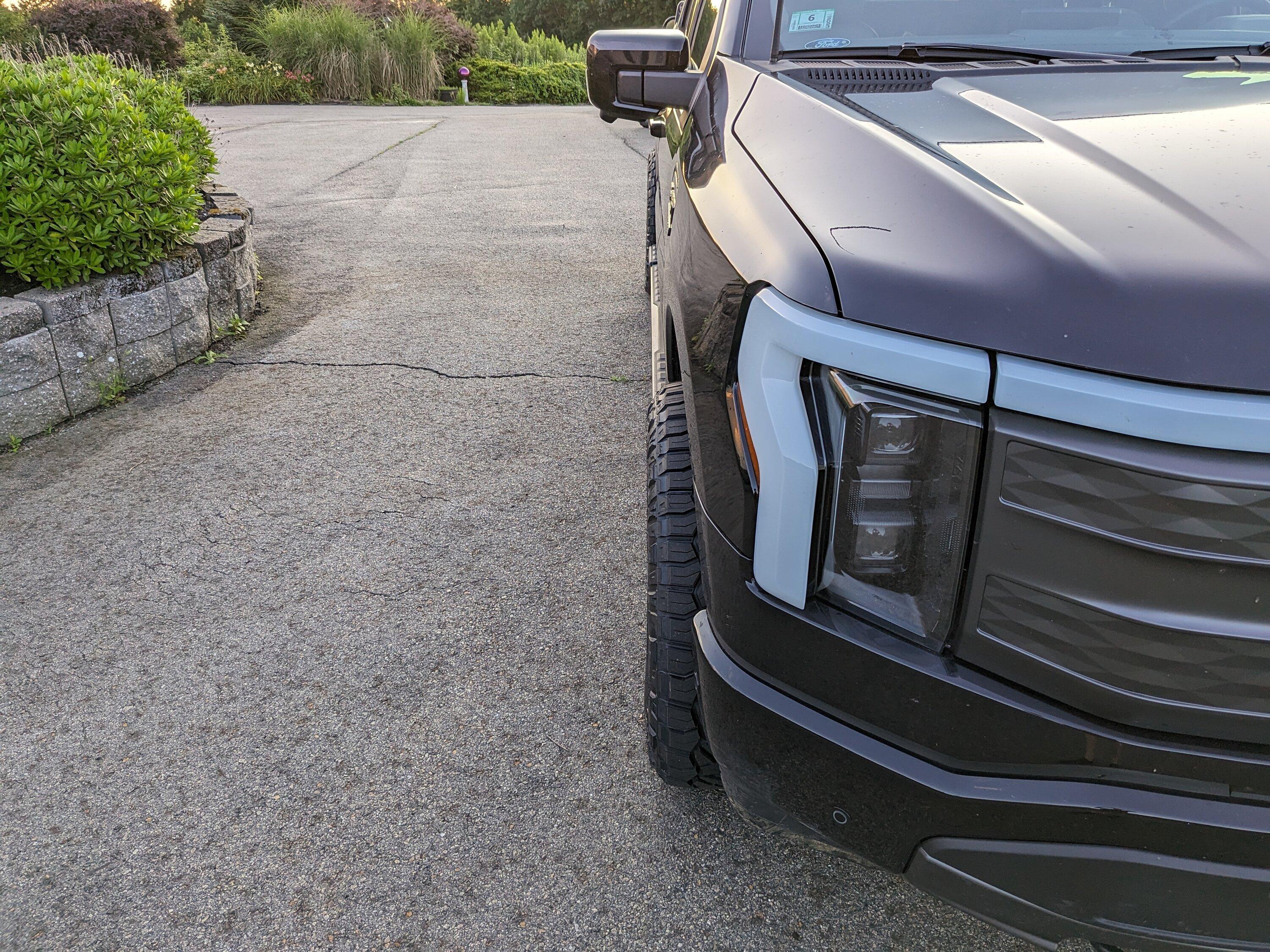

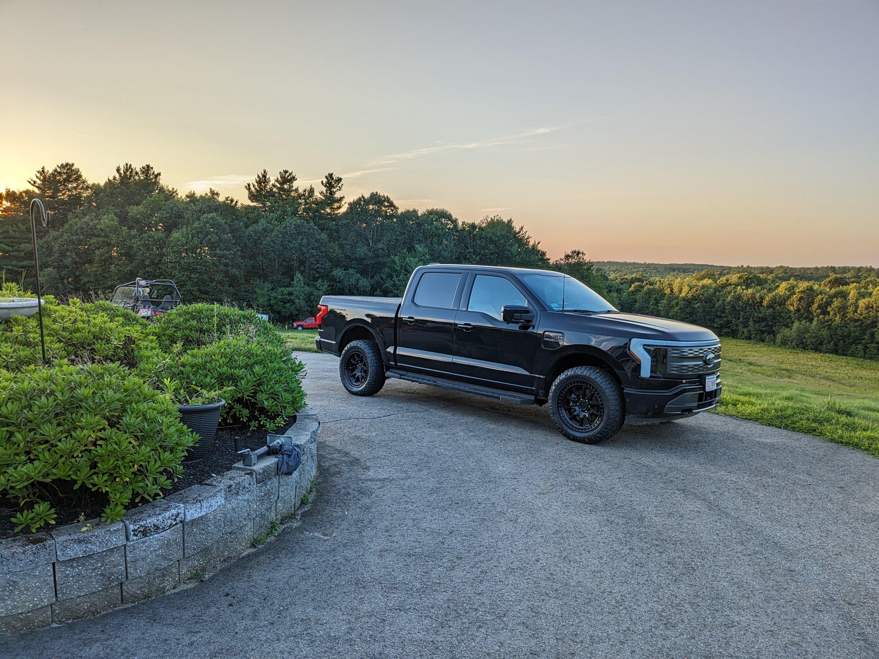

Obligatory pics of truck with new wheel/tires:

Perfect amount of poke in my books..... (assuming your local law enforcers are ok with it). I wouldn't put flares on that - I prefer the cleaner look without them. Factory-size tires so I would expect your range to be pretty close to standard. A small leveling kit won't hurt the truck up to a couple of inches with an alignment. What was the offset on the Black Rhinos?

I expect you will see a range hit. The GOM tries to use driving history, so it won’t show up there for a while. Watch your MPK to get an idea of what’s going on.

I raised the front only at one point and had no issues. As far as a range hit, I have found that the the type of tires will affect range more than anything.

I have a similar setup, but not experiencing any rubbing. I've got 20x9 Fuel Vector wheels with +20 offset (OEM wheels are +44 for reference), Mickey Thompson Baja Boss 285/60R20 tires. I'm seeing a bit of poke as well - more than I thought it would be. Wouldn't mind adding those flares like that post you linked above, but mostly just alleviate the mud spray.
I'd like a more leveled look but would rather lower the rear than lift the front, but I don't have the funds or the expertise to do it myself. I'm also afraid of leveling and then getting that rear squat when hauling a load... I'd much rather put up with a little bit of rake to avoid that.
Not sure how much it would help the front wheel clearance, but it probably does help a tiny bit.
