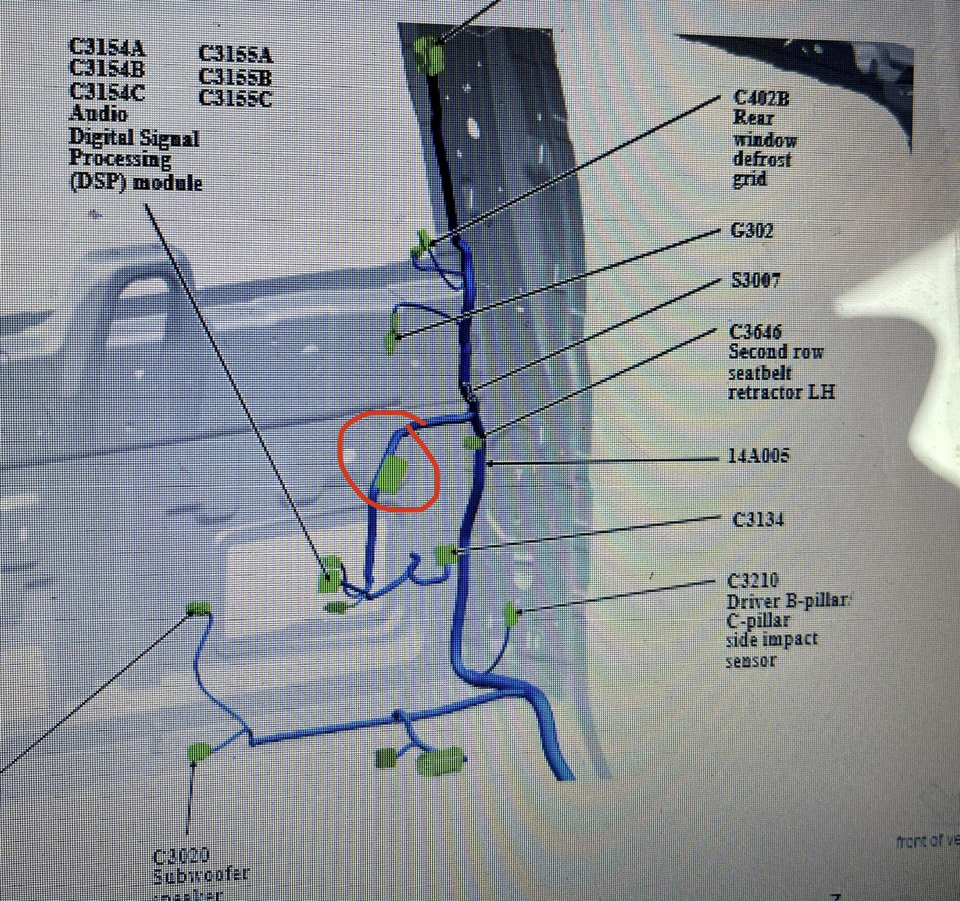

What is this connector for?

Do all F150's have this wiring? Don't have a subwoofer, looking at adding one, it would be easy if the wiring is already there.

I remember seeing the Wireless charging pad in the console connecting to the back of the rear seat.

Power sliding window?
No. It isn't for the power rear window. I have a power sliding window. This connector does not connect to it. I am wondering if it is for heated rear seats. I remember reading somewhere that the higher trim packages have them.

Apparently Ford doesn’t know what it is either..
Thanks for looking into this. Since the dealership hasn't gotten back to me, I am guessing that it also does not know. Interesting. Given the 12VDC on one of the pins that is fed by a relatively large conductor, it is a good bet that it is not just a signal cable but it is meant to power something.
Good guess! If it was thick then it must be to supply something hungry like heated seats. I have a KR with heated seats, I will see if mine is connected tomorrow (if no one beats me to it).
Connector C3134 lists that it’s the heated seat connector. I would still check your KR though to maybe figure out this mystery! ?
Nice work! Where did you find the listing for the C3134 connector?
I used to be a Ford tech, and I still have friends in who may or may not give me access to workshop manual/wiring diagrams. ? I still am not sure if that’s the original connector you were looking at.

Something for the stereo? Looks like its near the amp behind the seat.
