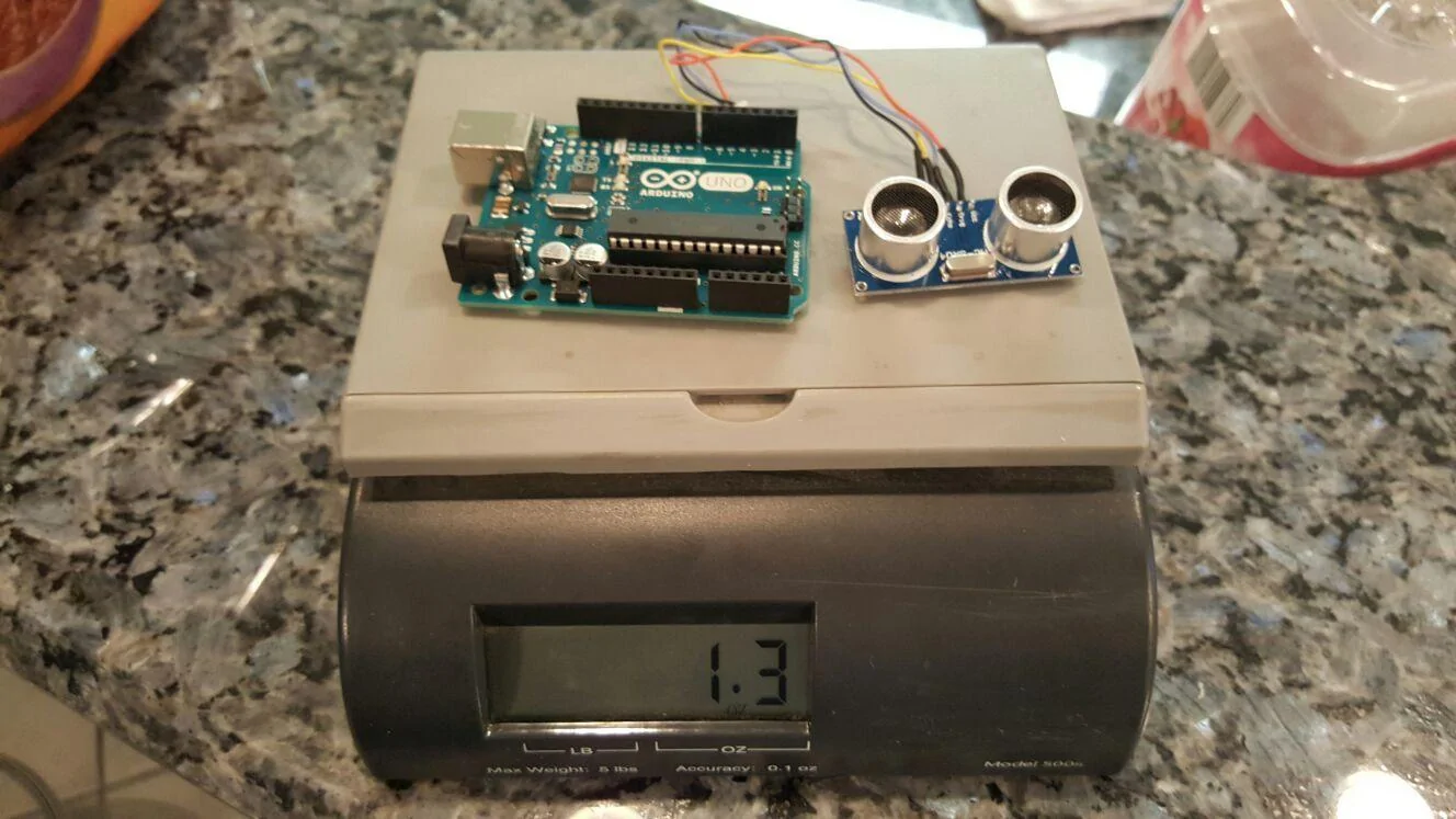

Biggest difference between pi and Arduino is Arduino needs no operating system. I built automatic landing gear for one of my drones using an Arduino coupled with a sonar sensor so when it gets close to the ground the gear deploys, retracts when it lifts off.
