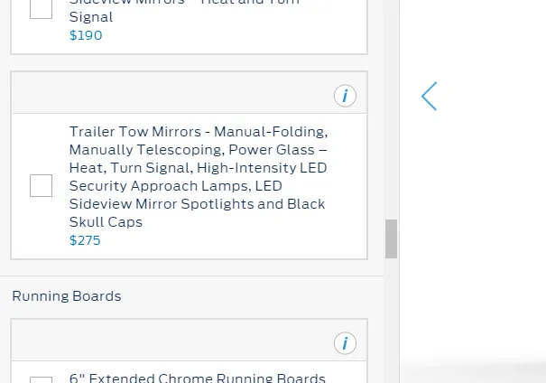

I got the F-150 tow mirrors, I think it is a $250 add on . They are pretty nice. They extend out about 4 inches. The f150 tow mirrors used to come standard with max tow package. Not in 2021.

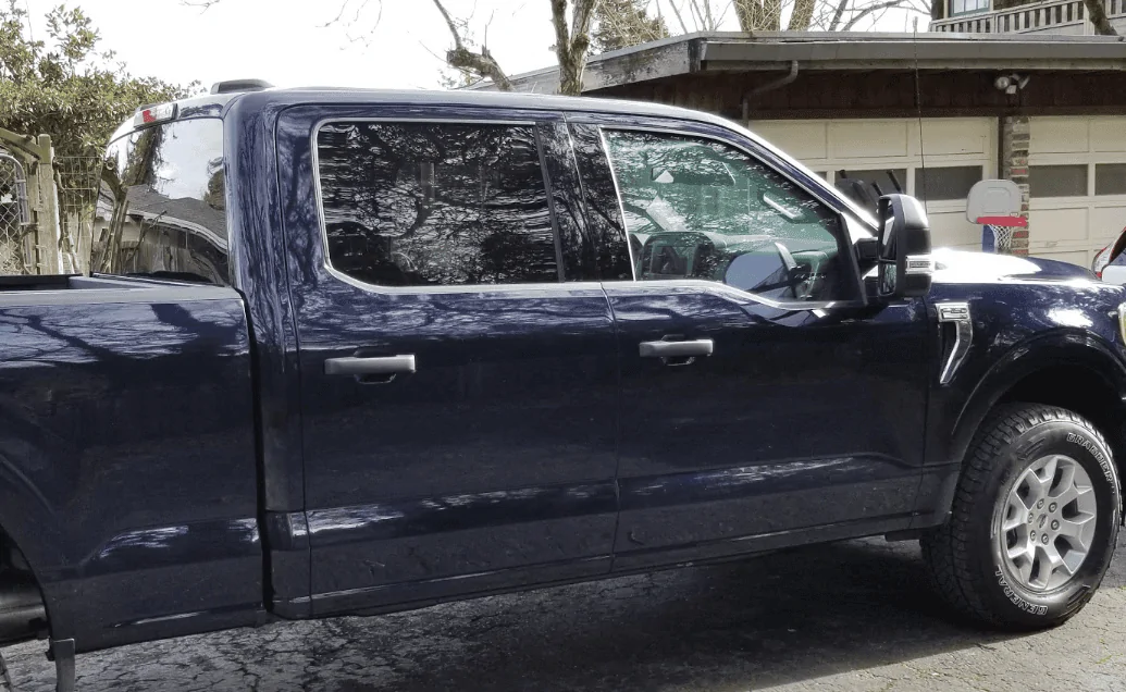

I love my tow mirrors. I tow a travel trailer on occasion.
