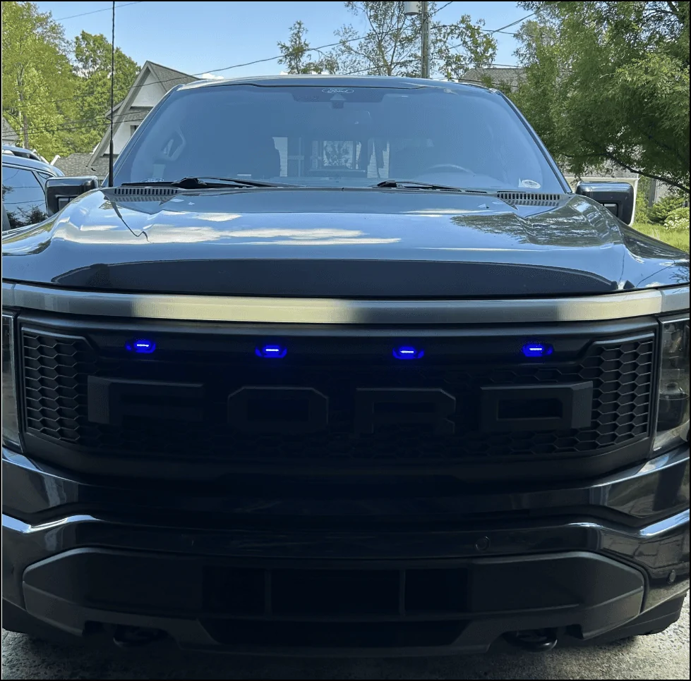

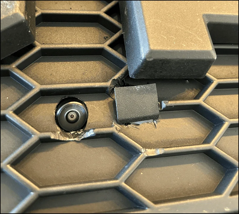

Inspired by a couple of other brave souls on here, I ordered the mesh style aftermarket grille and just installed it this past Saturday.
Full disclosure, I still need to do some cosmetic work where the camera and "squirter" come through the front of the grille. However, both work properly as does the open/close button. I used a big ole drill bit followed by a dremel to shape the opener for the "squirter." I got impatient and wanted to see everything work, plus it was ungodly hot outside. I'll fix up the details later.

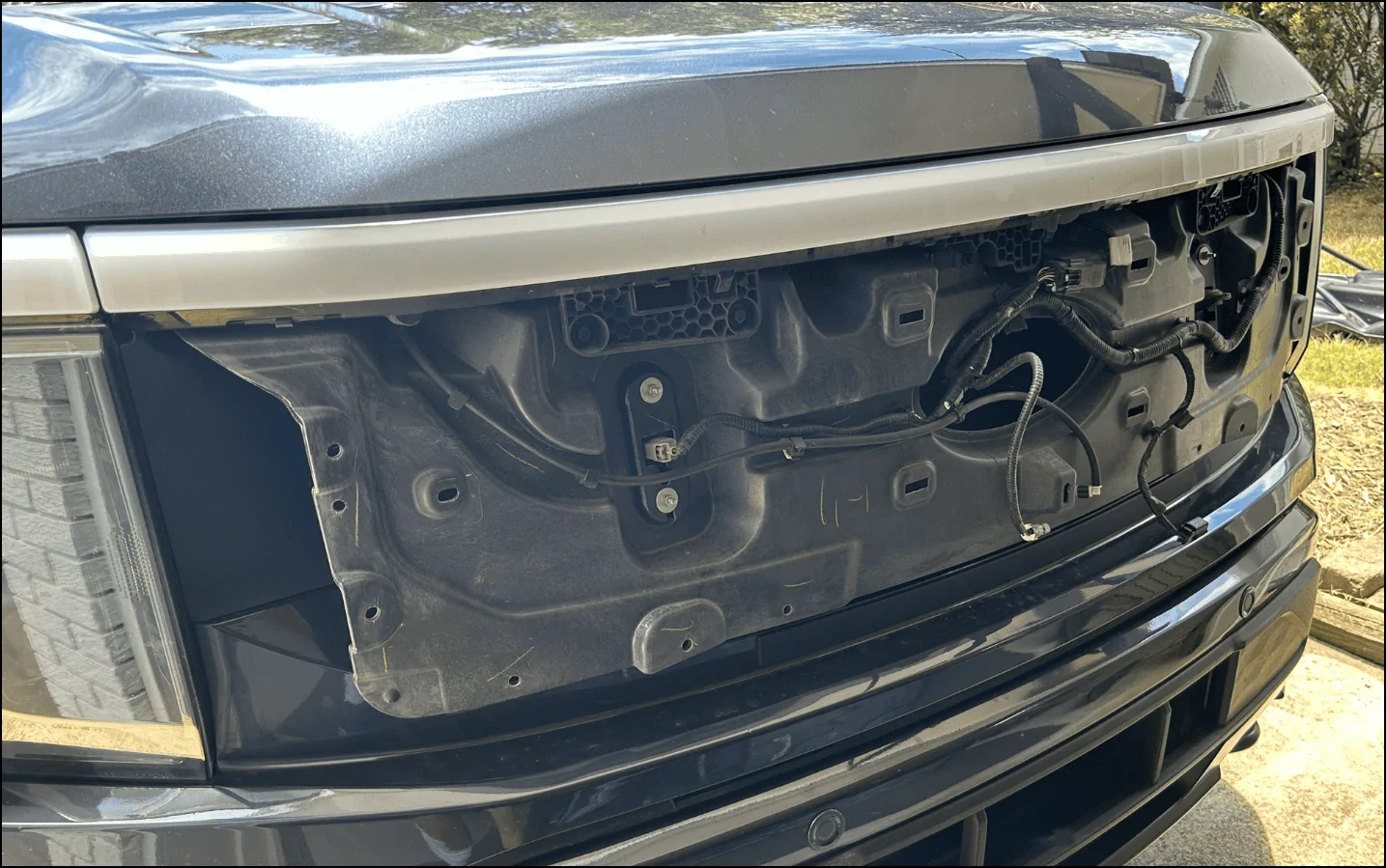

The process wasn't too bad. After painting and installing the letters on the new grille, I took off the old one following the instructions from another thread. First, take off the two L-shaped plastic trim panels on the inside of the frunk lid; these are held on by poppers. Next, take off the 6 (or 7) 10mm bolts along the bottom of the frunk lid; the grille cover will come off with a little pulling. Be sure to unplug the open/close button, squirter, and front camera before yanking too hard.

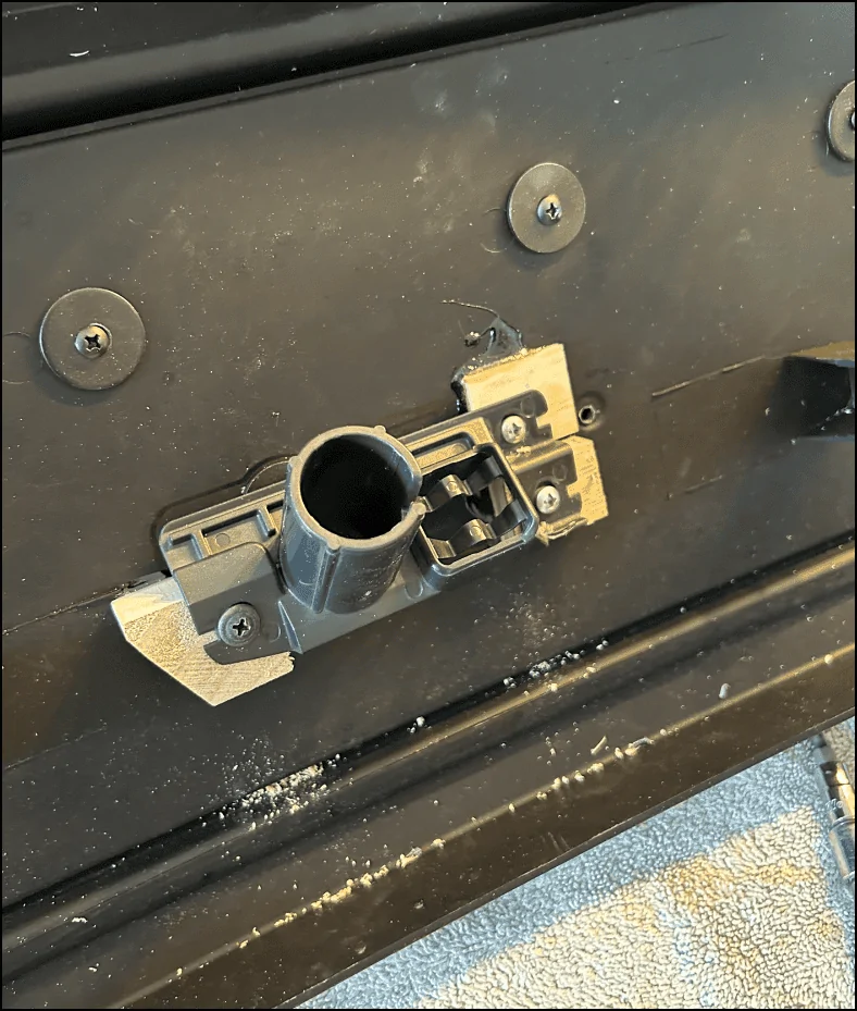

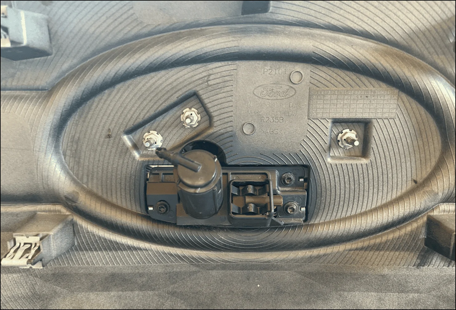

Next, I removed the camera/squirter mount so that I could "transfer" it to the new grille. I use the term transfer loosely because there is no mount on the new grille.
Ford F-150 Lightning "Raptor-ish" Grille Swap Screenshot 2024-07-09 172933

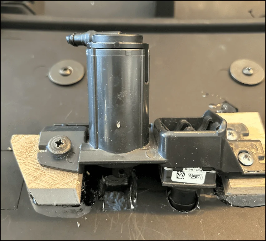

I used some plywood and epoxy to create a new base for the camera/squirter mount. I then used the mount to drill out holes for the camera and squirter.
Ford F-150 Lightning "Raptor-ish" Grille Swap Screenshot 2024-07-09 173451
Ford F-150 Lightning "Raptor-ish" Grille Swap Screenshot 2024-07-09 173712

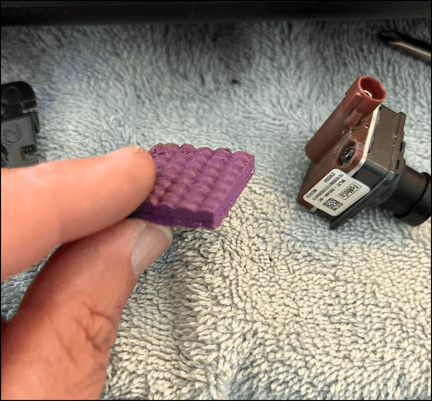

I had to use a little foam square to help the camera protrude sufficiently.
Ford F-150 Lightning "Raptor-ish" Grille Swap Screenshot 2024-07-09 173813
Again, the camera and squirter work and I'm pleased with the overall appearance. But I do need to touch up the little details around the openings. That'll be a job for a cooler day.
Ford F-150 Lightning "Raptor-ish" Grille Swap Screenshot 2024-07-09 173956

I dig it. Those blue LEDs were a good call. This might be my favorite grille mod.

I really like the blue LEDs. They look sharp. I have no idea what your your local laws are, but you might want to verify blue external lights aren't verboten. I think the police have a monopoly on blue and a decently bored one might want to hassle you about it.

Damn. I think they are illegal in NC. Thanks for the tip.

No problem. Sorry to sour such a clean look. You could possibly get away with swapping them for less blue "white" ones and avoid most of the scrutiny. Or get ones that change color and just show off the blue at cars and coffee. :)
