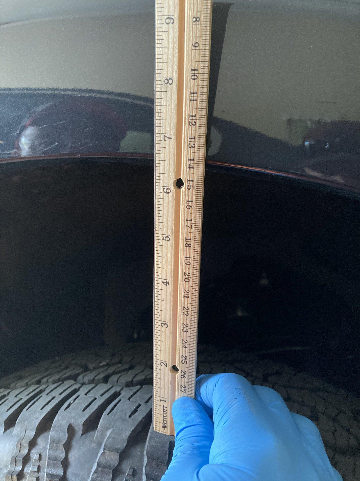

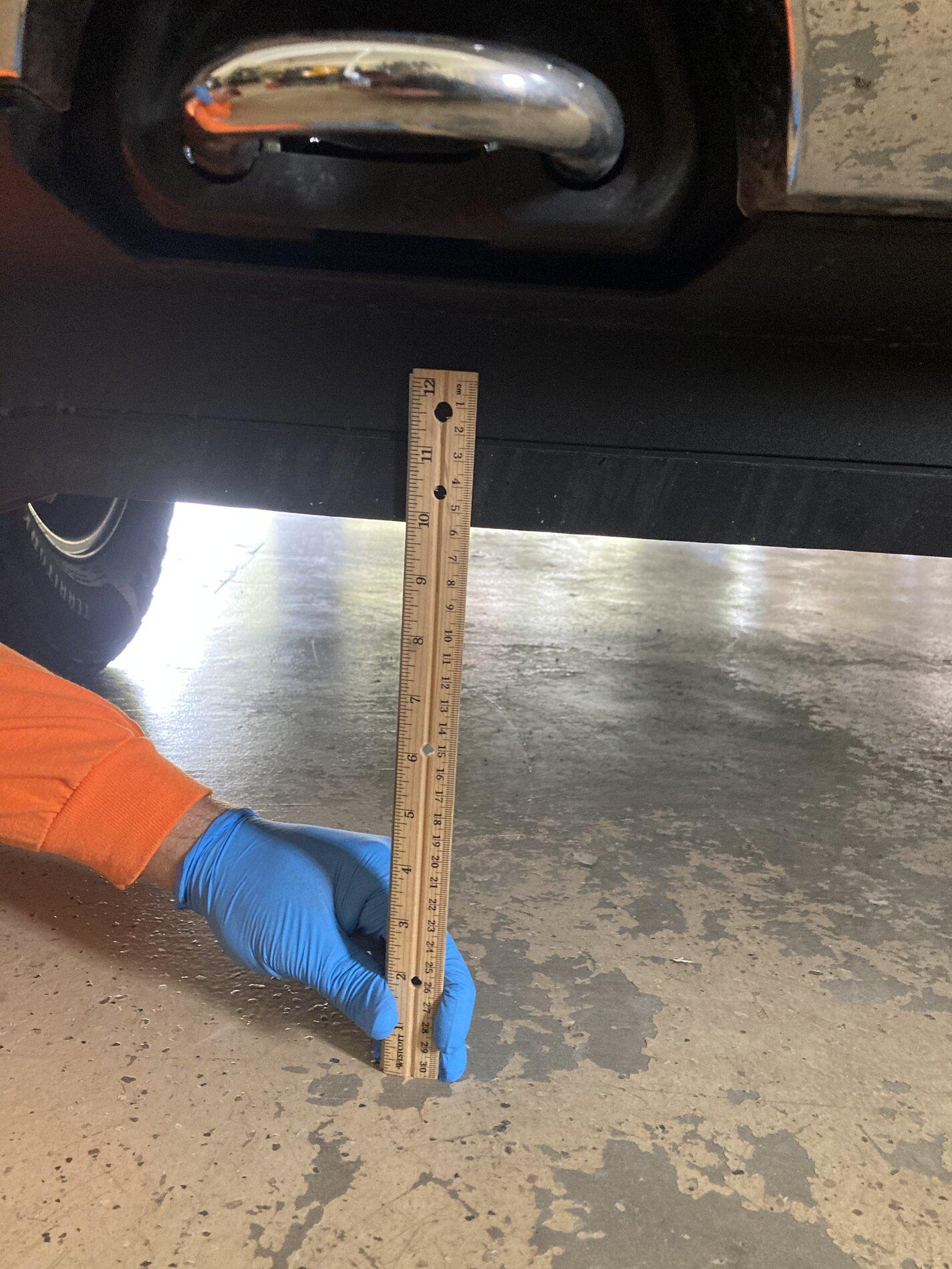

I just installed, here’s my experience....

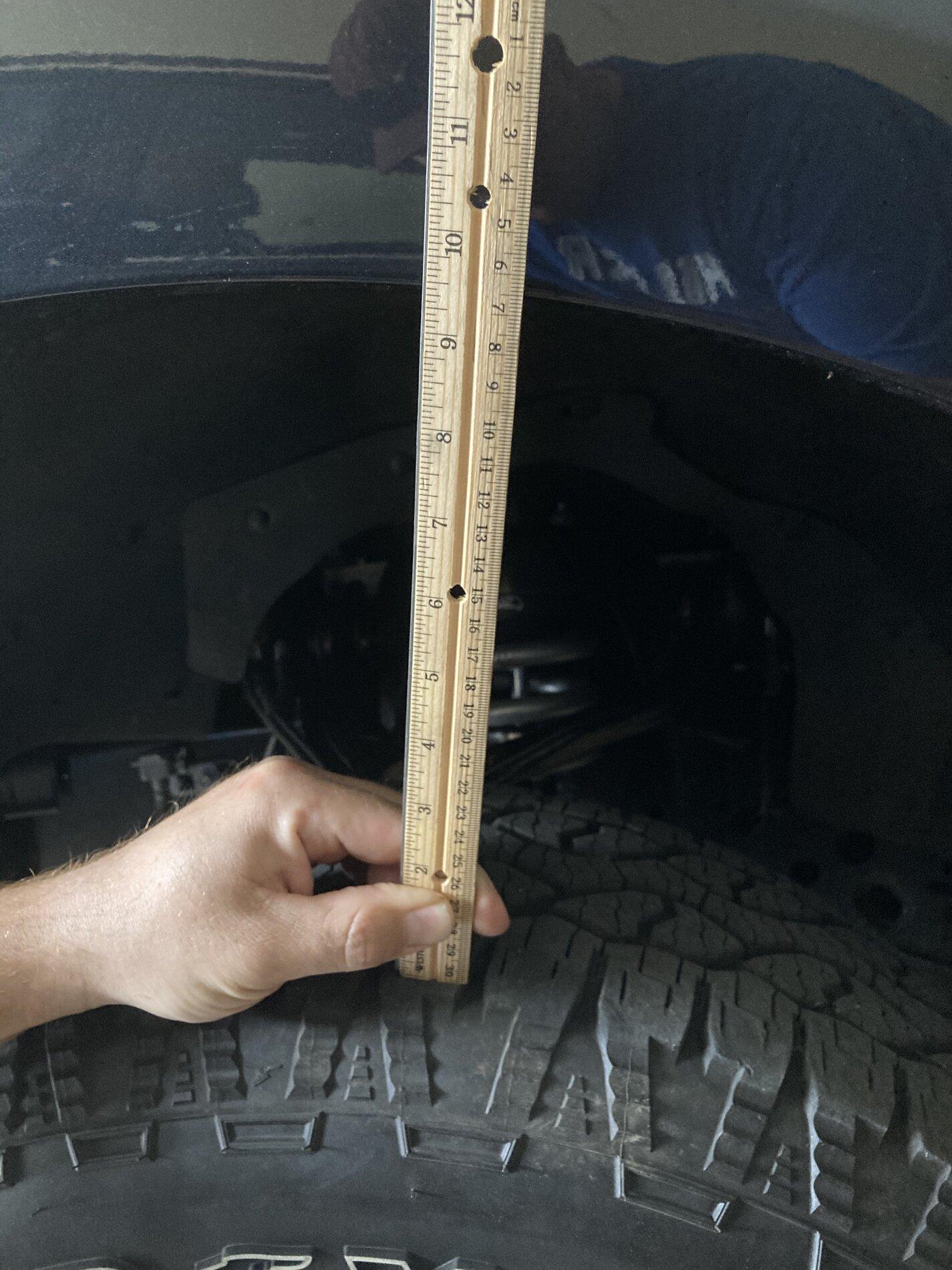

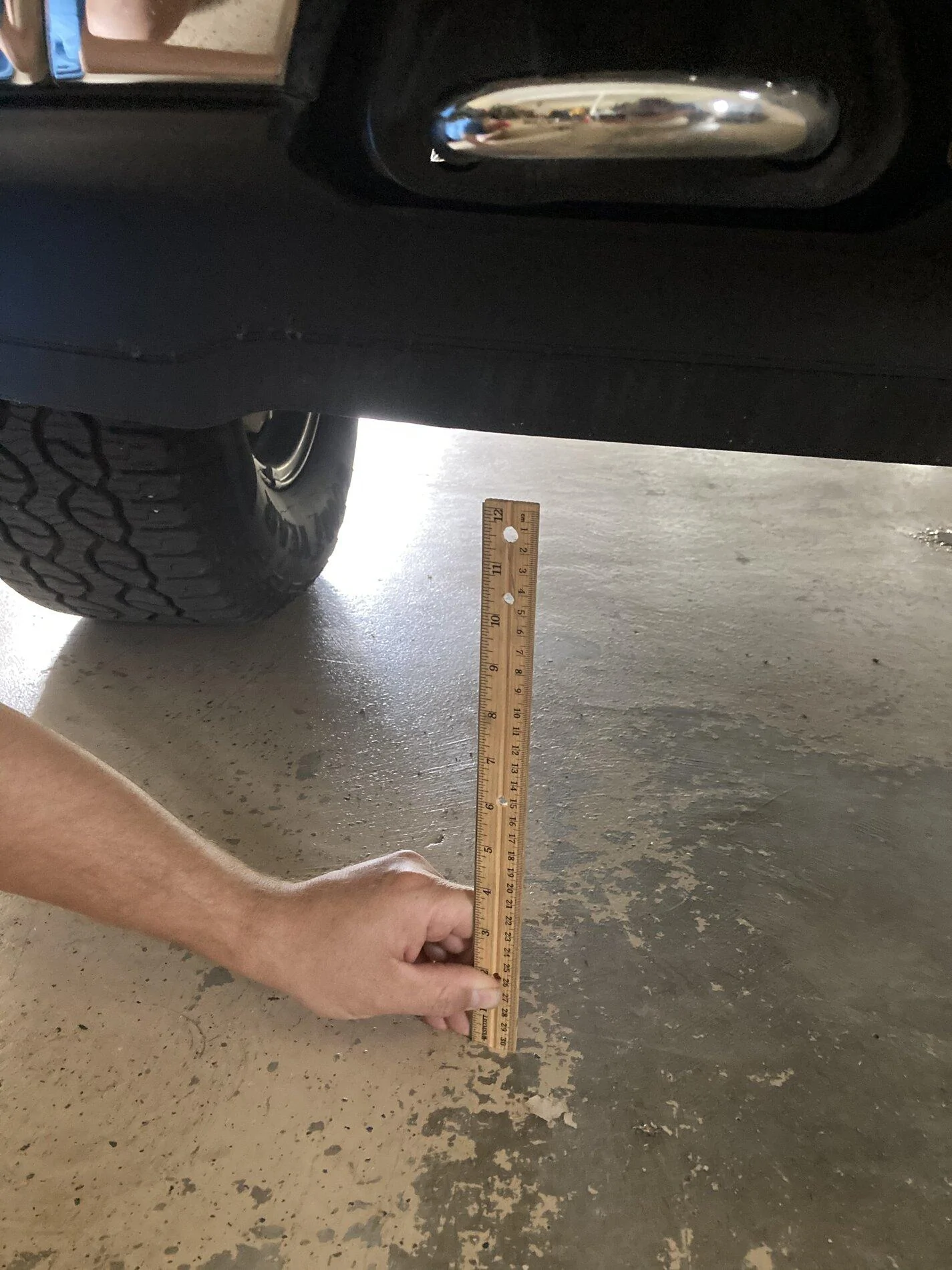

Installed the Roush Fox 2.0 kit on my 2021 Lariat FX4 yesterday. Opted against adjusting the Fox fronts because the overall length of the new coilovers were the same as stock, so wasn’t even sure it would actually yield 2” of lift. I figured the new springs would be stiffer, but no way did I expect the results. Took all measurements before and after, here’s what I got....
Front - 3”
Rear - zero (duh)
I’ll try to attach some pictures here
Bottom line, I’ll need to adjust that nut down 5/8 inch, just as Fox recommends (actually, directions say required). That should lower the front about 1”.
Unless you like that much lift. In all fairness, it is level (1/2” of rake)

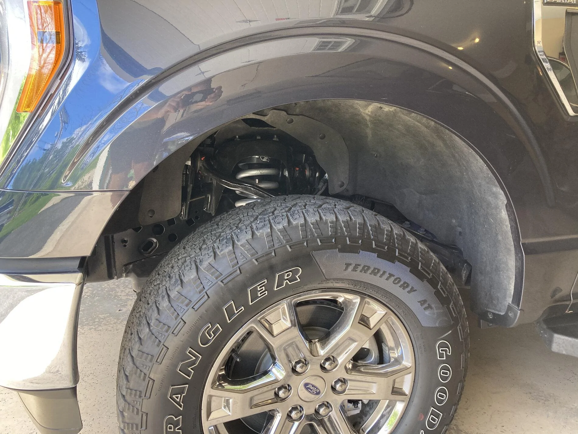

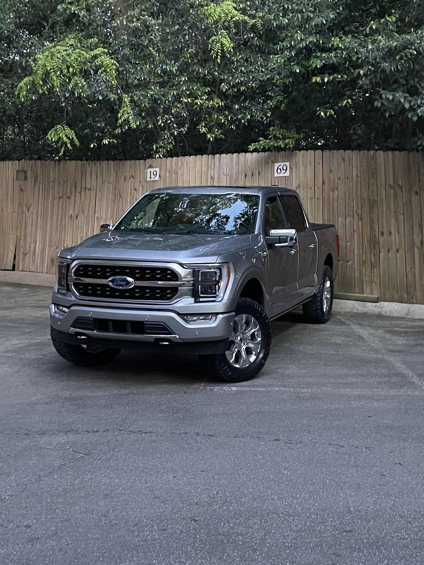

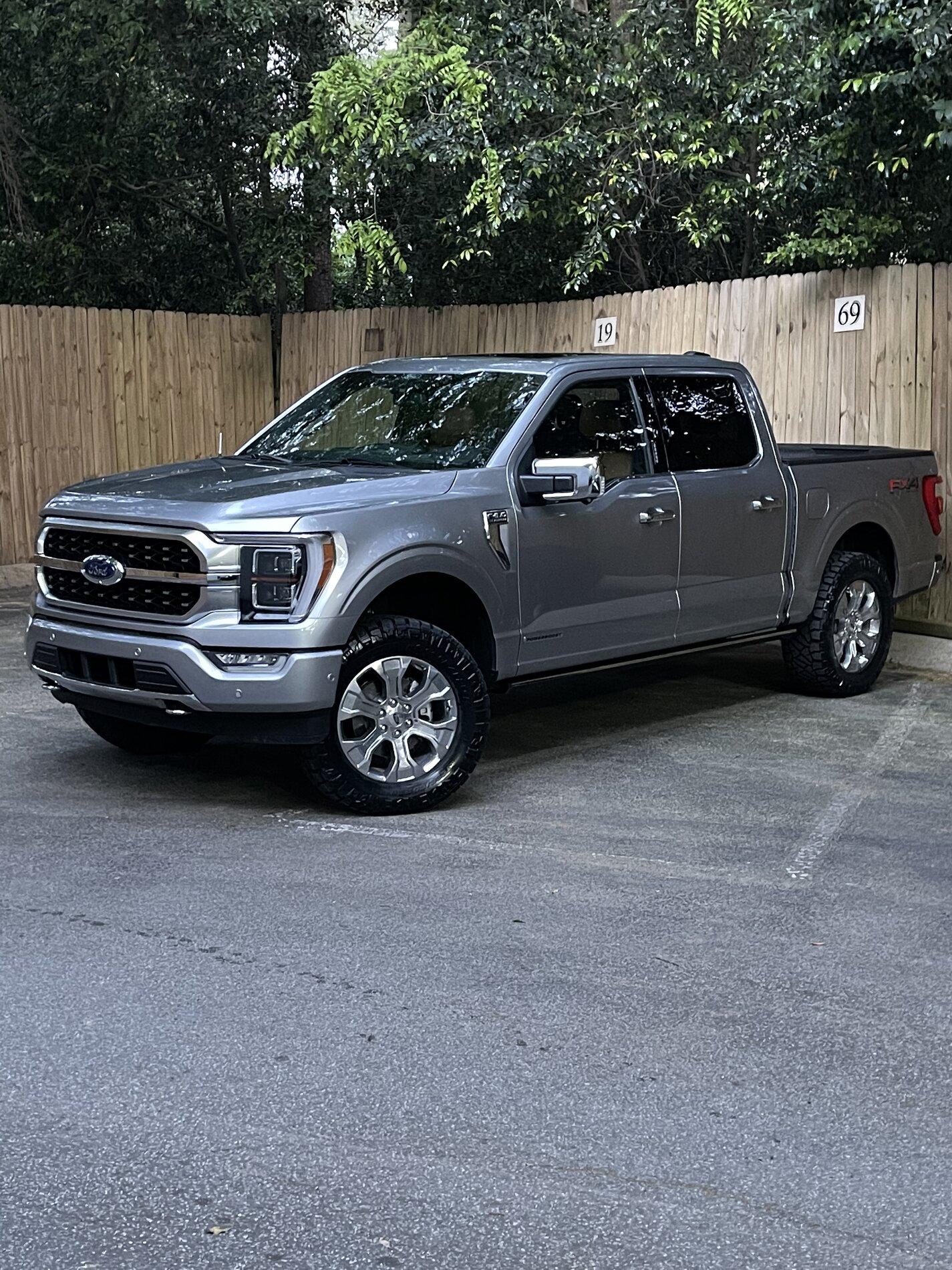

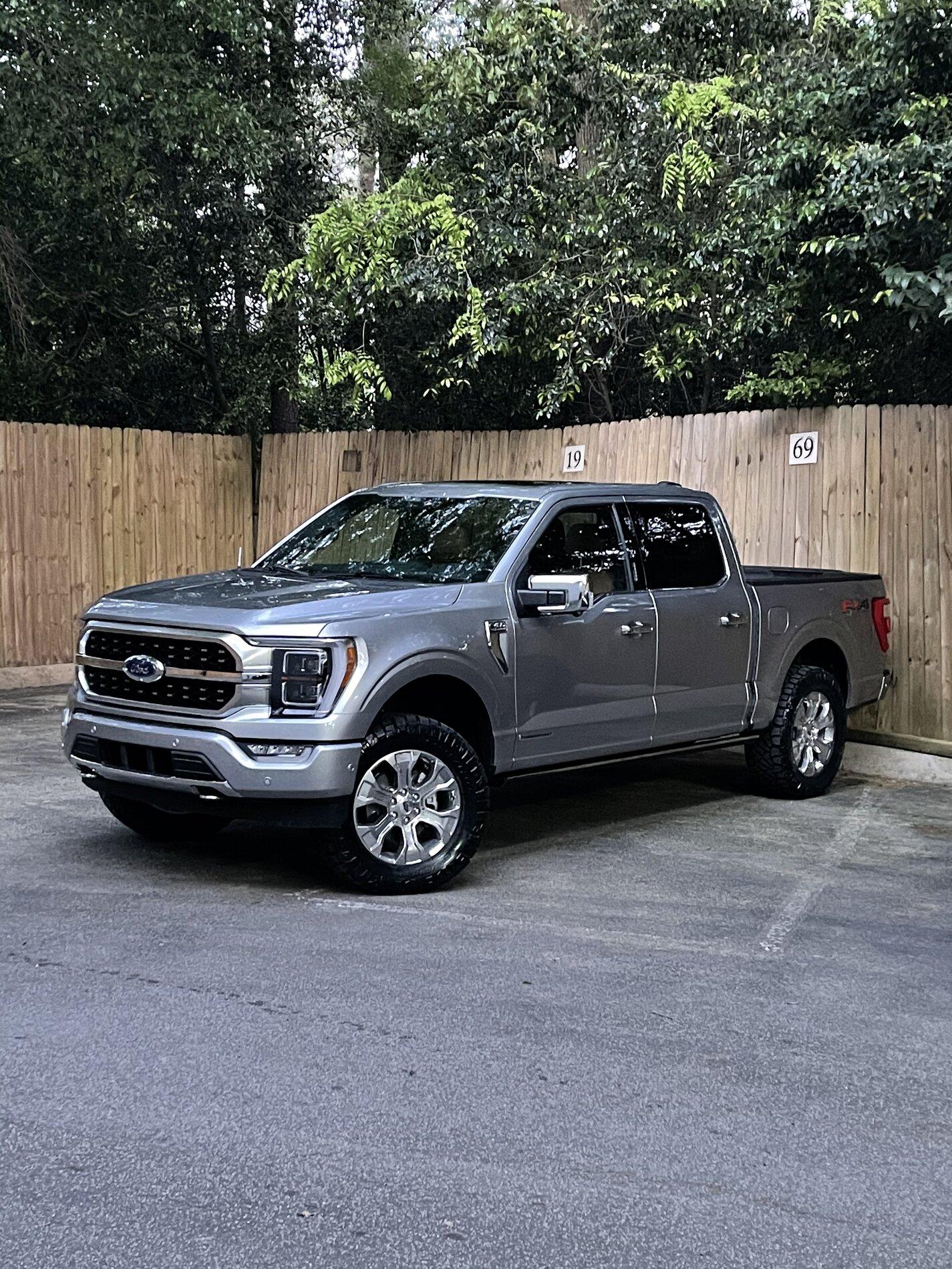

Went with the Rousch kit. I LOVE IT! The ride quality actually improved over stock. Paired it with a set of 295/60/R20 Ridge Grapplers.
Looks good! Any chance you can take a straight side shot with the tires straight. Want to see how the tires fill the wells. My plan is to do the same lift & size tires when I finally get my truck.
