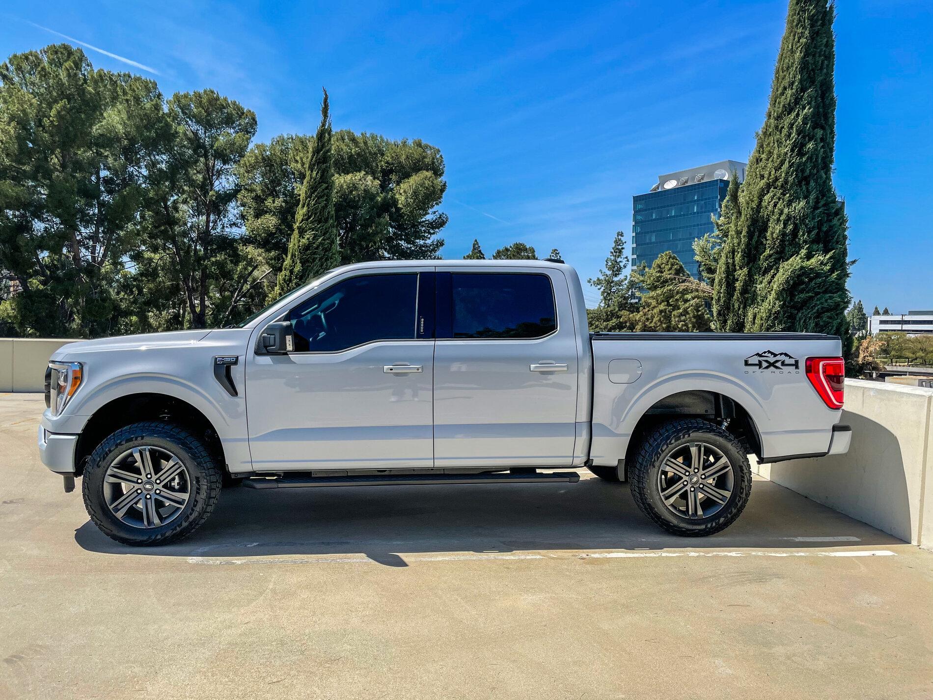

A buddy and I did mine last night. Directions are good. I think it said 2.5 hours. Ours was closer to 3. Had to wrestle the lower control arms back into place which added just a bit of time. We have a lift that helped a lot (small lift, raises entire truck just high enough). You need some fairly large metric sockets. 20-22, a torque wrench and some time. Pretty easy to get to the parts. I will say this. After I did it my truck rode like crap. BUT the alignment took care of everything. Really like it now.
BoxinRN
Feb 26, 2021
Santa Clarita
2021 Ford F-150 XLT SPORT
What did this set run you? Are those the stock tires?
The set up was $1,500 they were the “Ford performance” tuned version. There are cheaper versions by roush out there. My tires are falken wildpeak at3W

I’m currently contemplating the same decision. What made you chose Ford Performance over the Roush alternative?

I got my fox 2.0 suspension kit. Provides a 2 inch lift front coil over and rear shocks.
Really nice looking truck! Curious if you noticed any change in MPG with your tire change?
