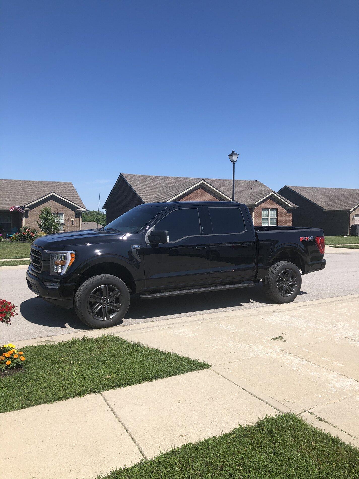

Had my motofab 2.5 kit installed today. Still has about 1-3/4 rake front to rear. Front measures around 40”, rears around 42”’

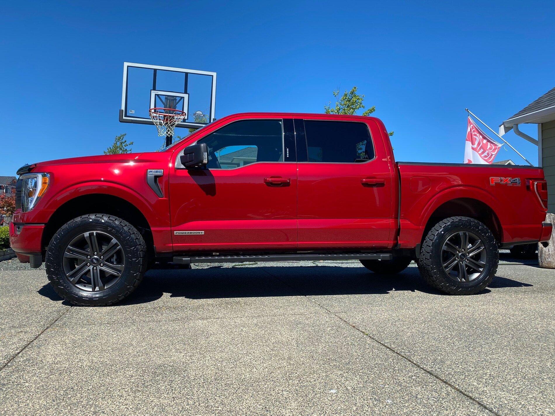

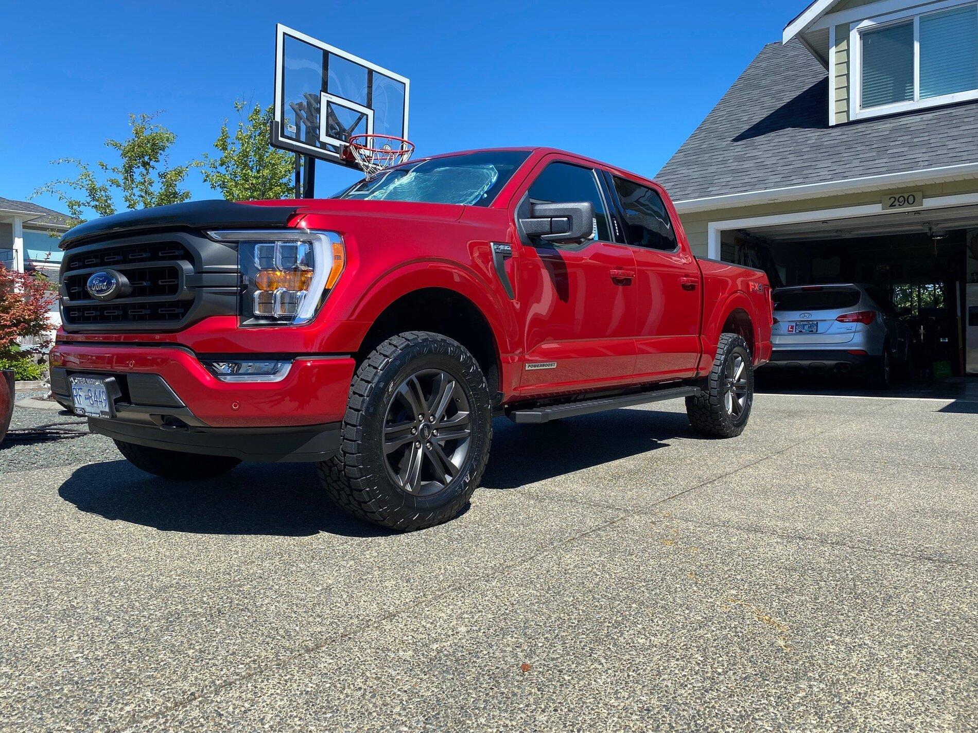

PacBrake Pro 2" level kit....with the added 295/60R20 Toyo AT's. Rides smooth the FX4 upgraded shocks.
