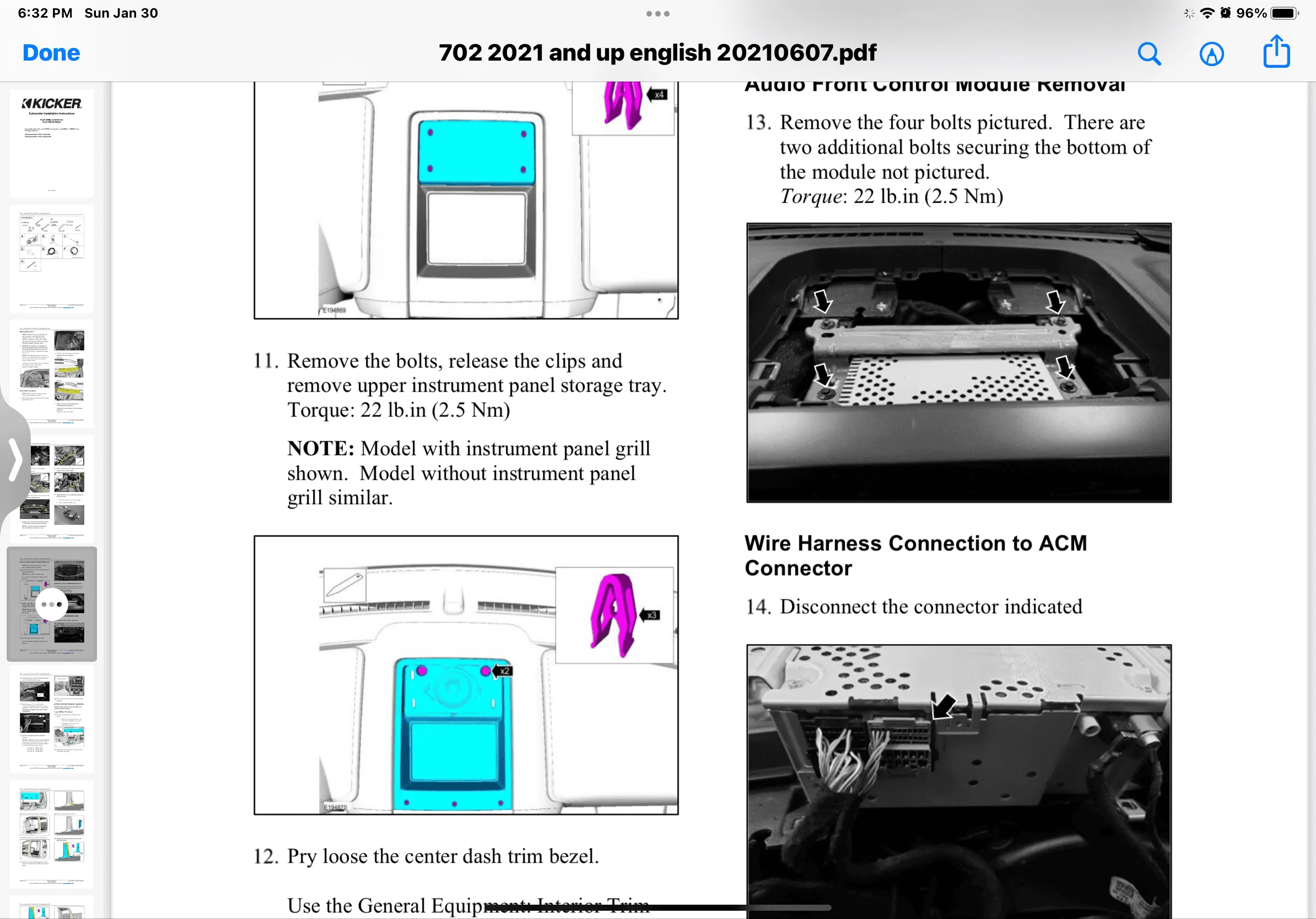

Here’s a top view. I had already got the 4x7mm bolts out to pull off that securing bracket. I was about to use my deep well 7mm socket to get the pair of bolts off from each side of the ACM. From putting my hands along the back, I wonder if the gray plug can be depressed and slid out WITHOUT having to actually remove the ACM?

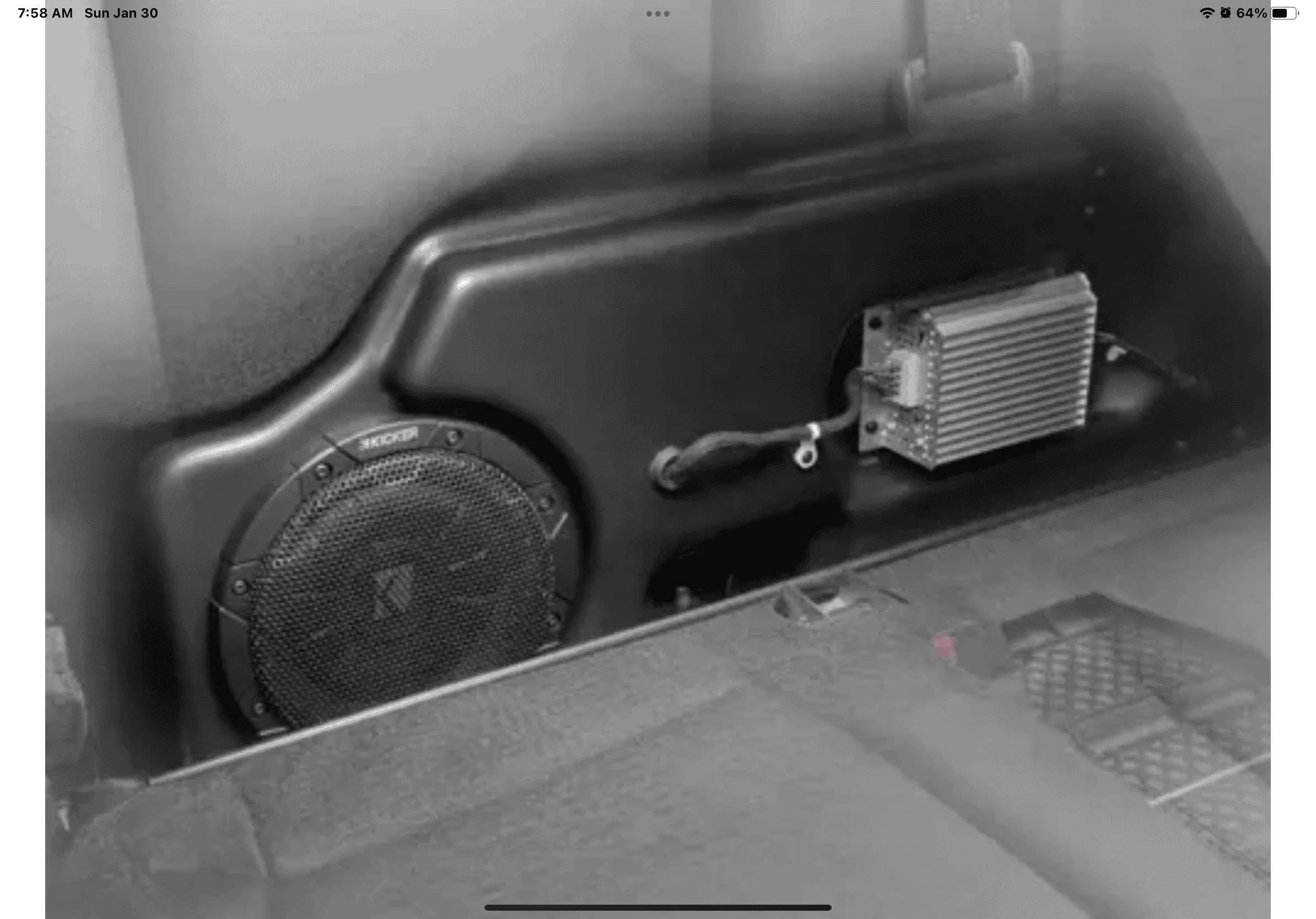

Did you ever get this finished up? Was the upgrade worth it? Did you have the Unleashed system or Non-Unleashed
Yes I installed the subwoofer. It only works with the stock system (no B&O). The dealer programmed it. It’s ok but I think you would be better off with something else. I had the same Kicker Sound stage sub and amp in my Silverado and it was 1000 times better.
It may be from a factory EQ setting already in the F150, that has bass rolloff. The GM probably didn't have it, or as bad. Wonder if you flattened the curve into the amp, it would bring back the deeper, richer bass.?
I’ve tried adjusting all the tone settings and I’ve adjusted the EQ on the Spotify app which helped. I just don’t think the Subwoofer is very good. The Kicker Powerstage set up I had in my 2013 Silverado had a amp processor that went under the dash and the amp that was on the subwoofer itself. That system was pretty impressive and that’s why I purchased this one. This one is better than stock but I’m not impressed at all. It’s pretty sad how bad the stock stereo is especially with all the advancements in products and processing these days
