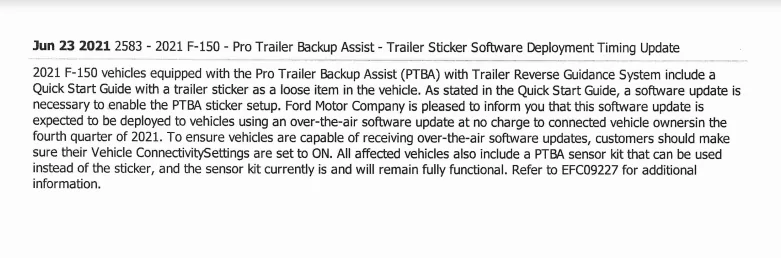

UPDATE: Just got a call from my Ford Dealer Service Department. Ford is FINALLY acknowledging that the issue with the decal option of the Pro Trailer Backup Assist is THEIR FAULT. He told me he received a bulletin from Ford stating that there will be an over the air update to Sync4 going out in December 2021 (not sure why this is a long wait).
That's great news, Tommy. I appreciate you running it down. Longer than we wanted but glad to know Ford acknowledged it. My sensor got dunked at the boat ramp this spring and I haven't had a chance to get it fixed. The dealers here don't seem to know anything about the "PTBA".
"Our bad"
