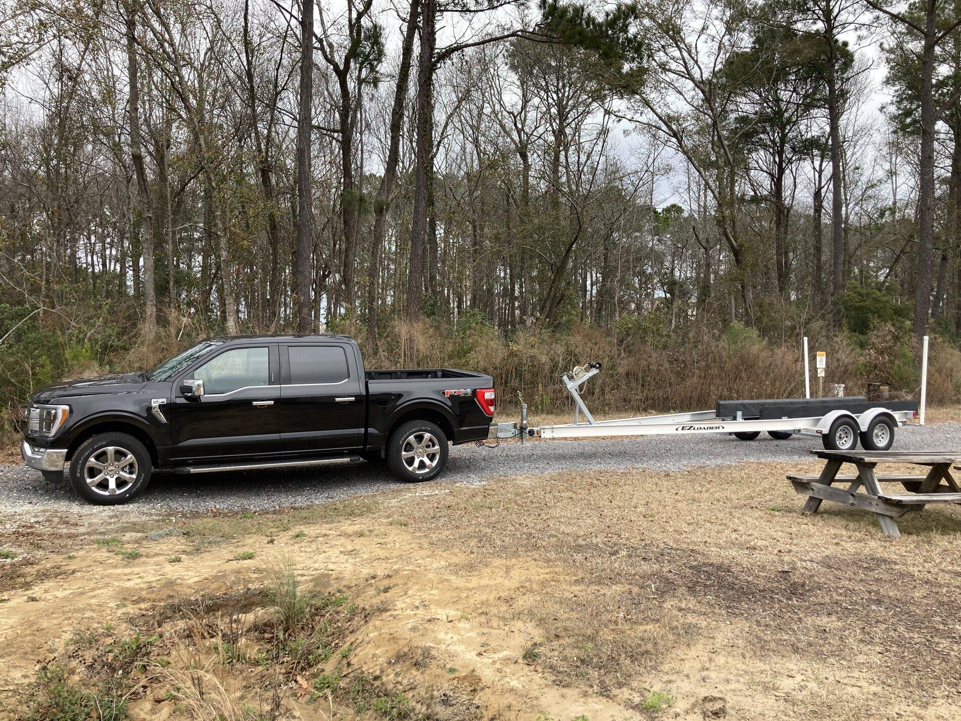

I can show you where NOT to put the sensor. My trailer is ~28' long and I had the sensor just behind the crank post. This worked at my primary boat landing. But got into a situation at a landing in the Keys where we had to back down further pulling the boat out and the sensor got dunked. If I go any closer to the bumper I'll have a ton of slack to deal with. So, when I get it replaced I'll think about mounting it up higher on either the crank post or the winch post. It'll be a little clunky since the posts are either thinner than the sensor or angled. Happy to hear anyone's thoughts. Thanks

Hmmm. I have a shorter trailer - 18 foot boat - but that location you have it in would be pretty close to the spot on mine. I fear the exact same thing that bit you - safe position for all the ramps.
