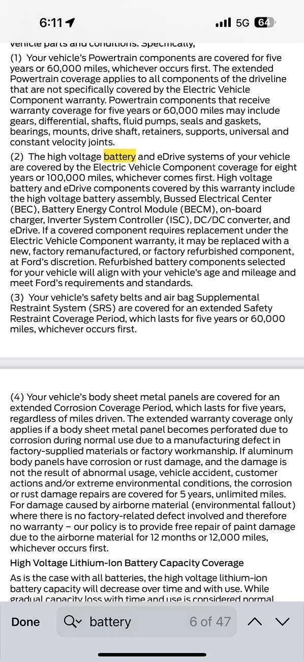

Service tech said the part costs about $2k. I see online sales of the part in the $1,300 - $1,500 range. But, the service tech confirmed that the part and service is covered under the 8 year/100k battery-ev component warranty with no deductible.

I asked what this repair would have cost if it was not covered by the 100k EV component warranty and they said $3k. $2k for the part and $1k for the labor.
I like to share these costs so folks can consider whether an extended warranty makes sense or not. But, if I remember correctly, I think Ford’s extended warranty expressly excludes extending coverage of the EV Components beyond 100k miles.
