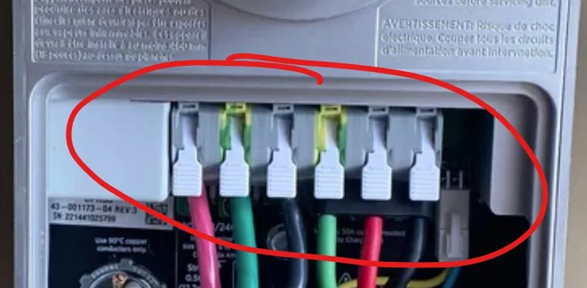

I've had my Chargepoint for about 1.5 years and so far it's been working very well, only once did it lose internet connection and I had to restart it.
The one thing I don't like (and how post is related to the thread) is that they use those tension clips for connections rather than normal screw terminals. Granted, most people don't have / wont use a torque screwdriver so maybe this is their way of make sure the wires doesn't get crushed, but it seems like a source for potential problems down the road.
