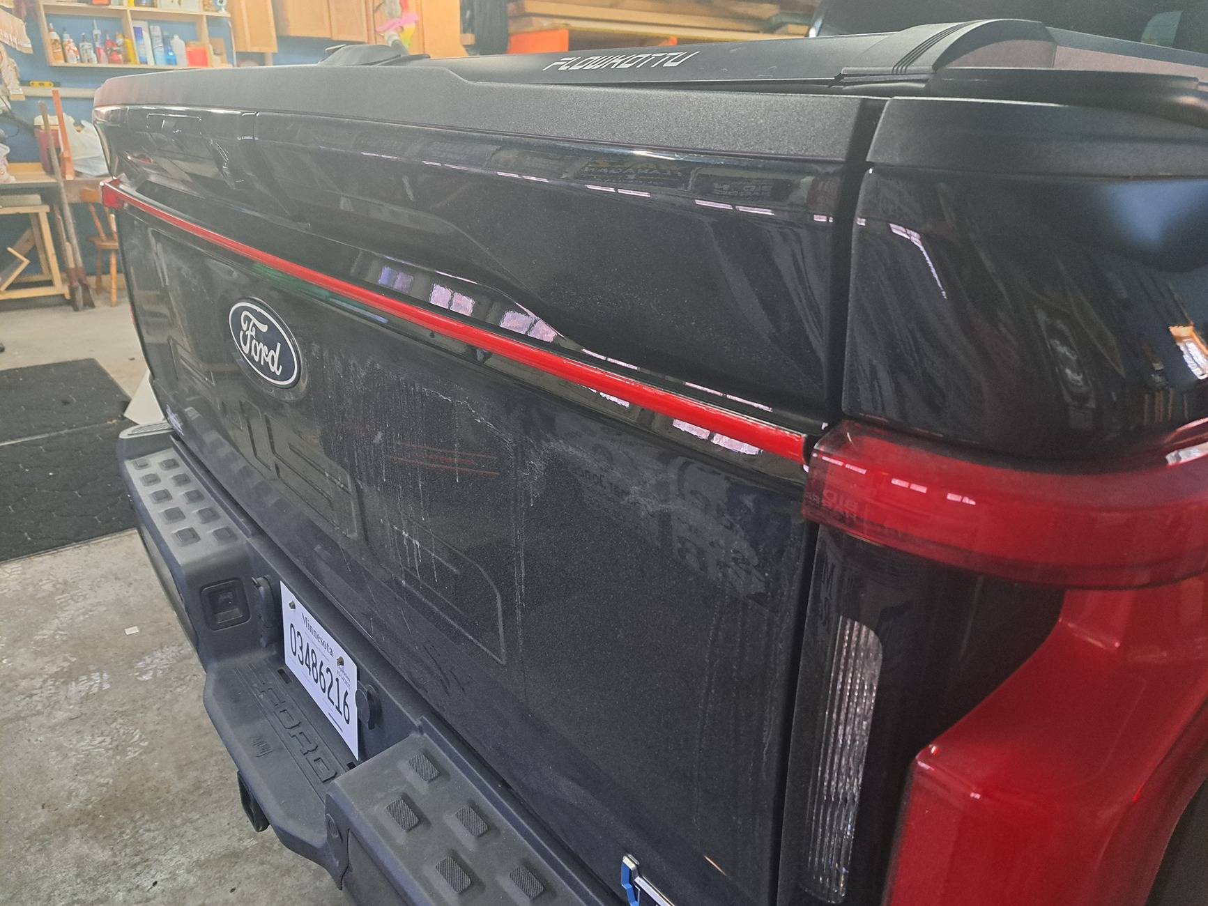

Nah, looks odd that it doesn’t match the dimensions of the taillights. The same type of light under the tailgate looks good. But that’s me, all it matters is if you like it.

Another light could be added and be much closer to the factory taillight dimensions.
I was more concerned with the tilt of that section of the tailgate and getting the color to match.
I was thinking about adding a second but, I thought it would be over powering.
Maybe one strip each would be better but, I am not making two test lights.
My white courtesy lights are underway now.

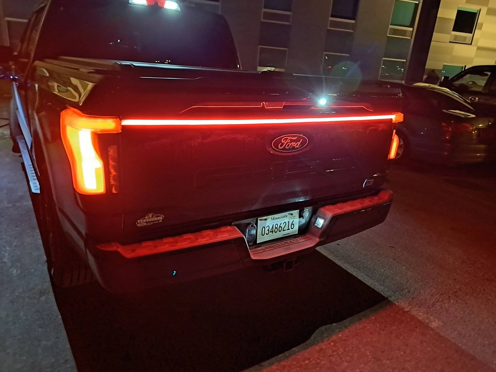

Well, I did it.
My 2024 Flash did not have the EV trademark Taillight to Taillight red light bar.
After a few weeks of research, a few lucky finds, a great deal of trial and error, I built my own tailgate light bar.
After posting on FBook and getting over 400 order requests, I had to walk away from it all.
No holes, no trailer plug, no additional wire runs.
How did it turn out?

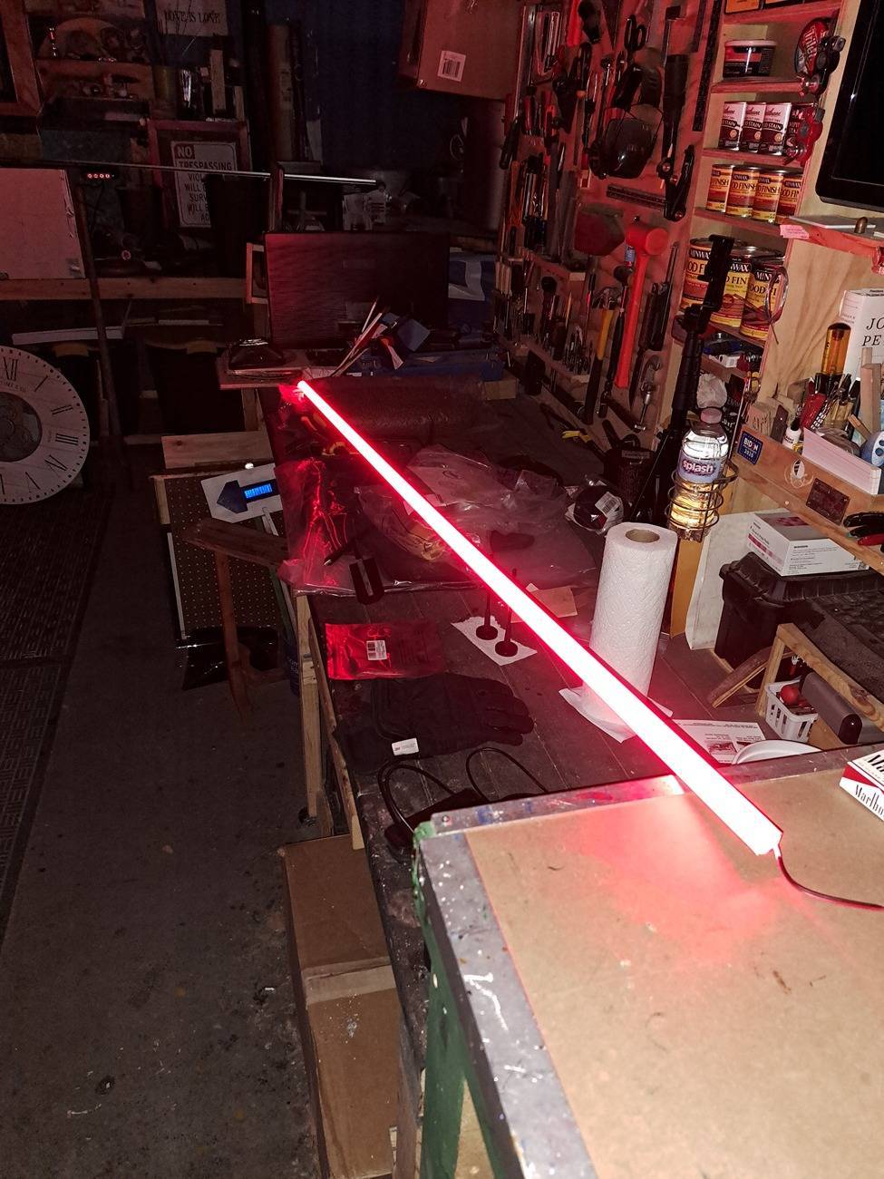

Light Build:
The housing are aluminum led strip fixtures from Amazon.
They are sold in 10 packs only for $60-80.
The right housings are 90 degree corner fixtures with 45 degree internal mounting surface.
The right size for this application is 10mm mounting surface.
Amazon Red LED Strips worked best. 16.5 foot long, 4mm wide, 600 LED per strand and I think each LED was $12-16 with a foot or two of leftover. The 10mm surface inside the housing gives room to double the LED strip, try stagger the LEDs to prevent slightly dim areas.
The housing diffuser is white and after several attempts to match the taillight color.
The best result was standard red rustoleum plastic / wood / metal spray paint on both sides, interior and exterior.
This was determined after several different attempts, powder coatings, filters, tapes, acrylic paints, dips. The white diffuser made the red LED strip a bright pink without treatment.
Now, to match the color of your truck, simply spray paint top of the housing, use tape to cover the internal section of the housing and spray paint the front with focus on the front facing edges.
This will leave one bare aluminum read section.
Once, you spray the internal and external of the diffuser and housing, you can install the LED strip.
Install the painted diffuser into the housing, install the painted end caps with the wiring sticking out of the side port. Then, you can seal the endcaps however you like, used a tube of gasket material and once dry, I applied an epoxy encasing the entire endcap.
When, your end caps are sealed apply a couple of coats over several hours of Triple Thick Gaze Spray. You can find this in most hardware / big box stores. This helps to seal the diffuser and housing along the long seams.
That is your completed light.

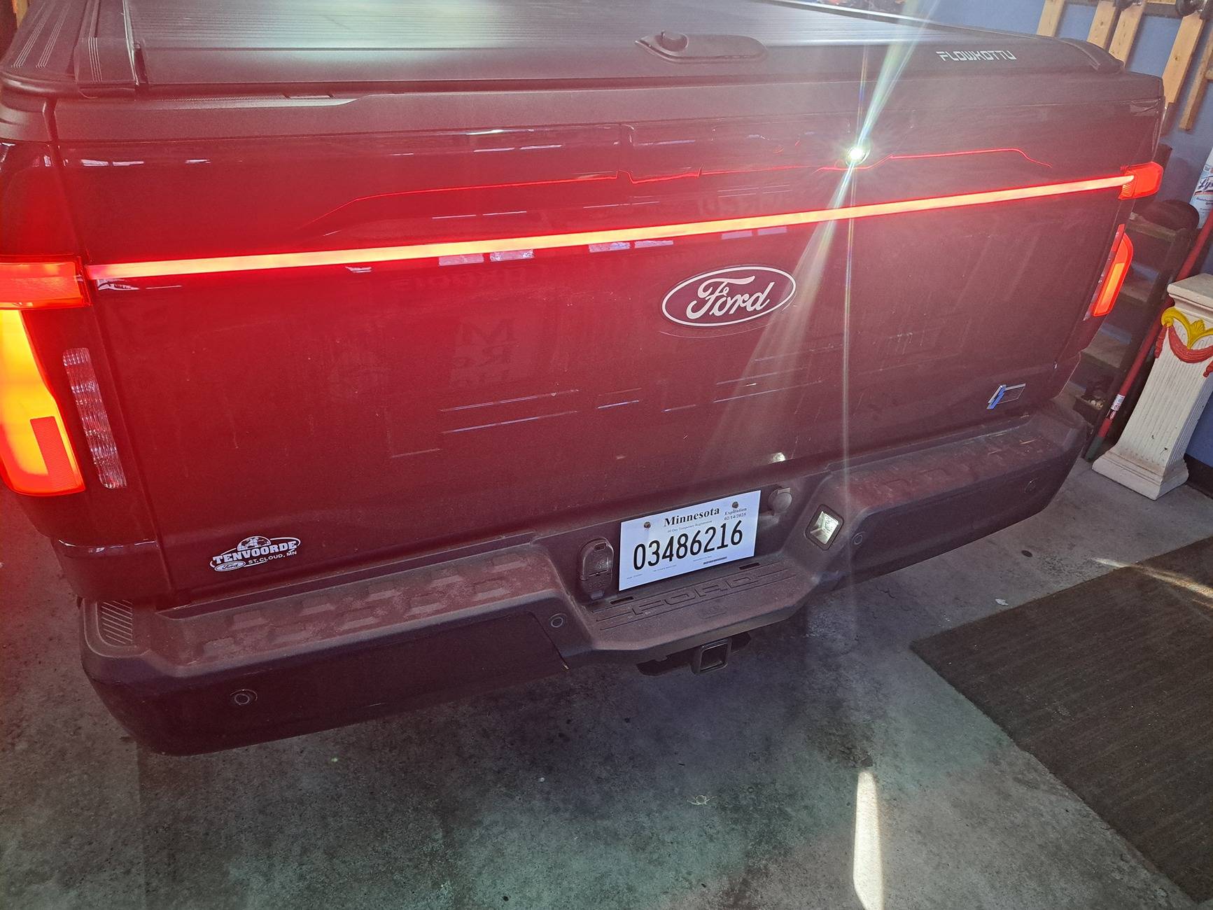

Installation is easy:
On the bare aluminum rear surface, apply heavy weight double sided tape. 1 inch Gorilla tape cut in half roughly works perfectly. The tail gate area between the taillights has a slight curve and tilt. The housing will bend to fit the curve without issue.
Connect longer, roughly three or four feet of wire to each of the light wires (Red and Black).
Buy half a dozen adhesive wire clips, clamps, or attach the extended wire leads to the side of the tailgate and run them down and under the pivot point and down to the bumper mounting structure.
Zip tie, attach the wires to a secure point with a few inches of slack to allow tailgate movement.

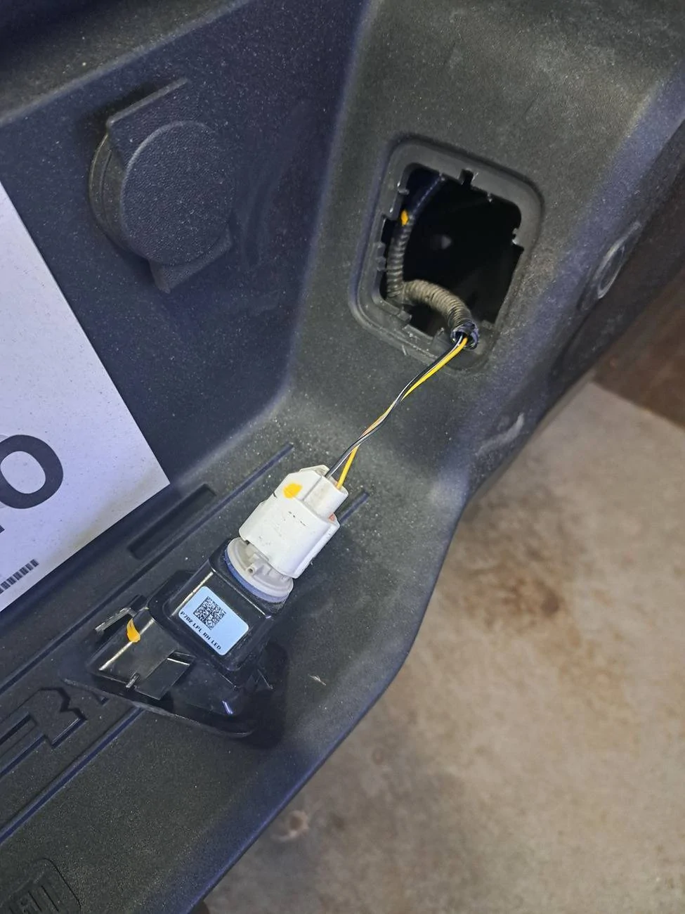

Splice into the license plate lamp wires however you like, pinch splice connectors, bare wire, etc.
Black is ground, Yellow is power.
Black to black and Yellow to Red.
The license plate lamps activate with our running lights, door locks, marker lights.
This method does not impact the trailer plug or register any power load as a trailer.
It removes the need to link into the taillights or run additional light wires or separate controls.
