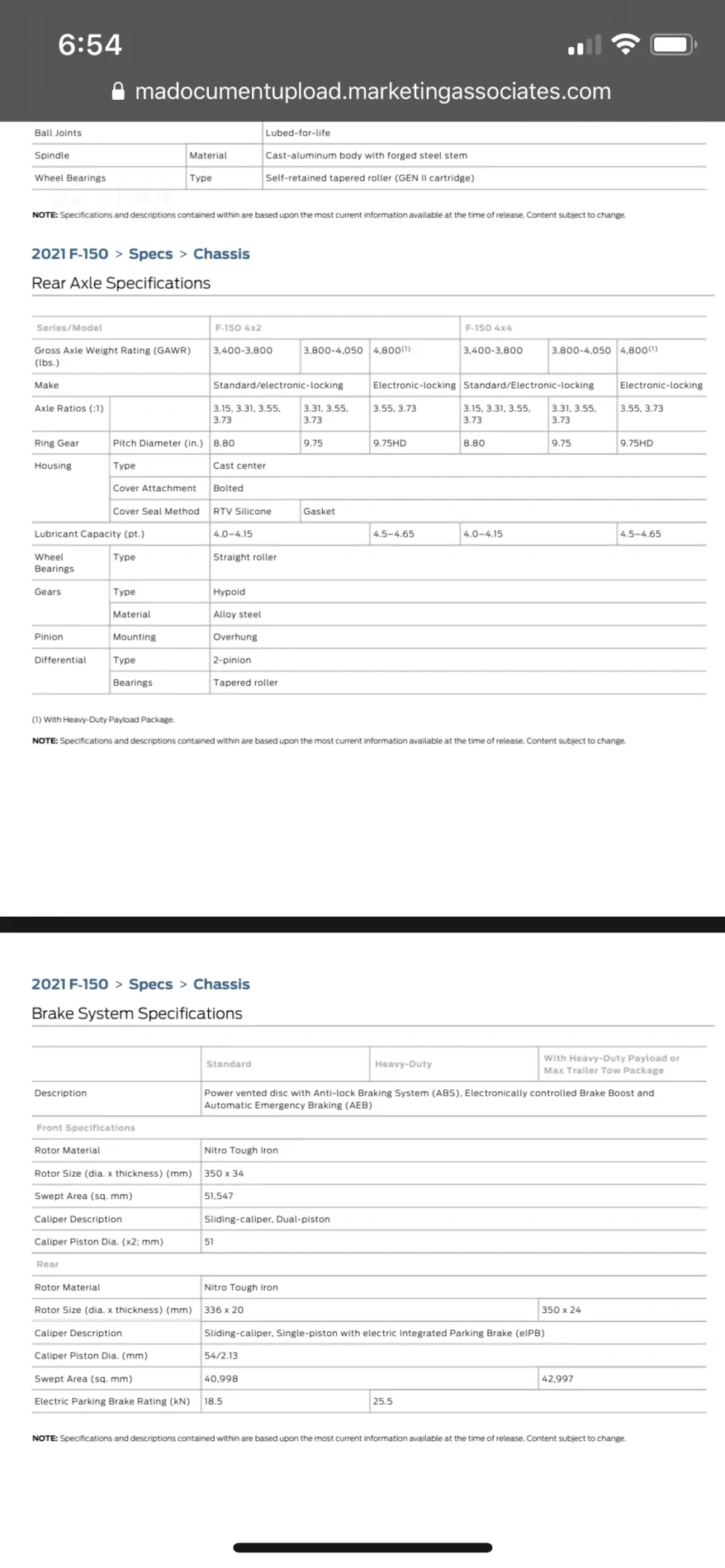

Edit. Looks like the 9.75 Rear axle is on all power boosts.

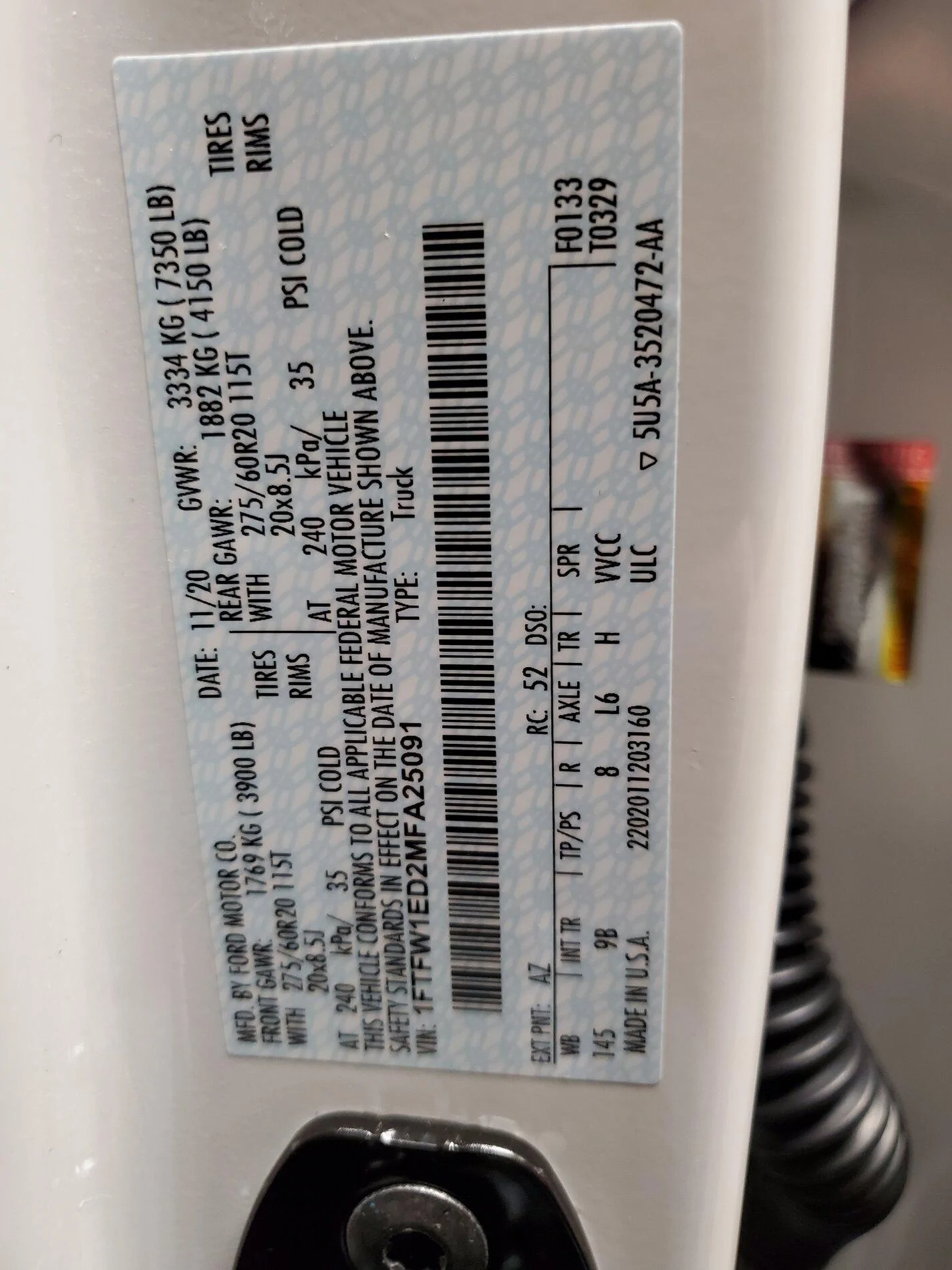

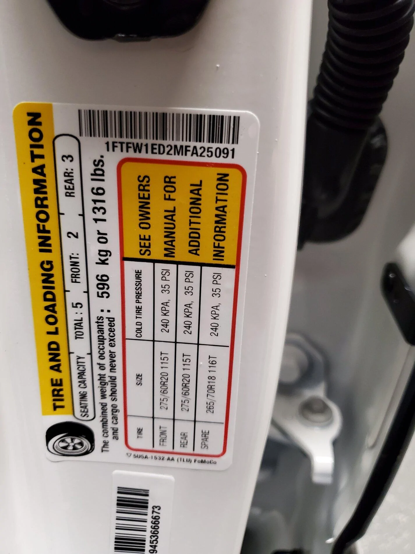

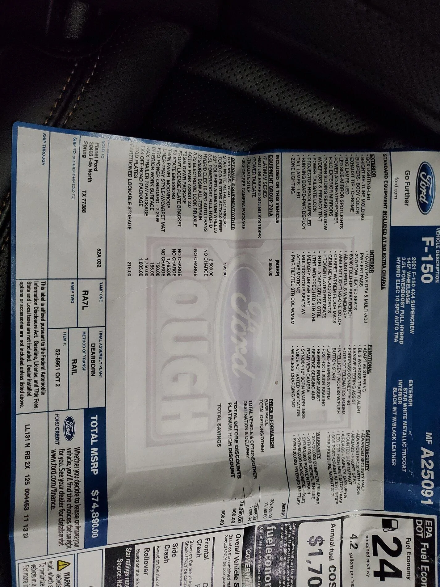

Can you share your windows sticker? I’m getting a fairly well equipped max tow PB. Trying to figure out payload. The idea of towing a 7,000-10,000 lb camper could be out the window with 1300lbs of payload. Barely put the family in the cab...
Ford F-150 Lightning 5,000 LB. max for warranty without tow package? 20210117_191954
Ford F-150 Lightning 5,000 LB. max for warranty without tow package? 20210117_192050
Ford F-150 Lightning 5,000 LB. max for warranty without tow package? 20210117_192043

Yeah. In my case I'm towing a 8k lb boat I'm not going to worry about over loading. Don't keep a vehicle more than 4 or 5 years. I was disappointed in the payload on this one but it drives so good quite, powerful and smoothest ride riding truck I've ever been in. The more I drive the better it gets.
In your case if you haul long distance with camper that might be to much. It's not hurting the truck I personally worry about. It's towing that kind of load the safety of control, braking and sway especially in bad weather and heavy traffic.

Thanks for sharing! I’m less the power running boards, fx4, and the 7.2kw. Probably nets me close to 1400lbs but I’ll have to hope.
Seems like max tow makes it less. Not sure if running boards will do that much differently.
Should be about 30lbs for skid plates and 30lbs for power running boards. Who knows that might be the only delta.
