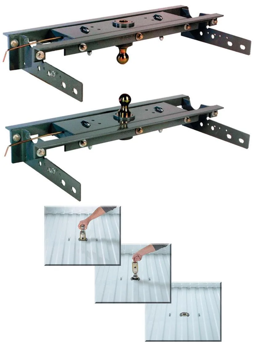

On site now (May 10, 2021): https://www.bwtrailerhitches.com/kits/gnrk1121
GNRK1121 Fits:
2021 Ford F150 - Except Raptor
GNRK1121 consists of two boxes: GNRM1121 weighing 44 lbs. and GNRC900 weighing 42 lbs.
