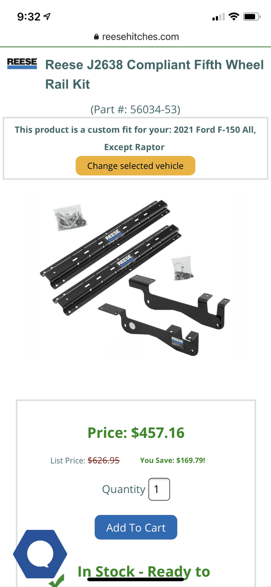

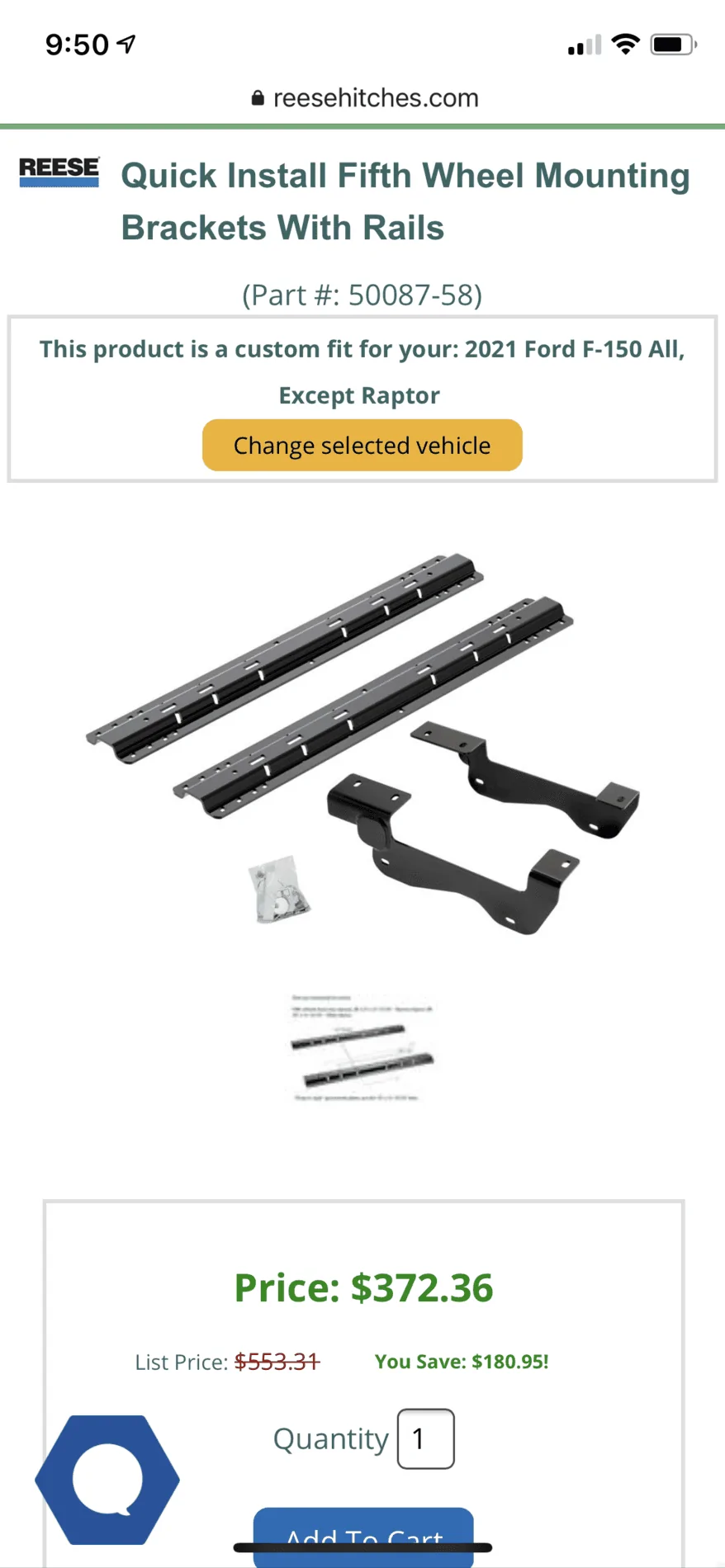

It looks like Reese may have a rail system that works for the 2021 - PB and all models except Raptor.
Ford F-150 Lightning 5th-wheel hitch fitment compatibility with 2021 F150 Powerboost E88F0375-546A-41E7-9F27-CFE90583B3E5
Ford F-150 Lightning 5th-wheel hitch fitment compatibility with 2021 F150 Powerboost C02CB7C9-A7F5-45AD-A315-14AD40C59615

Thanks a lot! Do you have an idea what difference between the two is?
sumosumo
jack
Mar 2, 2021
southwest
2021 F150
. i'm not positive, but I think the main difference is in the grade of the hardware. The cheaper one is grade 5 and the more expensive one is grade 8. I was skeptical about whether this would work for my 2021, since it's the same kit that works for prior model year F150's. However, after watching some installation videos from etrailer and taking a good look at my truck frame, I'm pretty confident they will work.
