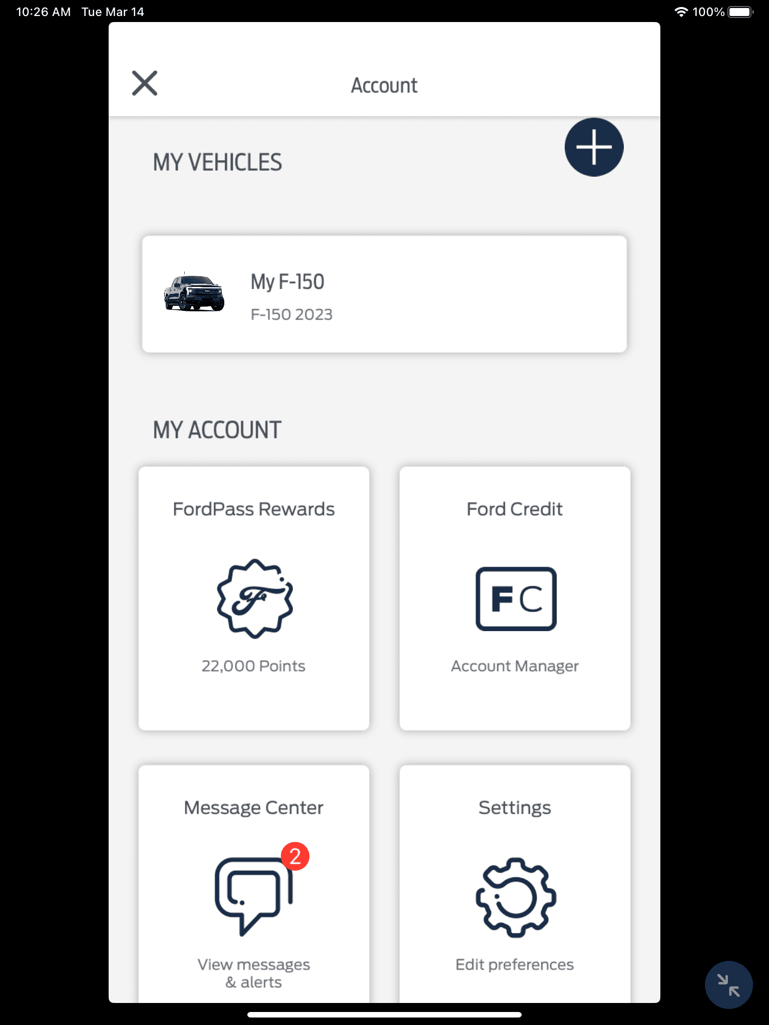

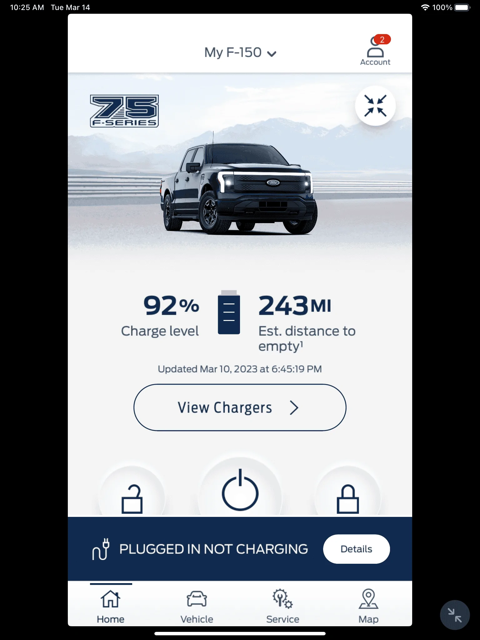

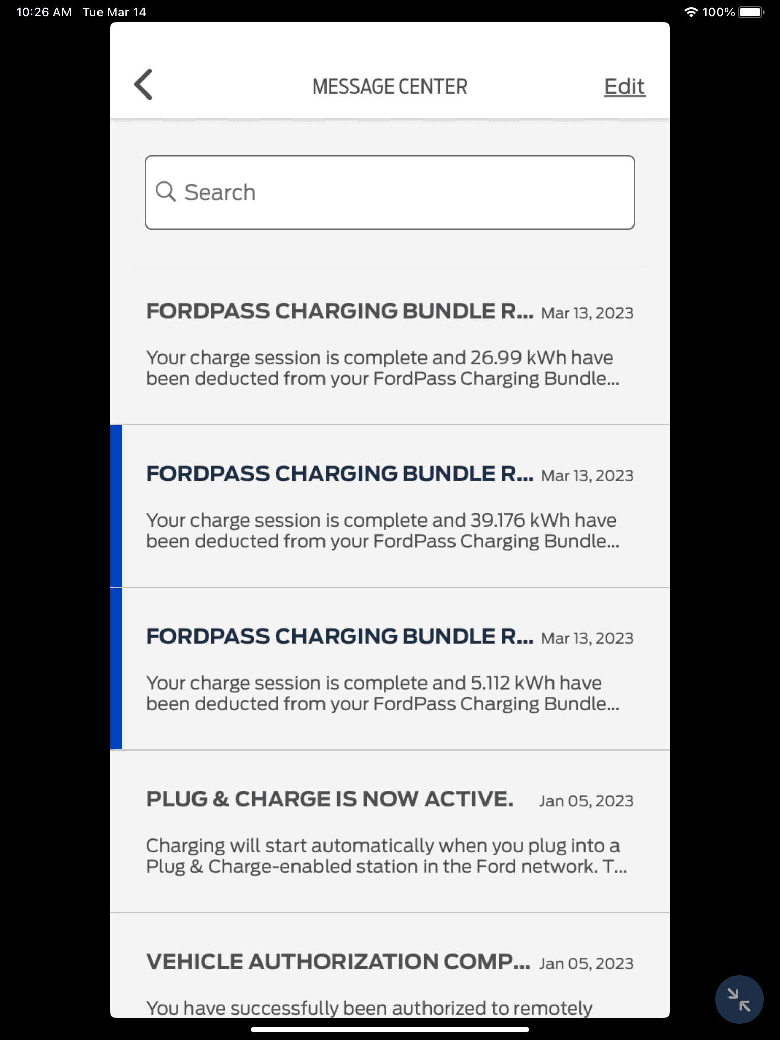

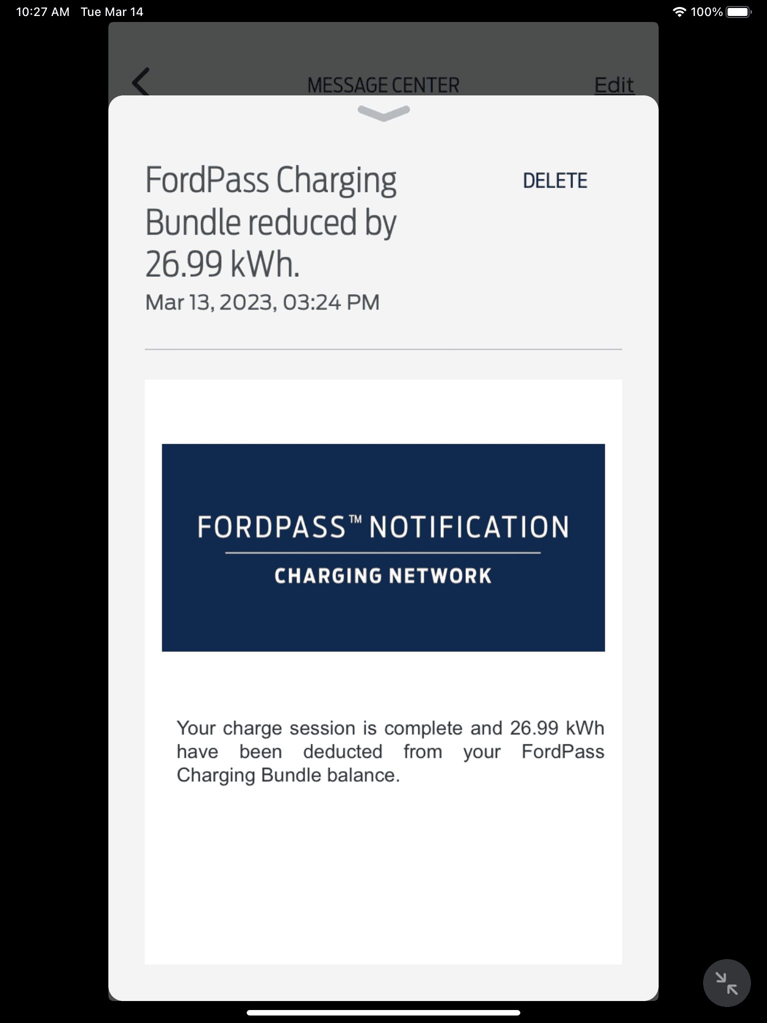

I knew it was the modem or related system, but I’ve been on a trip, and can now prove it. My modem crapped out on March 10, 2023. Typical, nothing special. any of use in the build period from early November to mid/late December experience this all the time. We all know the remedy, battery cable or fuse 32. This time I decided not to do the fix, not really for this test, this just came to be known by accident. My plan was to drop off at dealer after the trip (I’m still on it) and start the clock. What is interesting and proves the point are my images that follow. I received a notification on top right, which shows a message from Ford. Clicking through the links, which I share, you can see that my account received information of a charge (using the Ford App, not EA) and reporting the charge event to and through the FordPass App. Which means the App itself is not broken. It does communicate. The broken part is that truck itself isn’t communicating. But more importantly it is not communicating through the modem only. CarPlay works, Bluetooth works, satellite works. So the loop in the example below is that (1) I connected the truck to an EA station and the truck exchanged proper protocols (not modem) and then (2) EA station connected to FordPass App (Wi-Fi) and FordPass/my credit card but I’m still on free volts. The truck never communicates via the modem at this point, it knows only what is provided through the direct connect to the station such as connected/disconnected and charging. Unfortunately very little detail is displayed in the actual truck. EA station has more detail, such as energy delivery amounts and rate. What is interesting is that although my FordPass App has no idea anything has happened in the last 4 days, including charging from the truck, it is aware directly from Ford that I have been charging. Ultimately, meaning the FordPass App works but only can process or display information from which it receives. In this case, since the truck can’t share the information it has, it cannot be shown in the App. That is where the loop breaks in my case study.

I had a similar experience. I was returning from a trip on a Sunday and on Monday I checked to be sure it had charged overnight. FordPass still showed my truck at my brother’s house about 80 miles away. I decided to leave it disconnected and I scheduled service with the dealer. On Thursday I got a notice on FordPass that it had finished charging. I looked and it showed me at the EA charger I stopped at Sunday night. I got a few more notifications and then it showed me at the correct home location. That’s the first time that it has recovered on its own. Those messages were stuck somewhere all week, I assume queued up in the truck. I wonder if there is something about certain messages that hang the modem and after some period of time old messages get deleted allowing the communication to resume.

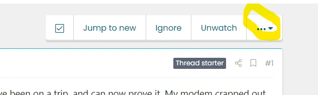

As the OP of this thread, you should have an option to add a poll, if not I can add it.
Let me know in a PM if you need help and what you want the poll to ask and what options.
