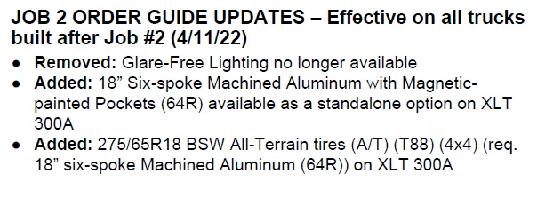

In another post this week a new Order guide was posted and it looks for the ICE versions the truly Adaptive lights may be gone there too. So I'm guessing supply chain issue perhaps or just a cost cutting measure, who knows.
This is from the Canadian 2022 F150 ICE order guide and confirms removal of glare-free lighting for Job #2. Glare-fee lighting is not listed in the most recent Canadian Lightning order guide, so I doubt that they'll have them.
There's still a chance that the hardware will be there and it can be activated via ForScan--this seems extremely unlikely.
