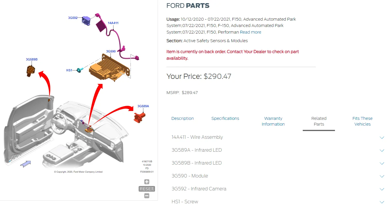

Gotcha, My diagrams only show one camera. You have a diagram with the 3 cams going to the CMR?

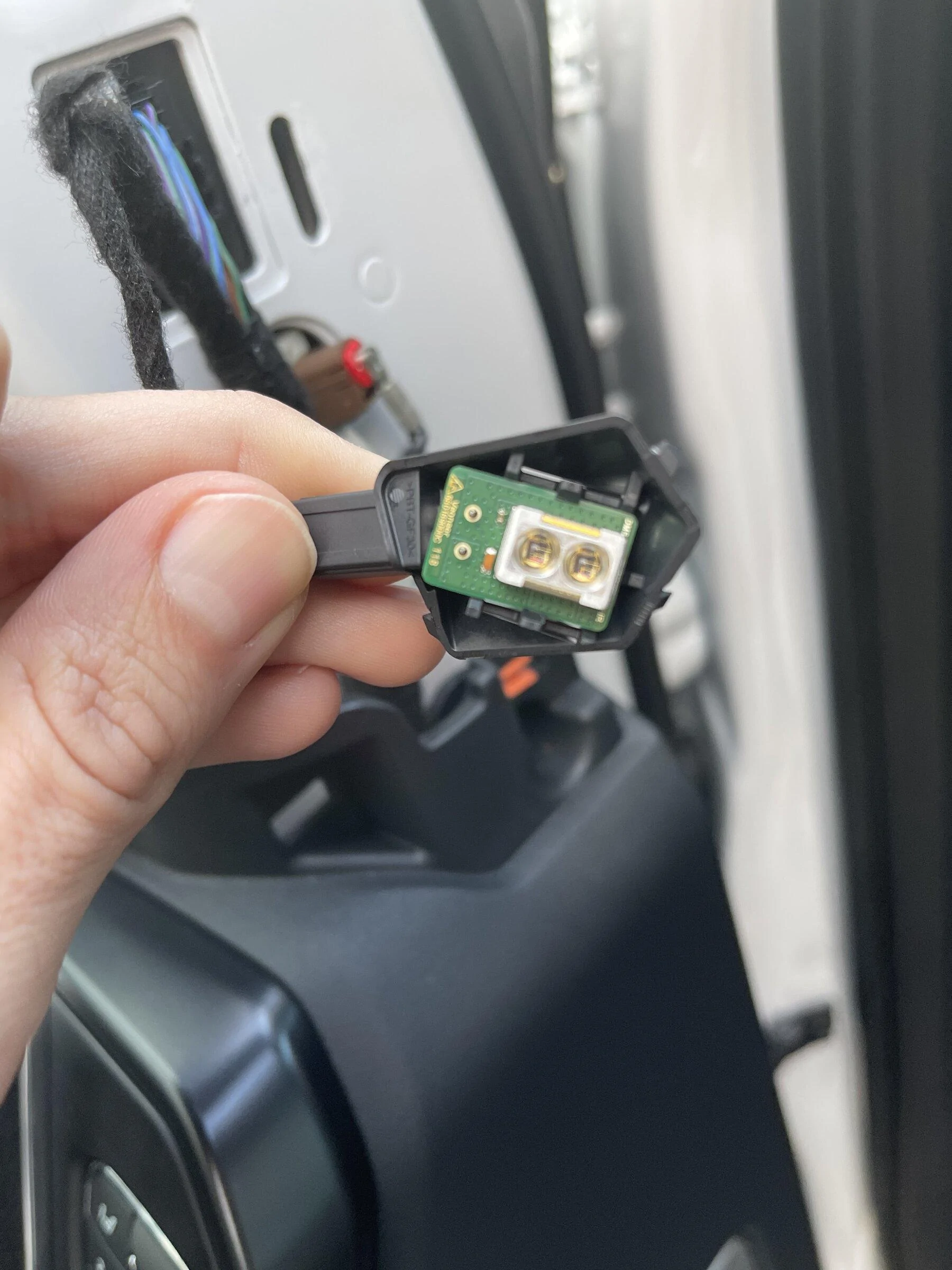

That’s the diagram with three cameras. They are IR cameras.. they say led but they are cameras none the less
These are not cameras. They are IR LEDs. I cant find anything with more than the (1) camera going to the CMR. Only reason i ask.
Ok man.
