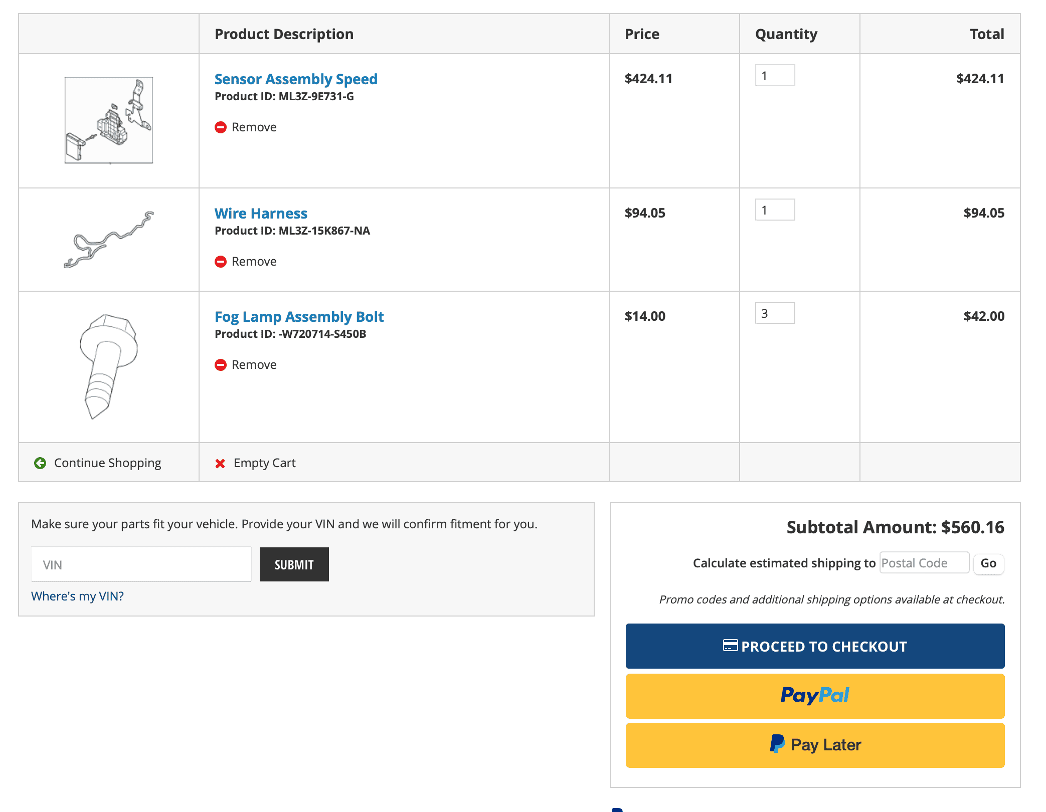

From what I've gathered, we need the following to make it work:
Sensor Assembly: ML3Z-9E731-G
Mounting Bolts(3x): W720714S450B
Wiring Harness: ML3Z-15K867-NA
The total cost is just under $600 from most ford parts shops. l've very tempted to pull the trigger on this, but a bit nervous as I'm not sure anyone with a lightning as attempted to retrofit that sensor.

So steps are:
  • Buy parts
  • install parts ( should bolt right on )
  • Program via FORscan
Enjoy adaptive cruise
my wife’s Escape has co-pilot and I covet it greatly

So steps are:
  • Buy parts
It seems like this is all we need to do. My biggest hesitation is installing the parts and removing the front bumper trim. I've done this plenty of times on my raptor, but there are far fewer wires/sensors. Also the raptor gets beat to hell off-road, so you'd never notice if I scratched anything...
