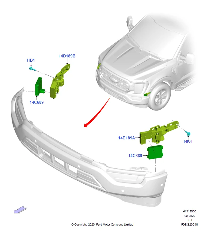

I added the ccm and the front two side obstacle modules which are the same part number as the two rear bliss modules in the taillight.

I’m guessing you thought you needed the bumper and sensors? The sensors are only for the parking distance and there are two versions. One with 4 and 4 and one with 6 and 6. The 6 sensors have the two on the side front and rear for the automated parking. They have no impact on the cruise control.

No, I added two bliss modules up front behind the plastic piece under the headlamps. One on each side and the ccm on the driver side behind the plastic piece of the front bumper. I only have the 4 rear parking sensors that came with the truck I don’t have any front sensors. Only reason I knew it was possible was because there are lariat trims the same way no front sensors and adaptive cruise.
What I wasn’t sure about was the lane centering. I thought possibly the front sensors in the bumper on the sides were needed for that in addition to the bliss modules but they were not needed
When I programmed it today and went to see if it worked it worked perfect without and I had lane centering.
I had a chance to test on the drive to the party which is the only reason I went. It worked great ..
I got away with only the CCM and two more bliss modules and have full adaptive with lane centering and stop and go. I’ve tested it all. The speed sign recognition even works perfectly.

Hopefully since its labeled as Parking Distance Control, it's only for parking assist it has nothing to do with ACC or lane centering. I came to the same conclusion doing the same looking around, saw higher level lariats without the 6 front parking sensors with ACC so knew it must work without them.
Where do these two bliss sensors send their signal back to? The IPMA?
When I read through the theory of operation on ACC with lane centering in the service/tech manual. It didn't reference these two front bliss sensors at all if memory serves me right, so that's why I didn't even know about them until now. I think it just relies on the CCM, windshield camera, and IPMA. Maybe there was an additional section adding stop & go to those as well and that's where these sensors come into play, but maybe not. But in your case I would have to bet they are needed for Blue Cruise so better to have them for down the road then not.
Thats awesome you got it working as easy as you did and that's my end goal as well.
You could be right they may not be needed. I decided to try with them since I had to run the wires I didn’t want to have to do it twice.
After driving it tonight it seems they aren’t used. I don’t know really. They do run to the ipma.

I wanted to add about the name they use for those park distance sensors.. ford seems to name things whatever . These are the exact same parts used in the rear for bliss.. so they could easily be called something in regards to that.
I was driving home tonight and it seems the centering kicks off same as lane keep did if the lines go away on the road you’re on.
I will look at the workshop to see what all is used but right now just don’t know. I know I don’t have any error codes or anything saying missing sensor.
They may be used I conjunction with the sensors but the cars with park assist have the six sensors rather than just the 4.
The other reason I thought they are used is if you pull a lariat with the ACC they have these parts in them.. so why would they have them if they aren’t used and don’t have park assist? None have park assist that have ACC and no front sensors.. so who knows.
Maybe I did too much work but my logic was the truck had it I needed it. I basically pulled the vin and saw what parts it had and got them. Ford isn’t exactly known for putting extra parts in for nothing. They won’t even run an additional wire most the time if the truck isn’t equipped.

Strange enough, I lookup parts for my 501A Lariat VIN, and it shows these front bliss sensors in the list, so maybe I already have them?? I don't recall seeing them when I had that front plastic piece off a while back trying to mend things from the deer incident, but I guess I guess I wasn't looking for them either so might have looked right over them. Why I'd have them already but no ACC, park assist, trailer backup, etc. would baffle me.
I meant to tell you back when I scored my CCM, I looked around my truck and it's already wired for it from the IPMA all the way to the front bumper connector. So all I need to do is replace the front bumper harness with the correct one and I should be good there I believe, so got lucky there if it ends up being that simple.
Man.. thats a slam dunk if thats the case. I have to be honest.. the 21 they have done some weirtd things. Like the middle body harness has a lot of the wiring then its just not ot the final destination.
If thats the case then there are several guys with lariats that are going to be thrilled about htat news. One guy was mad he had a lariat and no ACC<
one thing I mean to add. They may be there and not needed for ACC or lane centering and may be for something all together different. I did look at the workshop and it doesnt show them. It just says it uses radar and camera. I cant find any clear cut explanation of what they are for.
You may have them. If you do then thats good. Hell if you say that plug is there then I am almost sure either they are there or the plugs are
