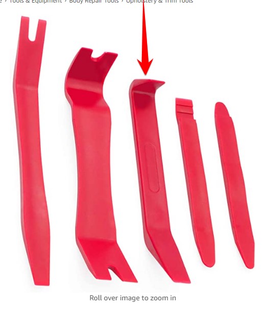

Again, very helpful - thanks for the quick response. As I don't yet have any trim removal tools, any in particular that you would recommend?
I was able to do it all with the tool shown below and you can get a set of them cheap on Amazon.

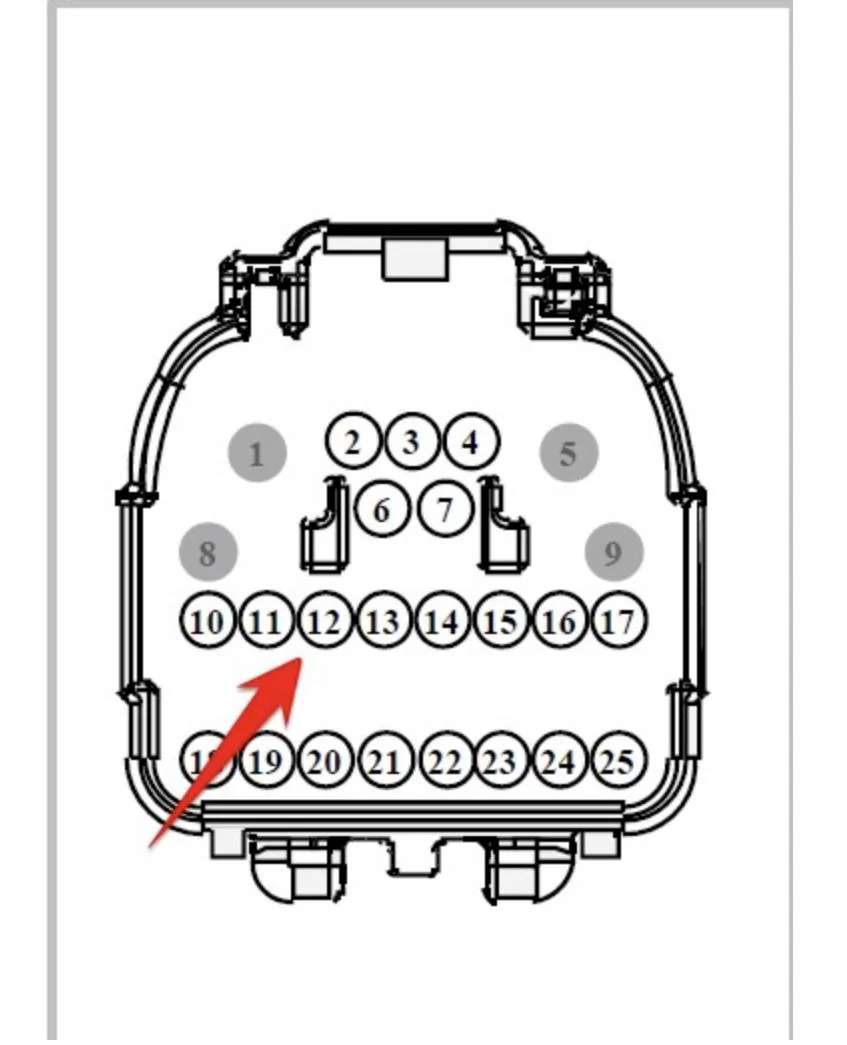

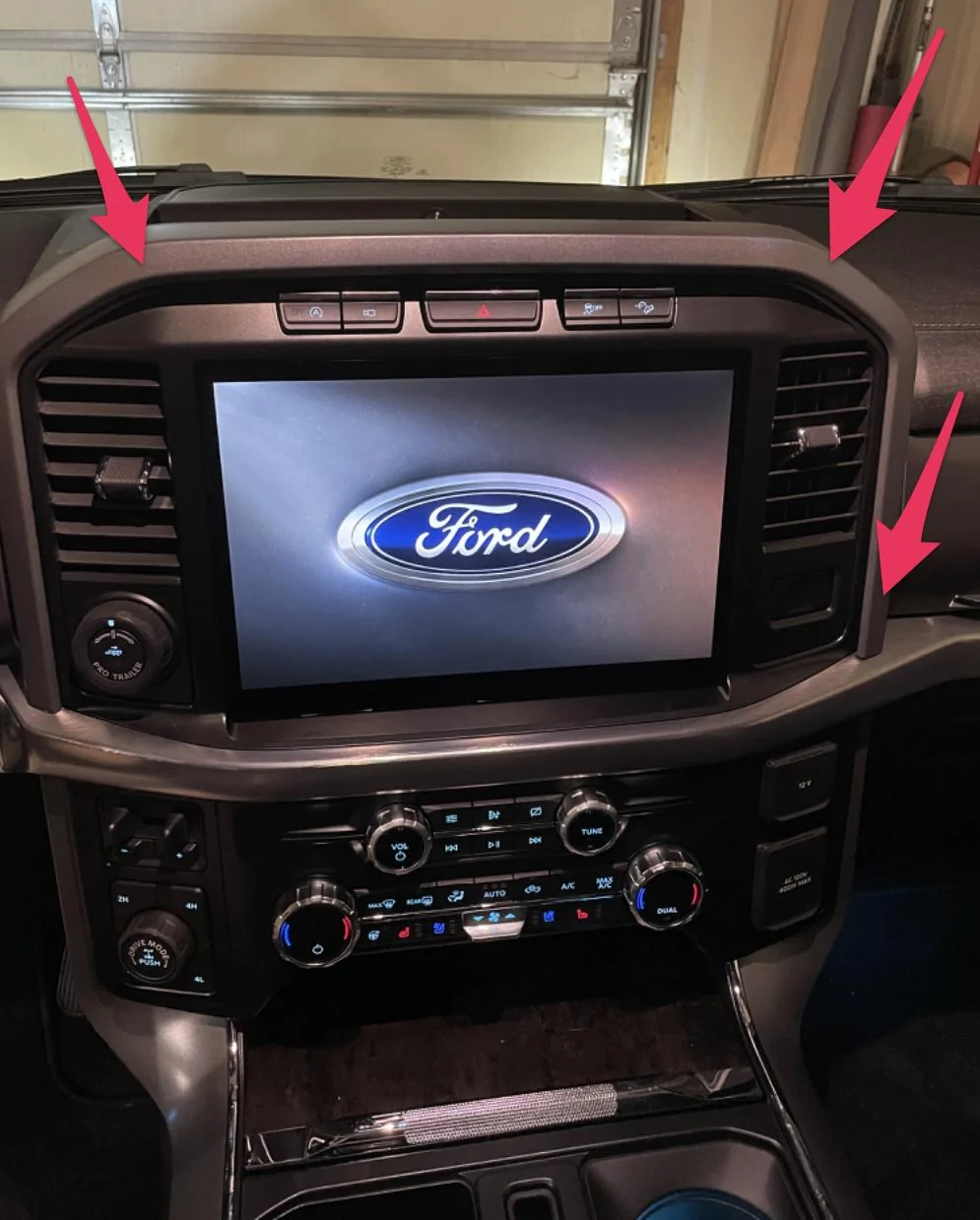

Thank you for all the help, job complete and it works, well at least it looks like it works in my garage. Here are a couple of notes. It took about 2 hours the first time I took the dash apart and installed everything. It only took an hour the second time (more on this later). I have a Lariat with 502A package and the trim removal was slightly different. The trim pieces pointed to in the photos below need to be removed. The one surrounding the touchscreen needs to be removed before the the long horizontal bar that goes from the Push to Start button to above the glove box. Lastly, I misunderstood the third image as being the front of the plug, not the receptical, so I placed my jumper wire in the wrong slot. You are looking at the receptical opening or the back of the plug. And finally, I had some errors with the FORscan entries. I was unable to save the IPC 720-10-01 entry no matter what I tried. This is because I had already changed the ABS 760-03-01 and ABS 760-04-01 entries. Once I returned the ABS entries to stock values, I changed the IPC value, then the ABS values. Everything worked.

If you already have the correct wire there then you should also have it in the top connector for the switch so if that's the case then just plug the top connector into the switch and make the ABS change and test it. My non-FX4 Platinum didn't have the HDC wire at all from the switch to the inline connector.

2. Terminals for HDC connector C2304 - pin 4 (female) and inline connector C214 - pin 12 (female) located behind the A/C controls. The Ford part #'s for these terminals are WT1001 & WT1002. These two terminals can be spliced/soldered together and end up being a good length to reach from C2304 to C214.
