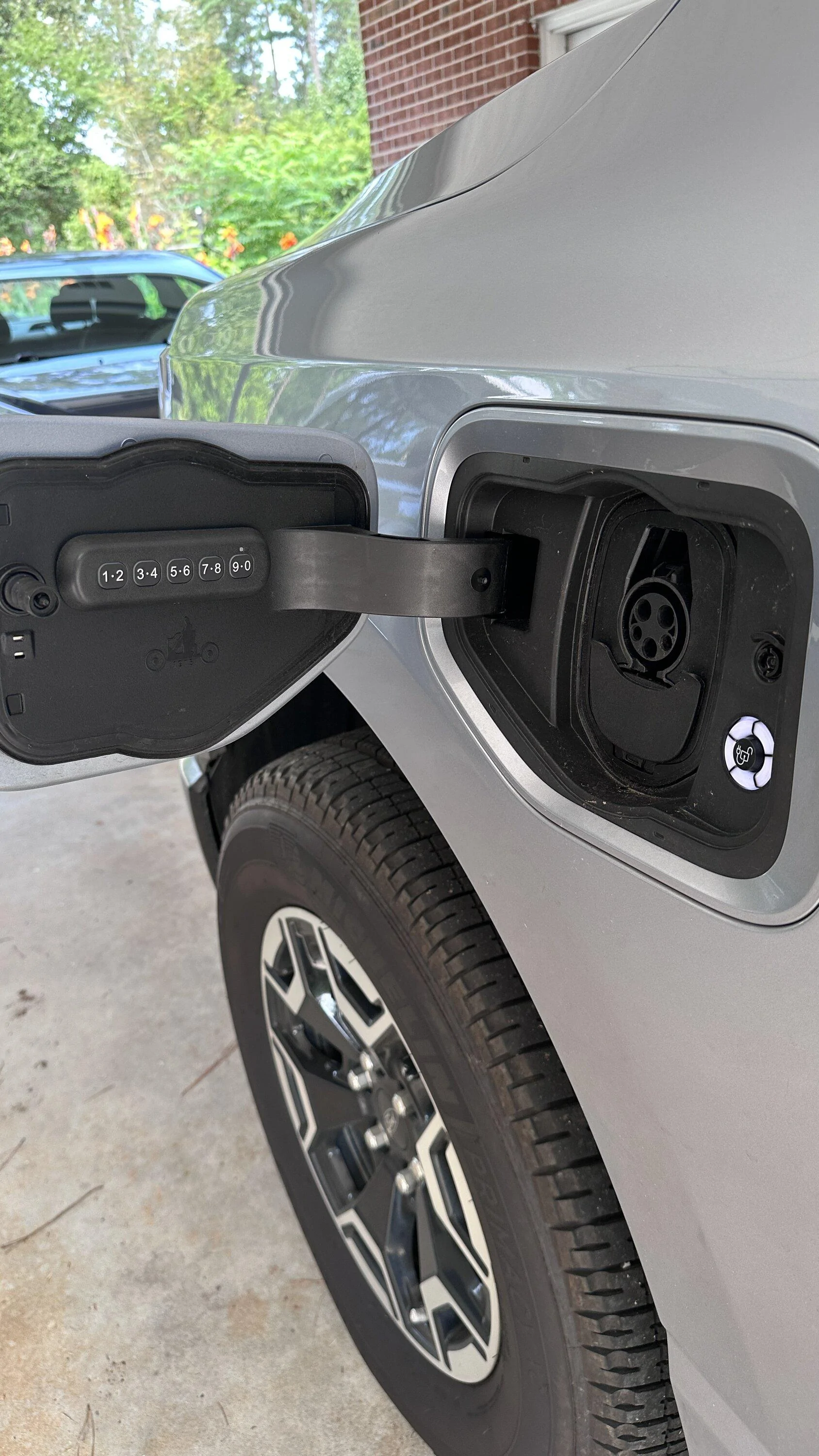

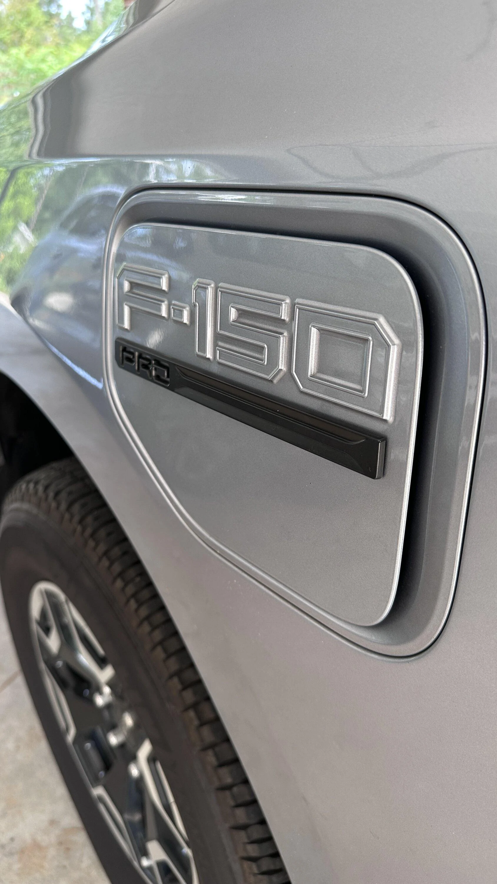

The keypad comes with it's own mounting tape, but I used a 3m 'removable' mounting tape instead, and it's holding it pretty well... there is also plenty of 'space' for this keypad, even with the Chargeport door closed.

Looks great. Thank you for the pictures.

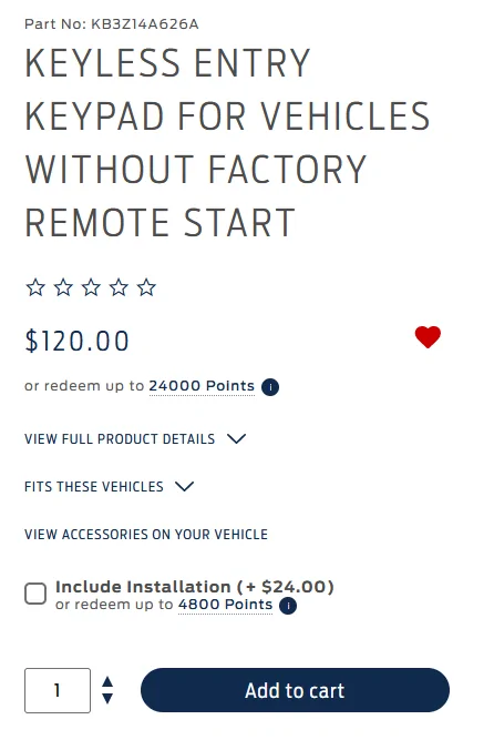

You said the dealer wanted an extra $100 for the programming, shouldn't the installation option cover that for $24? I sure hope they wouldn't charge you that much just to apply 3M tape, but then again that sounds right up Ford's alley.

I'm attempting to order this ( A version) with installation, I'll see what the dealer says.

I didn't have the dealer 'install' any keypad, I only had them PAIR it to my truck(keyfobs)... it's just a programming change with their FDRS software... you can attach the Keypad anywhere and anyhow you wish.... mine is in my ChargePort door. Yes, they charged $100, probably because that is the minimum charge, and probably the hourly rate.

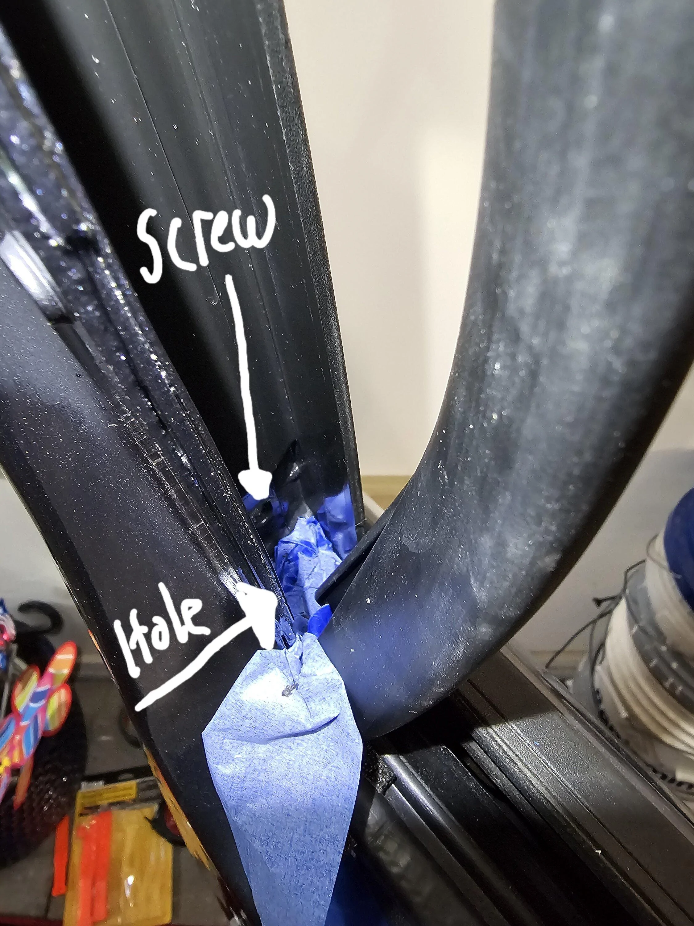

When you are removing the original trim piece on the door, the 4 screws are directly over a small channel on the window. Save yourself a possible headache and cover that opening with a ball of tape, or something. If not those screws can easily fall into that hole into the door (see picture)

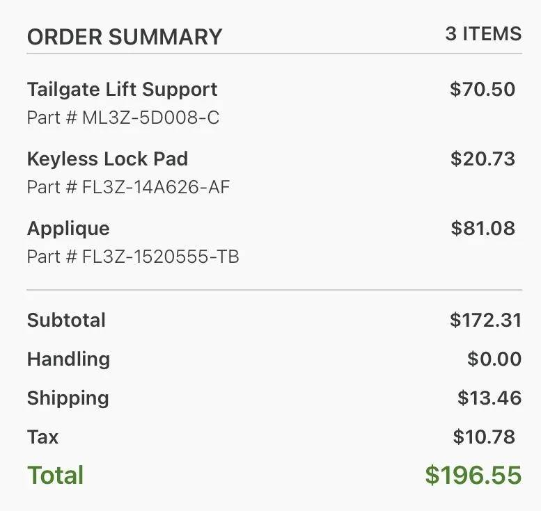

The harness and pre-cut was trim piece were ordered through Tasca per Kurt'sRPMGarage instructions.
Keypad: FL3Z-14A626-AG
Pre-cut trim piece: FL3Z-1520555-TC

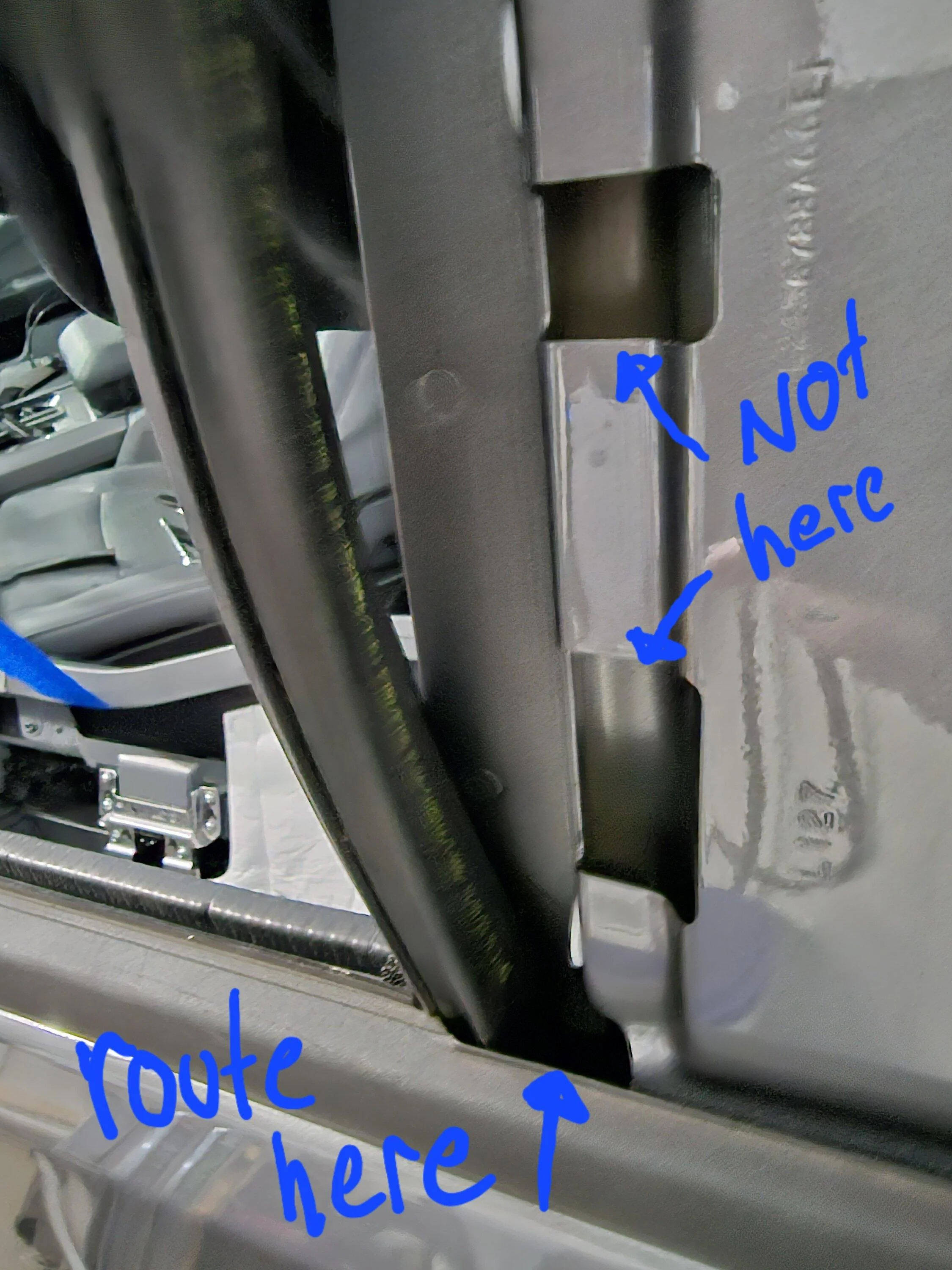

I was a little confused how the wiring harness routes into the door. There are 2 square holes under the trim piece on the door. Instead the wires run straight down (see picture)
Ford F-150 Lightning Adding SecuriCode to Pro? 20240108_103509

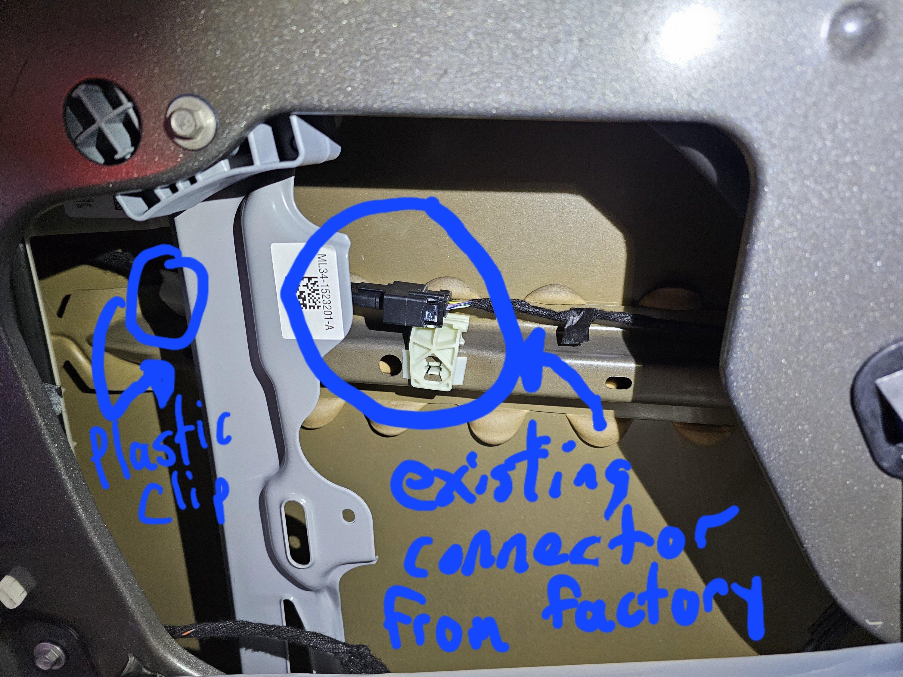

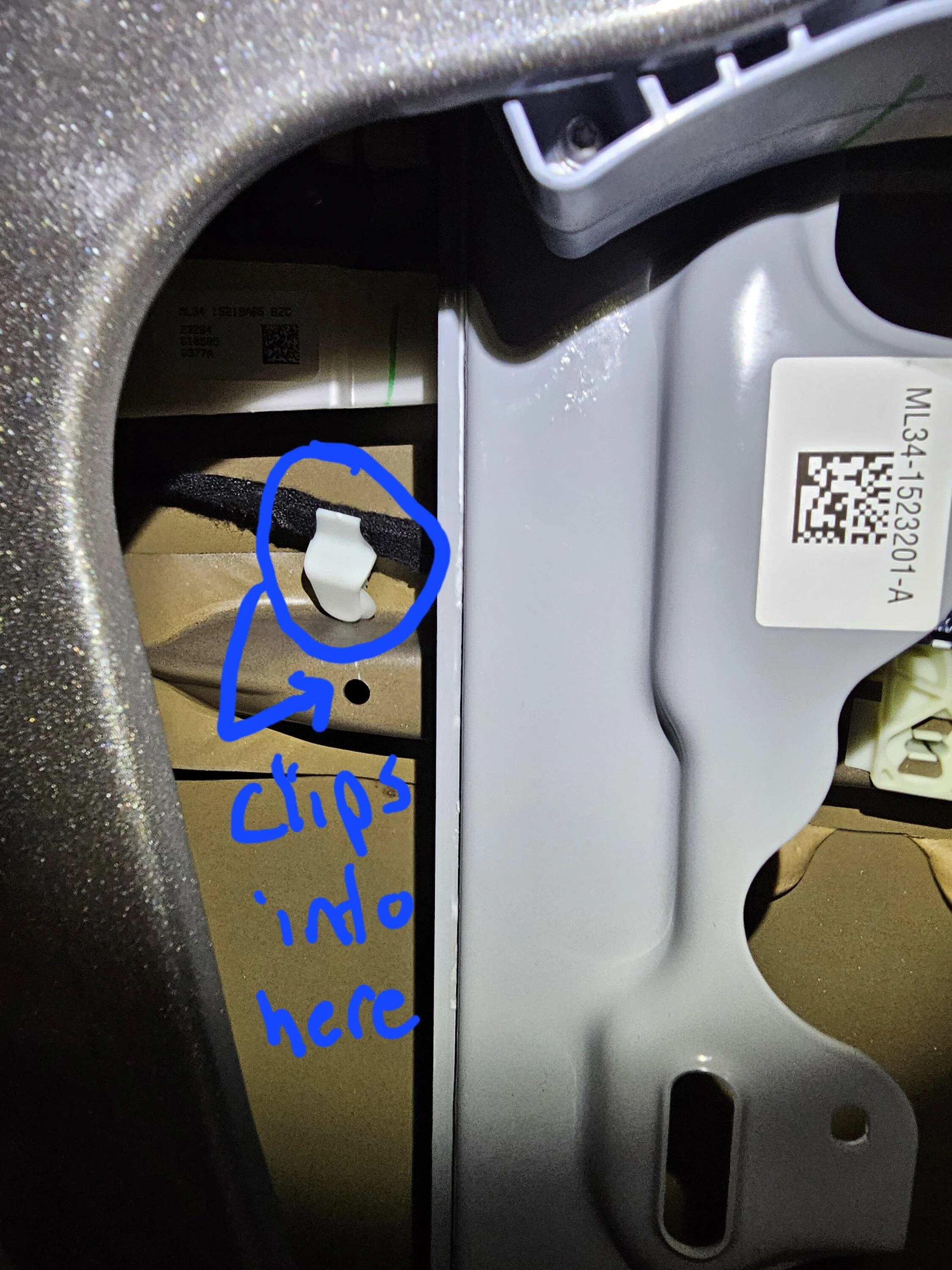

There are also 2 plastic clips/connectors that come preattached to the new wiring harness. One fits perfectly into a hole near the connector inside the door. (See picture). The other connector was not accessible and must be pushed in at the factory when the door isn't really put together yet. However it seems to be easily out of the way and doesn't catch on the window, or rattle at all.
Ford F-150 Lightning Adding SecuriCode to Pro? 20240108_105900
Ford F-150 Lightning Adding SecuriCode to Pro? 20240108_110152
