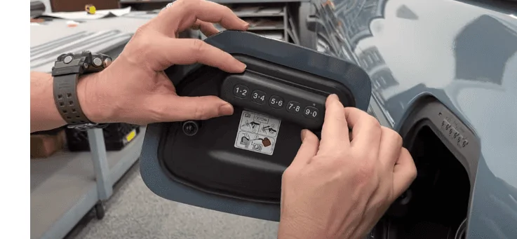

and I checked my charge port, and found that it most likely has PLENTY of room to 'hide' this keypad... and here's a photo of the video of someone doing this with a gas port, on a New BRONCO... moving it from it's original driver door location to the gas port.
Ford F-150 Lightning Adding SecuriCode to Pro? keypad in fuel charging door

I received my wireless KEYPAD, and it's very simple and will actually fit very easily within the Charge Port door... sweet. Now, either I pay $50 for the FDRS software license and do it myself, or I pay $100 to the local Ford Dealer... hmmmmmm.

ok.... FINALLY .... I have a SECURICODE Wireless KEYPAD mounted inside the CHARGE PORT DOOR on my PRO....and it works, AND I've created my own 5 - digit code....
I had to resort to having my local FORD dealer sell me the (A) Keypad version, which they keep in stock, and PAIR it with the truck/keyfobs.
It took them an hour... I think even they had problems with FDRS and getting it to finally pair, but eventually it did - it could also have been the FDRS software, which is a new system from Ford, and requires a robust WIFI internet connection - many Ford dealers don't have this in their bays.
So, in the end, I could not get FDRS to work on MY laptop, or to connect to my bluetooth OBD.
And, when I used a local SHOP, who said they had FDRS, they could also NOT get it to pair to the truck, which is when we also realized that the (B) version, which runs on a different wave length, was NOT the correct keypad. We don't really have REMOTE START, at least not on our keyfobs, which is what Ford requires with the (B) version.
The (A) version worked, at the FORD Dealer.
