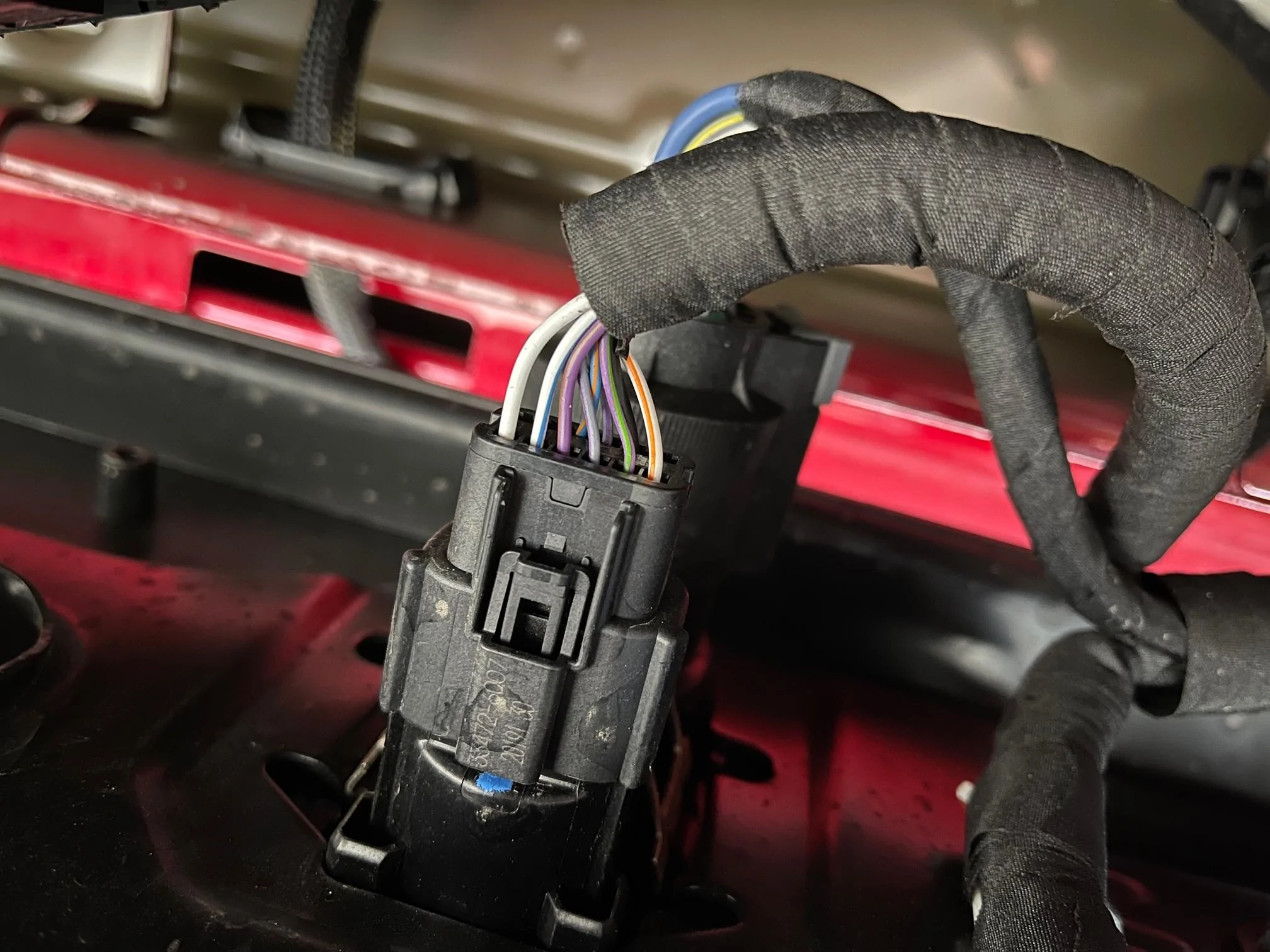

It sounds like your 2022 f150 will work with everything! Maybe I forgot to say, but the lack of wires initially (2 wires only) was what made me want to change the harness to see if I could get everything working in the first place. You can see my original harness showing two wires below vs how it looks now, sorry for the separate picture angle. I suspect that the f250 harness is the same with the addition of two more backup sensors (which anyone with a 21 build will see and want to tape off when they install new harness I used).GChurch, how many wires are in the F250 wiring harness you repurposed (ml3z-13a576-tfa)?
My 2022 F150 has 8 wires in the truck side of the plug (a change from the 2021 builds that only had 2 wires).
I'm trying to understand if my 2022 F150 will now support the Trailer Cam and Trailer TPMS AS IT WAS BUILT the way you made your 2021 F150 by having to replace the harness.
