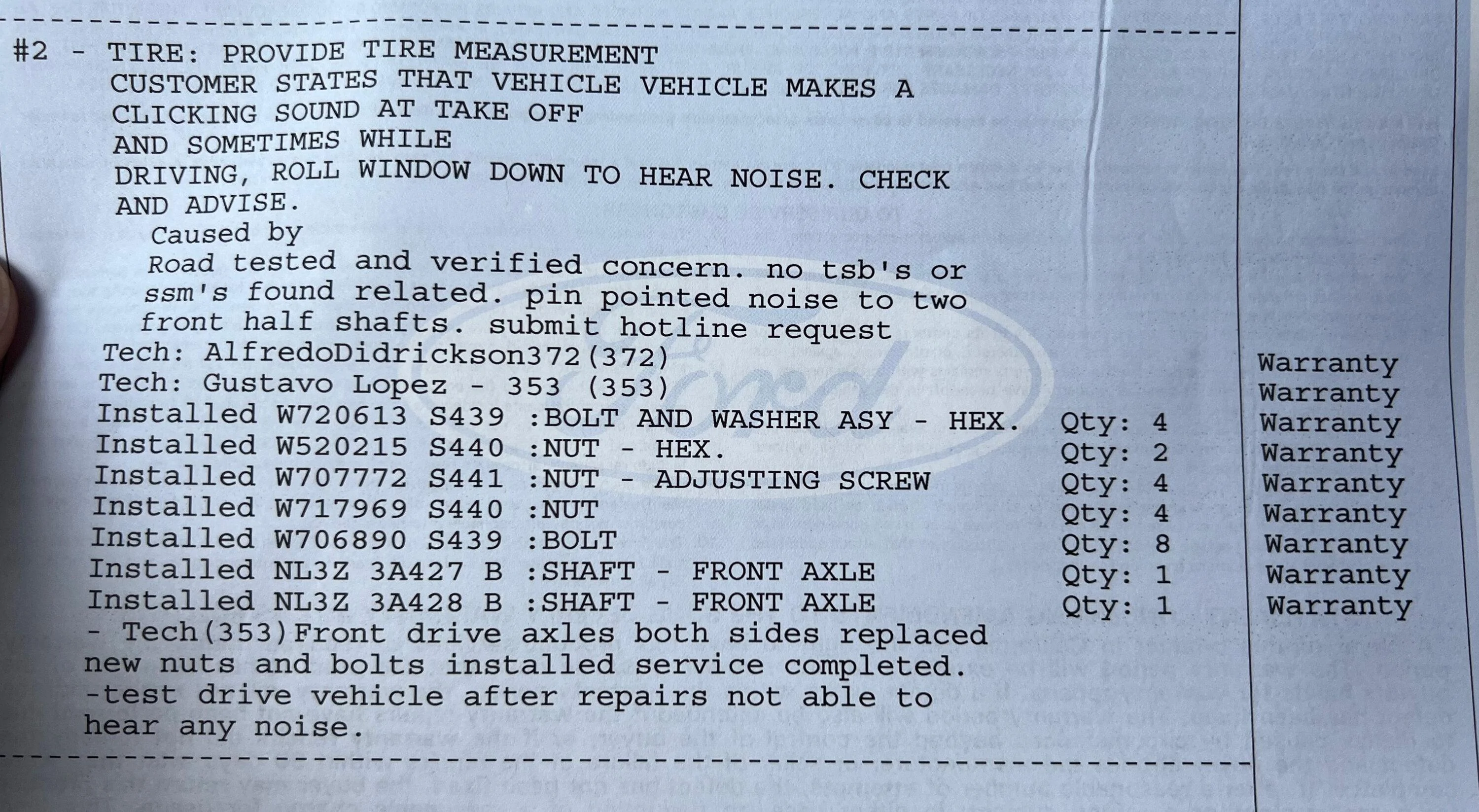

It took me about 3 weeks of complaining and having my car at the dealer numerous times but finally everything is good to go. Truck is quiet on starts and stops and all clicking noises are gone. I appreciate Ford and the mechanics at the dealer for being patient with me.

...there is a TSB on the way....I wonder if that's what they'll be doing?
Did they put the "chassis ears" on it to confirm it was just the front?

I have no idea. All I really know is what the work order said. Last week they torqued everything in the front to spec and the clicking went away but Ford told them to replace the front axles. All my clicking was in the front.
Okay thanks. Should be interesting to see what the TSB remedy will be.
