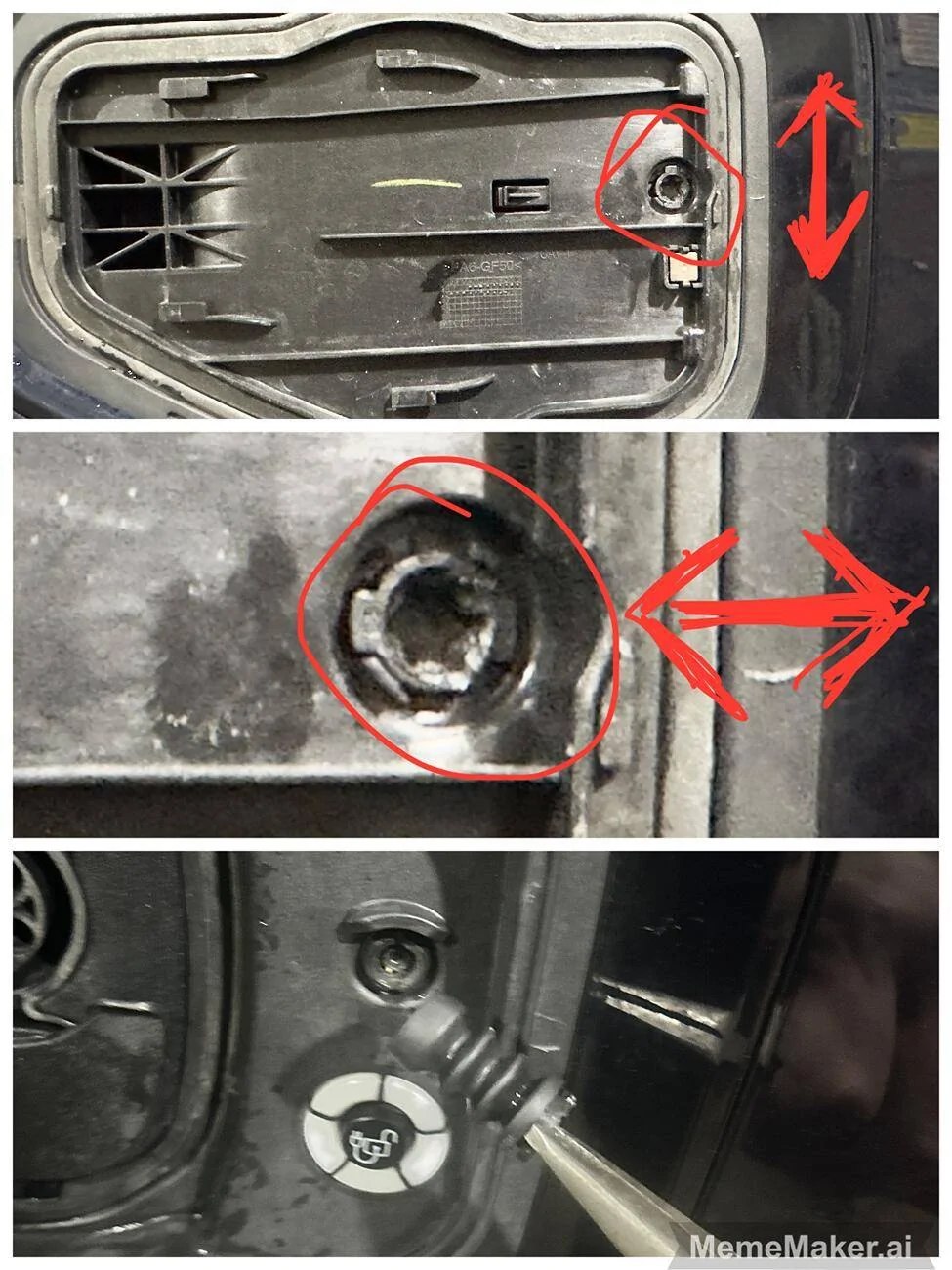

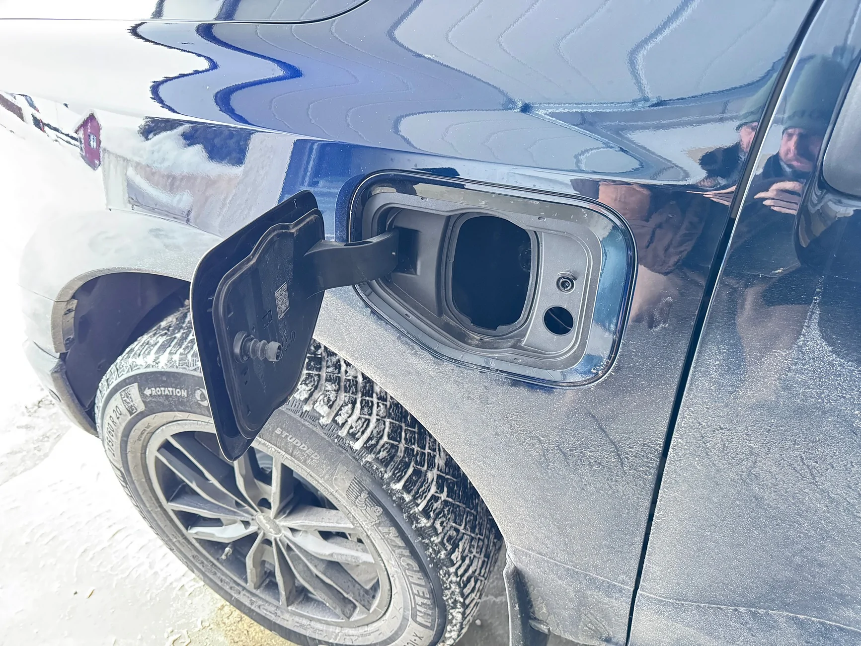

I just had this issue. I thought it was frozen. It definitely wasn’t. It’s a complete failure of the catch mechanism design.
It’s an amazing truck but this really is dumb as fv*k for design. It’s essentially a plastic catch that turns inside when you push into it. Once I got my port door open I was able to get the mechanism out with pliers by turning it quarter turn left and wiggling it. I would’ve preferred a simple key lock to open it. Ford - you done fv*ked up here with this latch design @Ford Motor Company
Here’s how I got mine open in an emergency. I created a photo in the hopes it helps somebody else.
  1. Purely by chance the face plate came off when I was trying to wiggle the mechanism. It’s designed to slide back on from right to left - So pry yours off by gently putting a flathead/butter knife in the top.
  2. Use needle nose pliers to turn the latch mechanism from pointing up and down so it was pointing left to right so the latch mimics the shape of the hole.
  3. Used the needle nose pliers to simply pull the door open now the catch wasn’t holding it closed.
