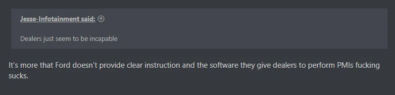

It’s more that Ford doesn’t provide clear instruction and the software they give dealers to perform PMIs fucking sucks.
Honestly.. it’s not that hard. It’s a lack of effort
both things can be true ;)
i don’t want to roast techs.. but honestly.. so many people on this forum have successfully done the updates on their own with no previous experience.. so that tells me it’s a lack of effort
