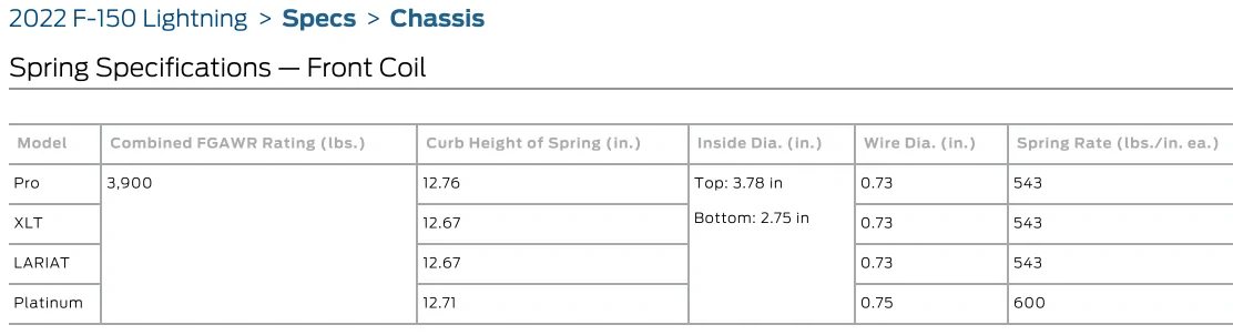

For those that ordered the Bilstein 6112s, which drivetrain option did you select at checkout? I'm wondering if there are different spring specs based on the different drivetrains.
I just ordered off shocksurplus.com and selected 4wd with the Powerboost. My reasoning based on that being the heaviest drivetrain, and closest to the weight of the lightning.

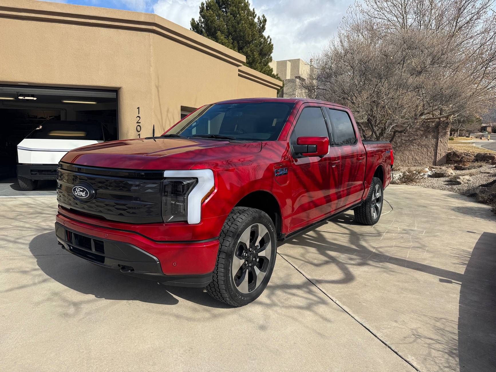

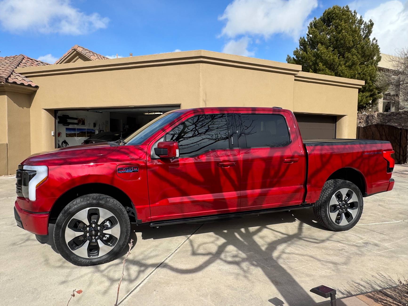

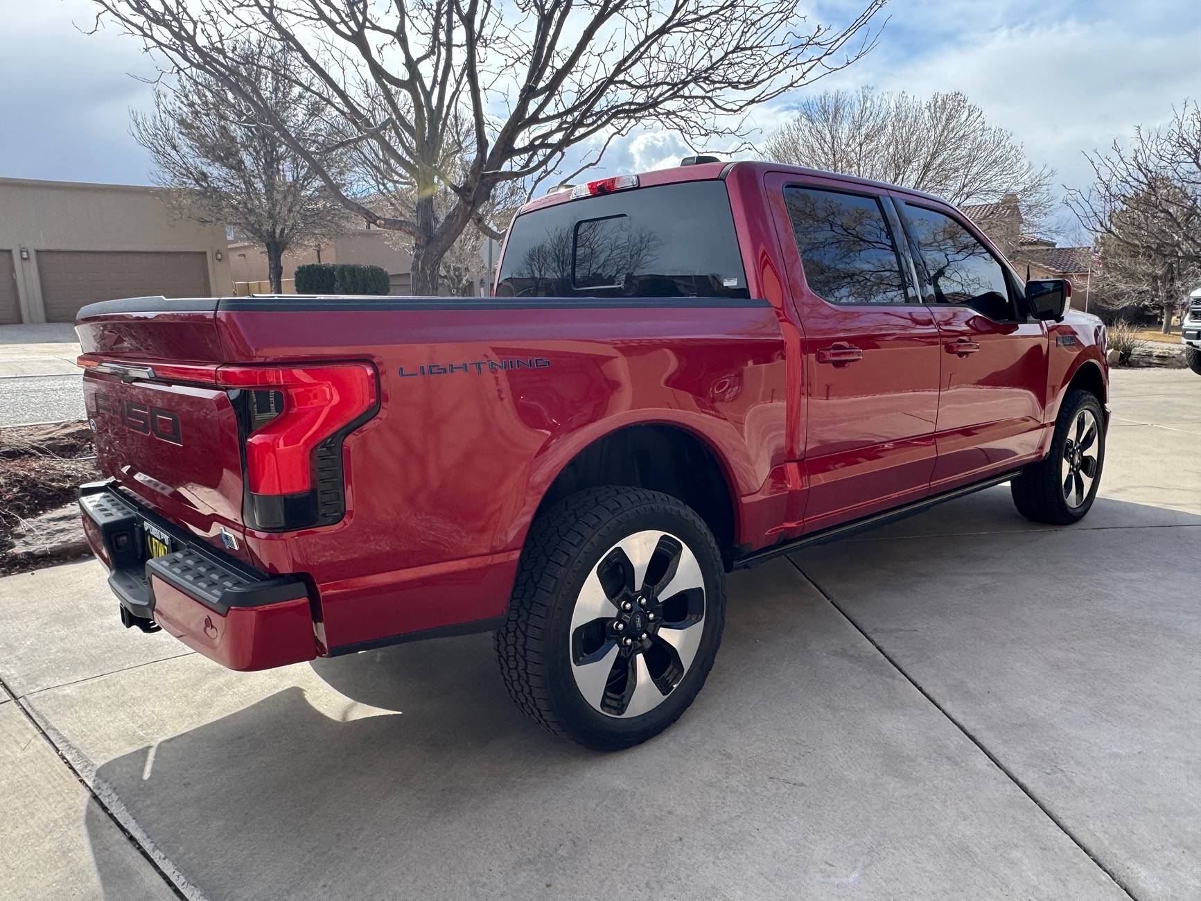

I just had the 6112’s installed. Not sure which drivetrain, but the Bilstein’s run a little nicer up front now. It didn’t quite level me, but it’s less rake for sure.
Ford F-150 Lightning Bilstein 6112 Leveling Kit Installed - Specs, Impressions & Photos IMG_3936
Ford F-150 Lightning Bilstein 6112 Leveling Kit Installed - Specs, Impressions & Photos IMG_3938
Ford F-150 Lightning Bilstein 6112 Leveling Kit Installed - Specs, Impressions & Photos IMG_3935
