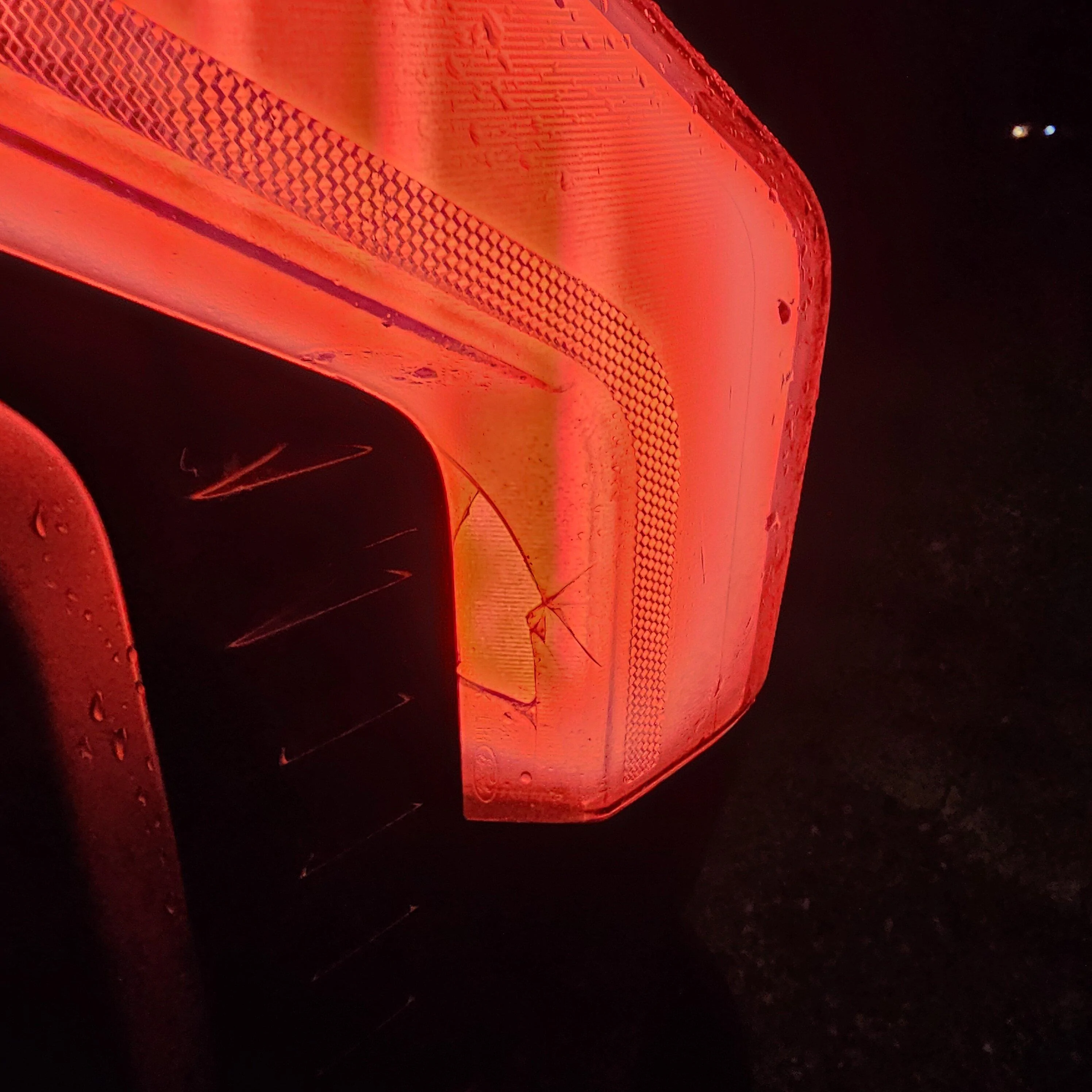

I have the same exact issue.
Taillight cracked, water in the light ruined the sensor and getting continuous notifications on my screen.
did you get this resolved or y ou still have issue?

I have a similar issue. Had a rock go through the tail light, which promptly filled up with water and now reports the cross traffic and blind spot sensor issue. I replaced the cover for $1400 and tried to transfer the module but I'm still getting the same error. Has anyone had success replacing the module? Are they prone to water damage?

Module has to be programmed. It’s not just plug and play.
