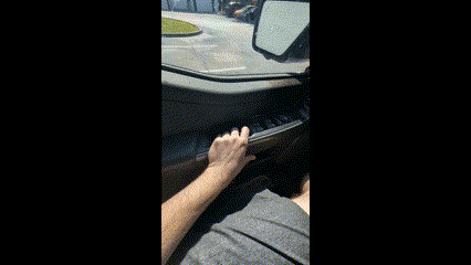

Video: Here is a quick, poorly shot video (turned gif) showing the issue. During this clip the touchscreen displayed 93F.
The panning back and forth is to show that the door is 100% closed yet the Instrument cluster still indicates the driver door ajar.

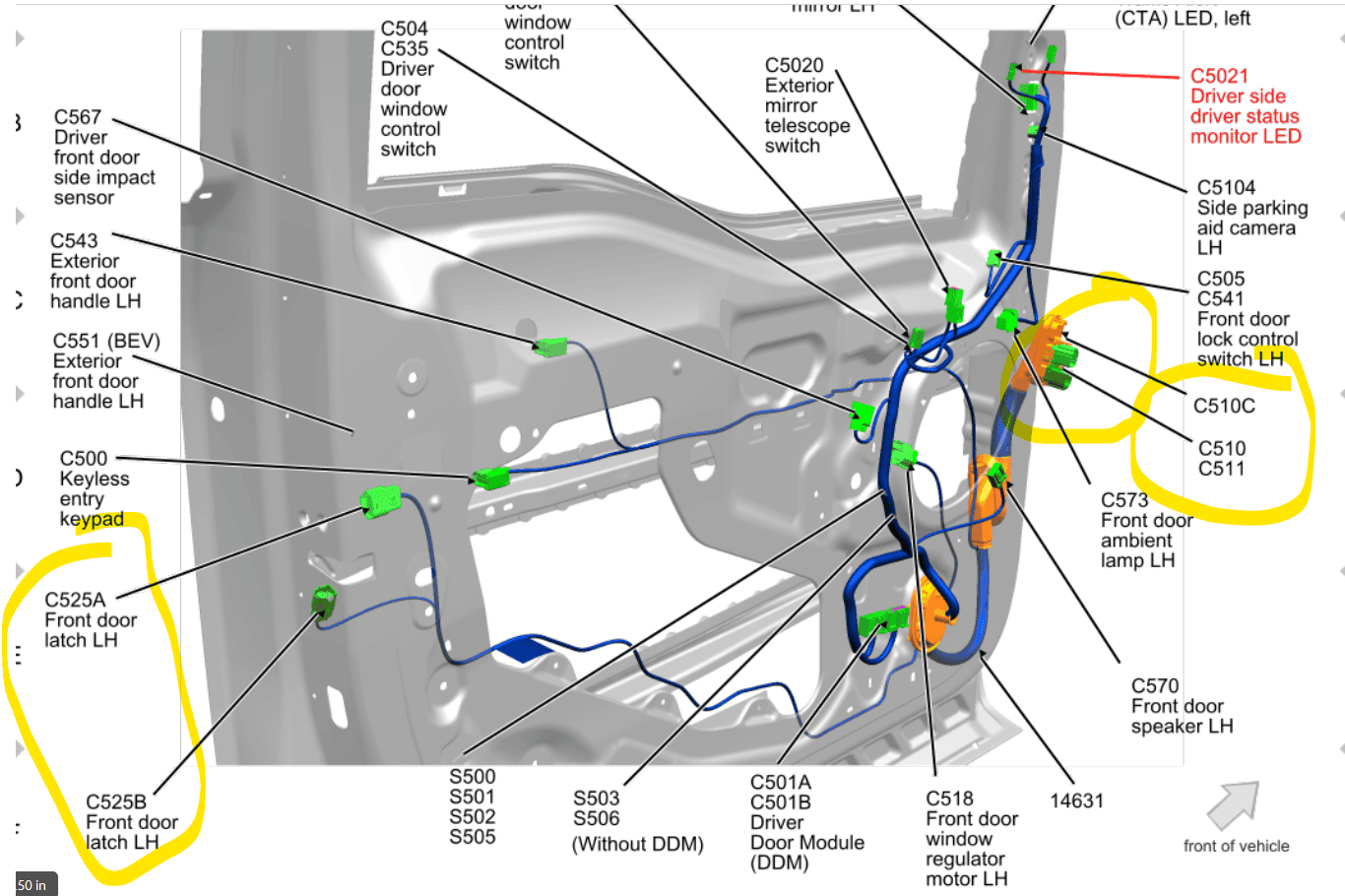

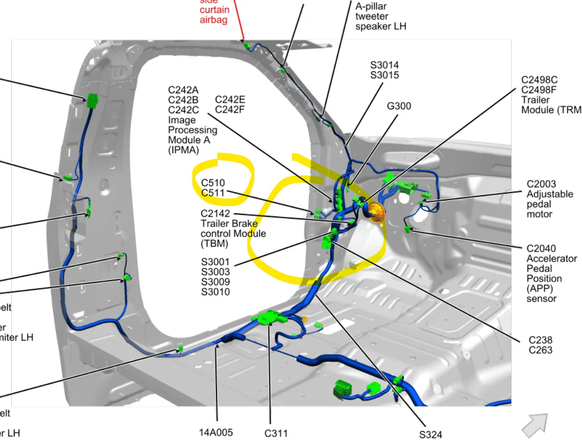

Poor connections of the harness between the drivers door and body????
I vaguely recall someone having other issues unrelated to your situation but tied to the harness, have the technicians look into that!
4,167
5,523
Yep - I seem to remember that the connector in the door wiring harness wasn’t seated fully.

If the other ideas don’t work Maybe try taking a better video and showing it to the dealer??
Dealer has this video in full quality, along with 3 other videos that are longer and demonstrate the various issues.
I just grabbed this quick one for this post - then compressed the hell out of it turning it into a gif for easy posting. Compressing it like that also has the added benefit of assisting in making it slightly more private.
