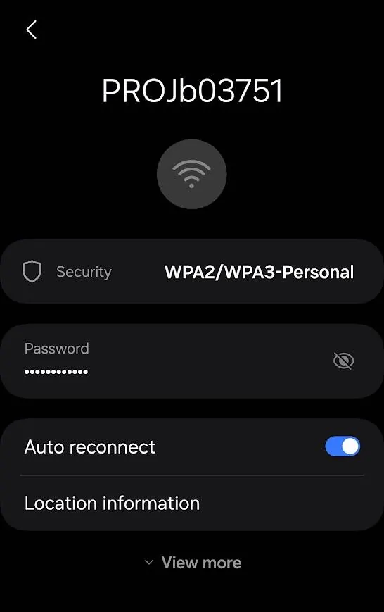

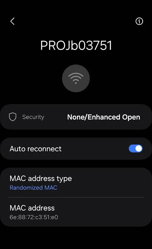

I'm not familiar with iOS, but in android, I can go into advanced wifi settings, to [Manage Networks] find the SSID for the truck wifi projection, make sure the auto reconnect is turned on.
Note that if you're in proximity to multiple auto reconnect networks, competition may overrule desired results.
I've disable automatic reconnect to my home wifi router on my mobile device, doing this improves initialization when I start my day from the house, negative impact is that I need to manually enable home wifi when I'm done dealing with the truck. This routine has improved reliable connections, but still subject to occasion disconnects

BTW, bluetooth perse is for basic communications, wifi connections is how your phone projects advanced application functionality
There's really no need to do this on Android (Auto) since it'll force-connect itself as long as you are connected to either bluetooth or WiFi, i.e. if it's connected to BT it'll turn on WiFi (even if it's off) and connect to the WiFi and vise versa.
It's really, really, really annoying the times when you do want to connect to a different WiFi network while in the truck.
In the summer / fall of 2022 they had not yet been "IMPROVED" the flakey process, so my methodology continues even if it's 'unnecessary' in 2025.
