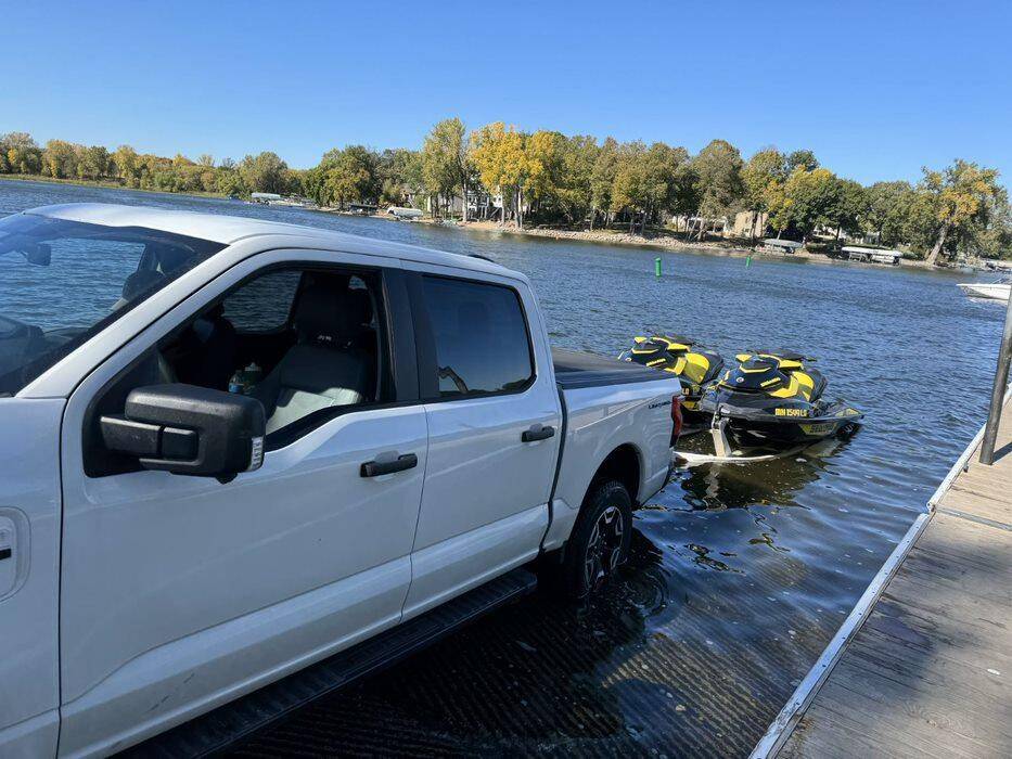

Sad time of the year here in MN when its a little too cool to enjoy the Seadoos any longer.
Hauling them out with the f150 Lightning is light work. Even with the super short tongue on my trailer, only need to back the truck about 1/3 of the way up to the hubs to get these smaller boats onto a bunk trailer.
