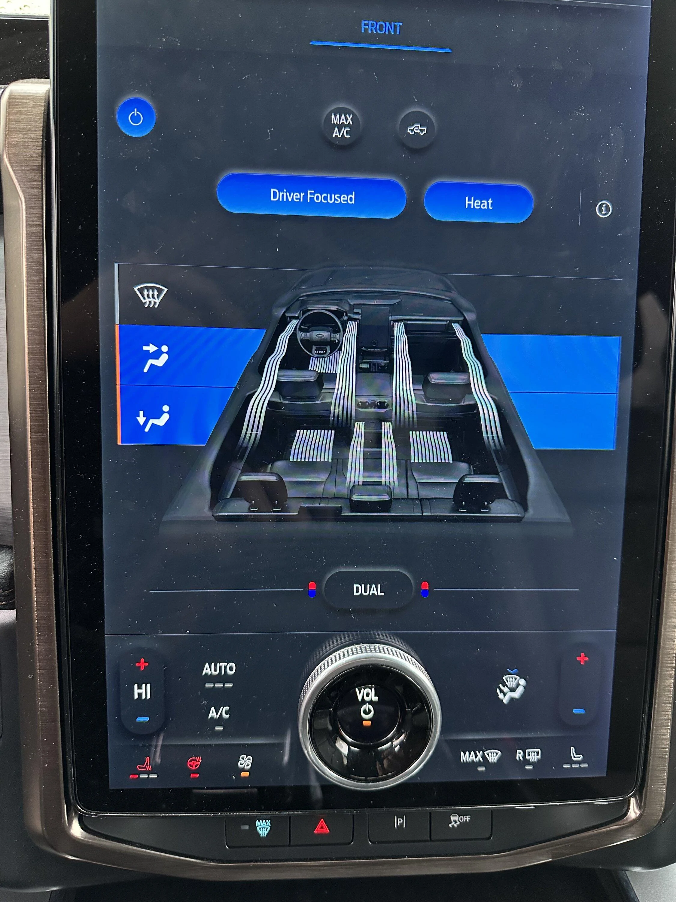

I suspect that the cabin temperature sensor might be faulty as a result.
Try adjusting it manually. If you crank it to HI and adjust the flow it should take it off auto and bypass the sensors. It may not be a solution but it'll help narrow if it starts putting out heat.
Try to make it look like this if you have the 15" screen (Not sure which SR you have..):
Ford F-150 Lightning Cabin Heater blows cold air IMG_4703
I had tried that as well. Still no luck.
Thanks for the suggestion!
I’ll add it to my profile, but it’s an xlt 12”
