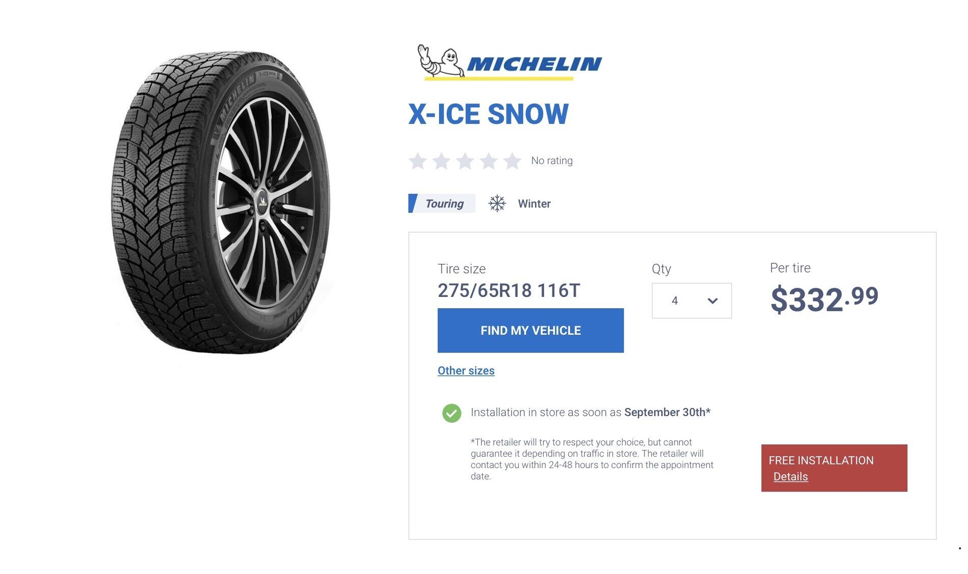

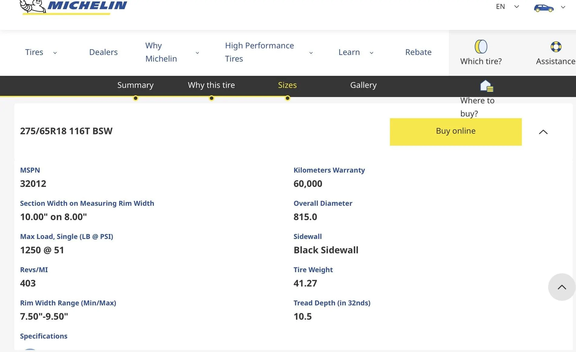

I don’t see why not. My PB only has a 1320 payload rating , no max tow though, and this is what I put on for the winter snow tires. At 1250 a tire that should be fine. There is a decrease in the speed rating of 3 km per hour though.
In Ontario as well. The ride is pretty good, not really much different from the 20 inch tires. I couldn’t find any in the 265/70/18 size.
