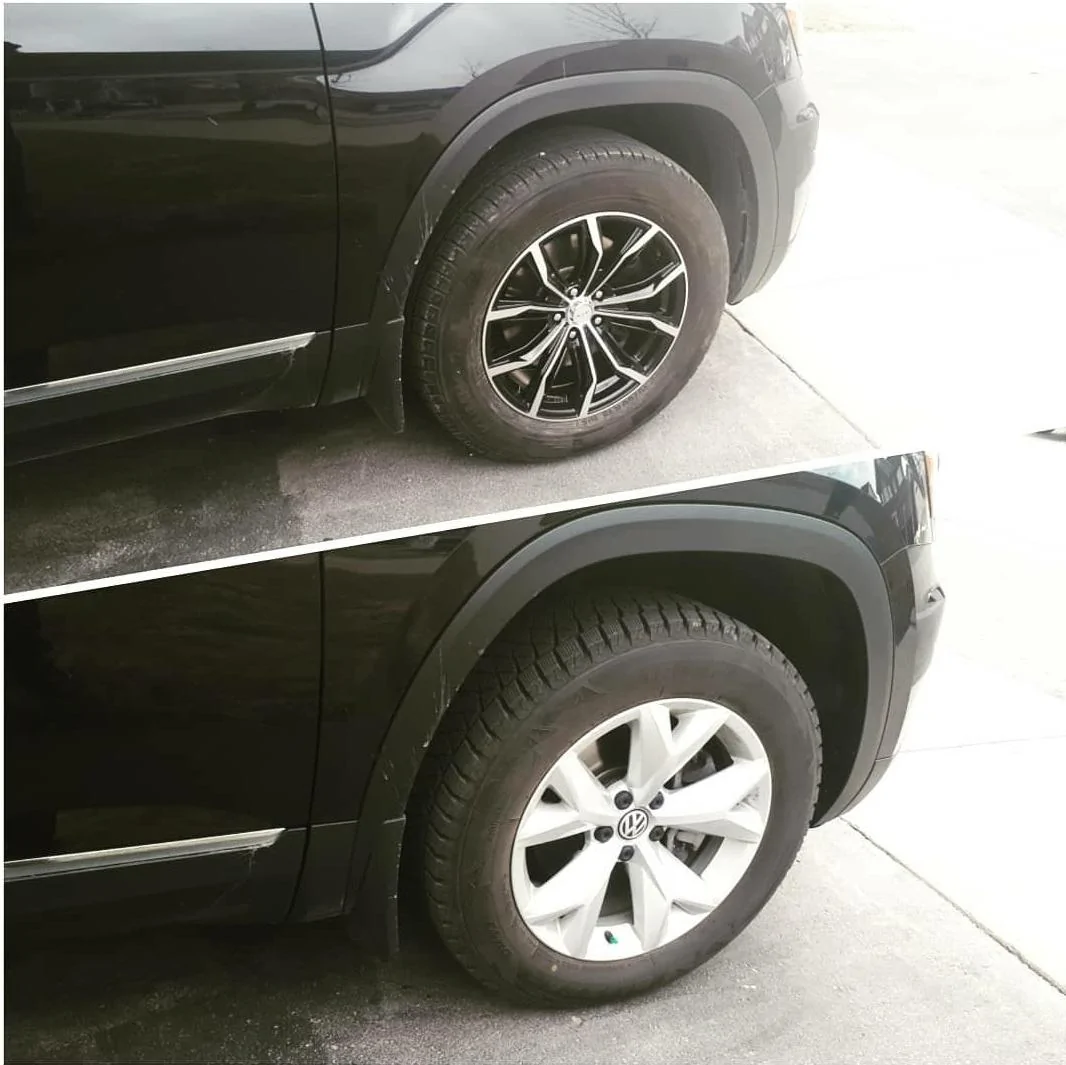

Maybe I wrote that wrong. ? Wheels will be used for winters. Tires will be kept for summer and put on new wheels. Wife had RTX black widow on her Atlas, but tire shop does not think they will come with the same rating.
Here is our old summer and winter setup. Blizzak dm-v2 were awesome winter tires on the Atlas.
