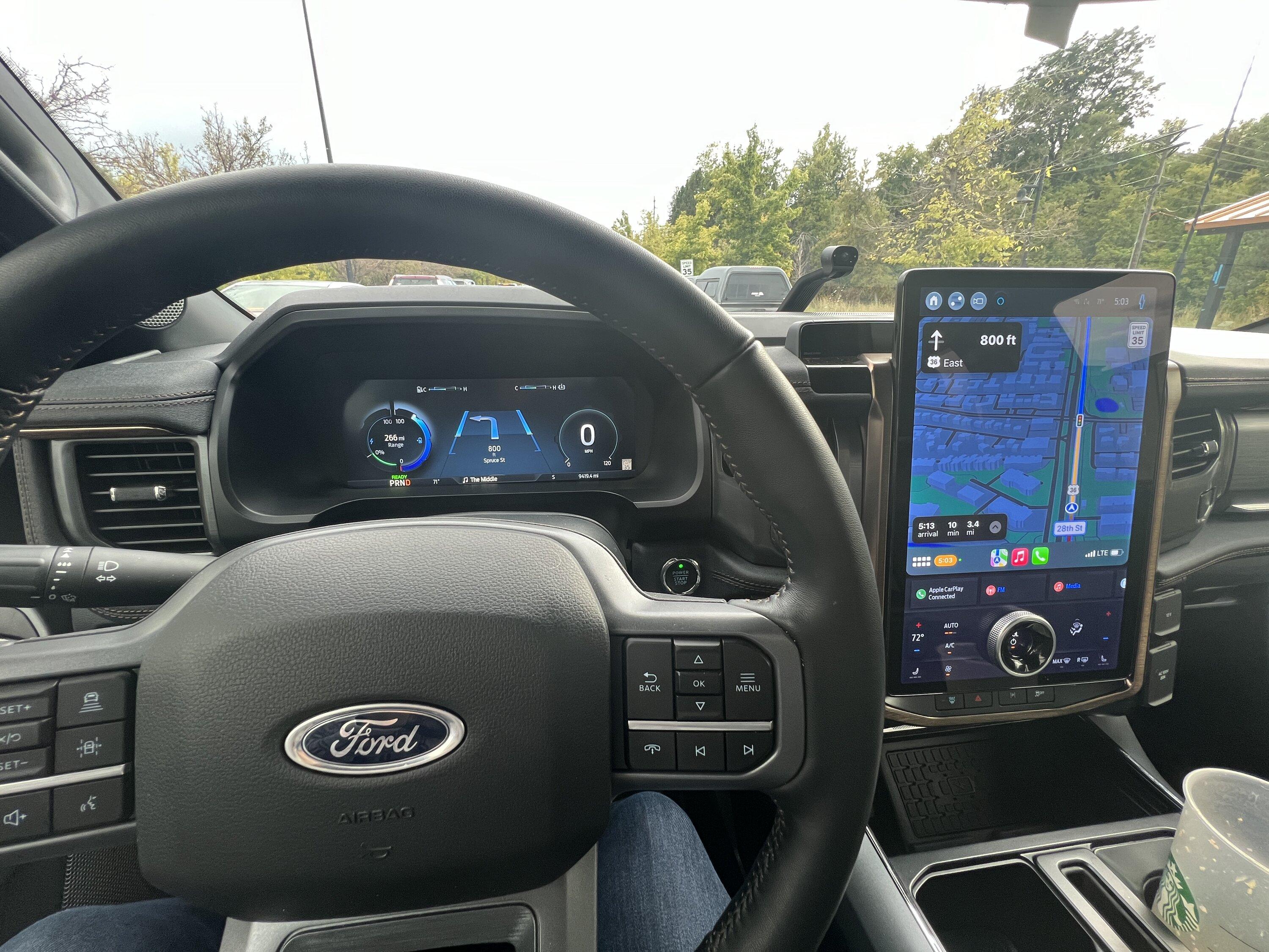

I had this issue for a few weeks last year when I was a few OTA updates back. Apple Maps displayed correctly but the turn directions shown on the driver display was one step/direction behind what Apple Maps was showing. What OTA was your last one, and what iOS version are you on now? Picture was from 9/19/23. You’ll notice different directions between screens.

Which mode (setting) gives you the turn-by-turn in the main dash? I've not tried AppleMaps (I've been a Waze junkie for a long time). With Waze, I don't get the turn-by-turn in the main dash (so I have to get those instructions on my phone.) Or maybe I just don't have my settings properly set (hence my original question.) Thanks!
sfringer
Scott
Nov 13, 2023
146
228
NC
Turn on the Driver Assistance view.
